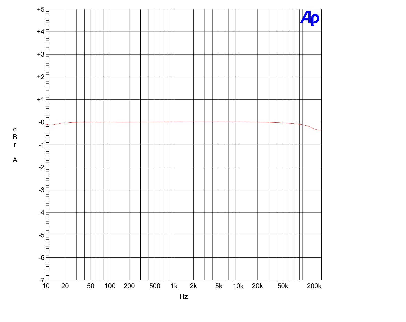

the use of a ss amp is due the very low Zou that they normally have.
In some case it vaires from 50 to 100 mohm; the other thing is the frequency answer where we can see also if the Zout of the ss amp is resisite or reactive.
In attach the test of the one I use ( I am working on it to get a better THD vs Freq.), 8 watt on 8 ohm.
It is flat from 10 to 200 kHz.
With this spec when you connect the resistor in series to ss amp pratically the generator is perfectly resisitive; also when you close the primary with a resistor with a value almost similar to Rp of the tube involed you complete a perfect test set of the OT trafo
So the results are related to it.
If you have a OT with a ratio of 30, and you have a test signal of 8w / 8ohm means that on primary you will have 240 Vrms!
With a standard measurement wich generator can delivery this swing with the same Zout?
The values are theorical because some loss are found but they are real.
Walter

A good generator can delivery around 20 V rms.
I have two AP, the max Vout is 12 volt balanced. Zout 20 and 600 ohm
I have also R&S Apn 62 that reach 20 volts with Zout variable from 10 ohms to 2 kohms, beautiful
Plus HP 339A
This is a limit.
A simple trafo for 300B has around 25-27 as ratio.
With 20 volt on primary what do you think you see ?
In my opinion the most important test is not the frequency answer, less or more now the OT, normally, are decent stuff.
Also for resonance, now it is difficult to find a prrible trafo.
For me the most important test is the THD vs Frequency at all level until the max declared.
Looking at the shape of the test it is possible to understand the real quality of OT
First for the iron then for the topology of coils ( parasitic)
And setting the test set is not so complicated!
Walter

And do you think this is more easy?
As told before in other post I will prepare a test set up with the possibility ot inject the bias current to show what happen in a s.e.
Then, you can test the OT trafo as you want.
But is not the complete and exaustive test.
Due the fact that thousand of posts are wrote about the quality of trafo and in which way someone can understand the quality ot them I am surprise about the comment on the procedure I described
Test it before give a sentence.
Maybe you will falling in love!
Walter

But after the words I suppose that a test results of the theory that trobbins and other have wrote would be publishd with the same level of test set and accuracy I sent.
Otherwise remain words.
I have done the test from primary with different amps; in Audioreview lab there is one amp used for the tests on loudspeaker that can deliver 600+600 watt rms ( is a Rotel, not remember the type), and can be configured bridge.
But the use of a good ss amp, that can deliver 20 volt rms on 8 ohm ( as minimum) with large freq. response and low THD vs. frequency is much better for the use as driver of the secondary.
With less stress and better results.
Walter

No, you are playing.
I wrote that the level are different and the results are comparable due the same face of response.
Also, You said that is not necessary to get a high voltage to understand the trafo
And the comparision I made is enough to understand that the method to drive the secondary if fine.
Another thing, I am always waiting your answer about my question if a trafo is a bi-directional device.
Last, if you are not agree please demonstrate with test lab that my method is wrong and please show the right way.
Walter
