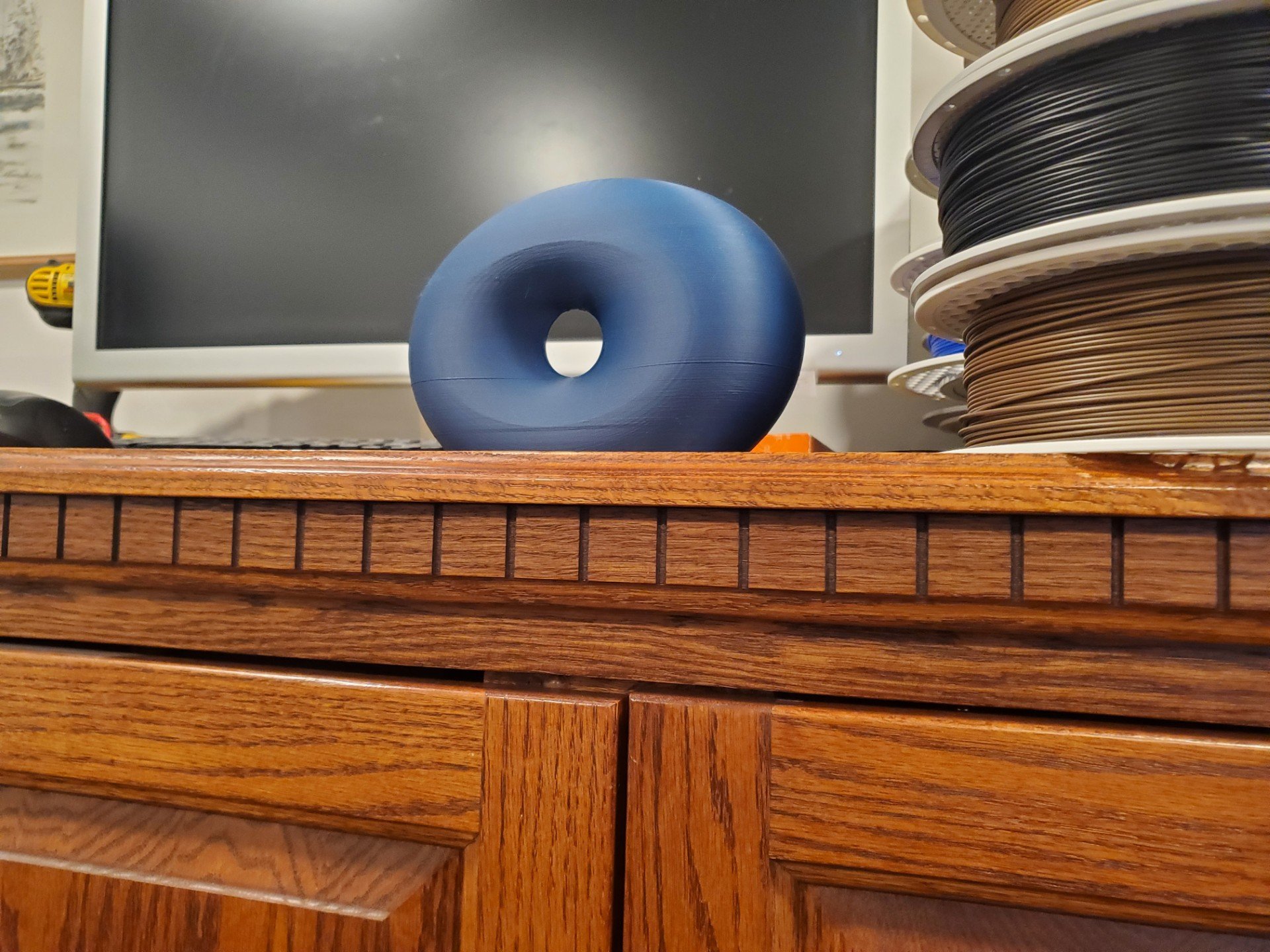

I made SB21 5" into a one piece donut to mount on midrange for a 3way.
Printed one to see how it measures first.
