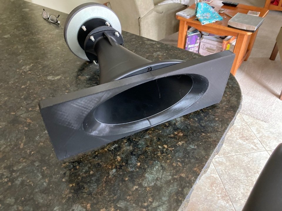

How about a hybrid approach? I'm working on a horn/driver combo to replace the K400/K55V in the Klipschorn. This is the PRV WGP26-50 horn. I 3D printed a mouth extension to match the K400 opening and also flares out the horn. The massive driver is the Celestion CDX14-3030. It has a 1.4" exit so I also printed a 1.4" to 2" adapter.

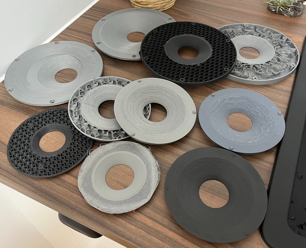

It ran out of filament 95% through the print, and when I changed it failed to pull it through. Will try again soon.Thanks @fluid I'm actually printing now standing up with the organic supports. I'll see how it goes. 2hrs into an 9.5hr print, watching anxiously on the video monitor.
Dissappointing but it happens. If it makes you feel any better here is a small selection of my own failed prints for one reason or another....It ran out of filament 95% through the print, and when I changed it failed to pull it through. Will try again soon.

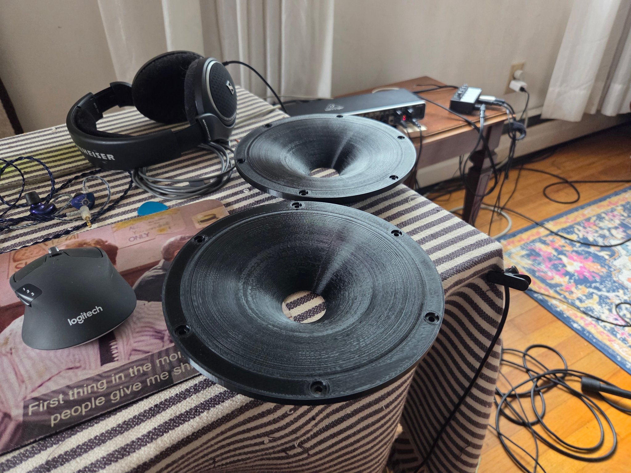

Got mine from a friend, look pretty rough and need lots of surface prep work and painted. Some of the screw mounting holes don't look like they have much filament keeping them there. Not sure how they'd handle screw pressure. I think my friend said it was 20% gyroid infill. I always request 100% but he mentioned his research suggesting much lower infill.

It will be fine since there is "wall" where the screw is. I have also done mine with 15 or 20 gyroid. 100% would takemuch more time to print. It increase cost but also risk of failure ... Maybe I would do it for a final version when I know that every thing is fine.. Not for a proto. With Gyroid, you can also make some holes behind on top and fill with epoxy using a syringe ...Not sure how they'd handle screw pressure. I think my friend said it was 20% gyroid infill. I always request 100% but he mentioned his research suggesting much lower infill.

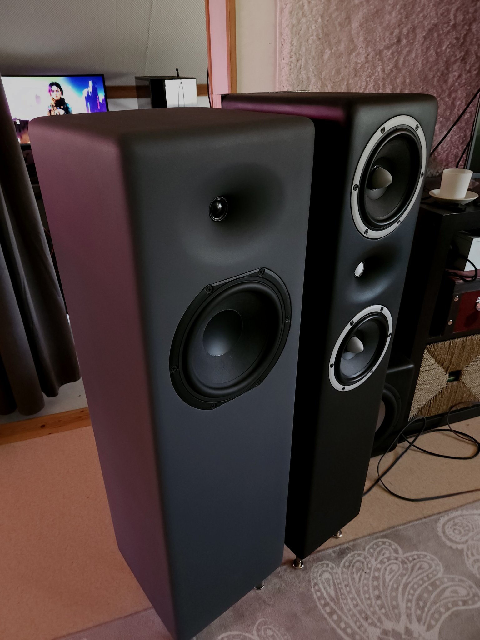

My builds with 8 and 6.5" augerpro waveguides.
