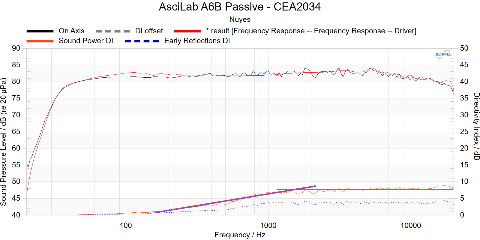

A similar speaker to my smaller woofer combo would be the ascii labs c5b, it appears to use a waveguide larger than the woofer. Worth considering the low xover point and different waveguide.
https://www.audiosciencereview.com/forum/index.php?threads/ascilab-c5b-review.58753/
The ascii speaker linked shows exactly what a waveguide bigger than the driver does. The DI is held as high as possible for as low as possible before it then drops as the woofer becomes less directional. There will be a natural frequency between the woofer in the box and tweeter in the waveguide where this can work. The way they have tuned the speaker is to have a flatish on axis, which above the crossover results in flat output across a lot of angles due to the flat DI. The woofer cannot match this naturally so there is a bend up in the off axis responses as the DI begins to lower. I don't see a predicted in room in the link but it would be very much like the early reflections curve and similar to KEF's R3, downsloping then flattening out as the waveguide DI flattens. If this is what you want in the design or fits your preference in sound then that is how to get it.

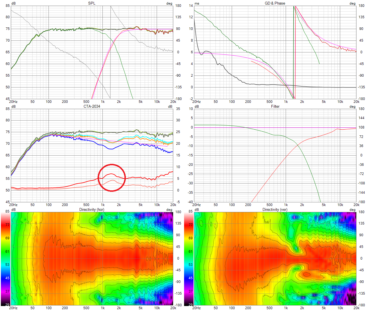

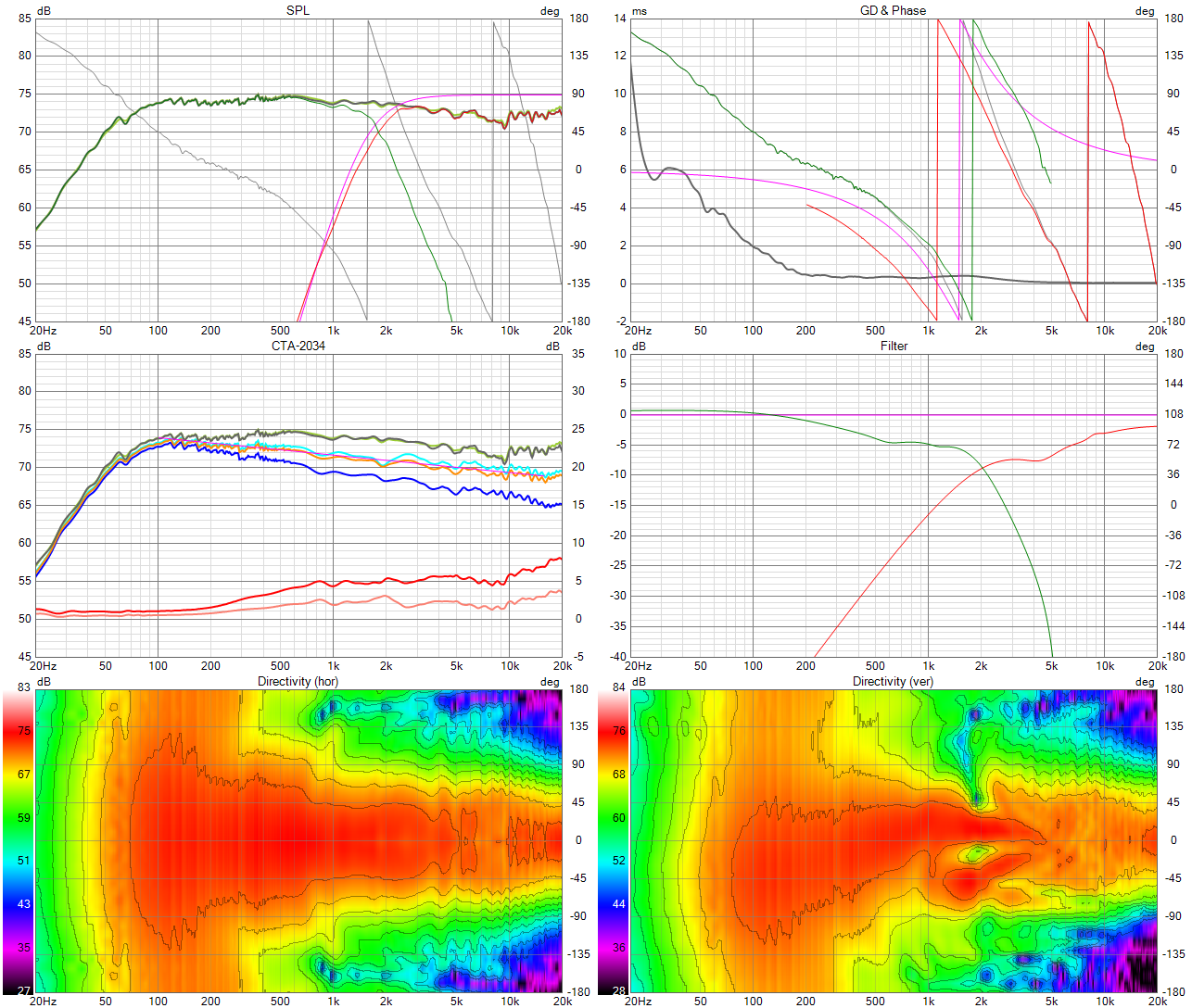

If you do not pick the right crossover frequency and use a typical in phase LR4 crossover the DI of the woofer and waveguide will combine to produce a bump in the DI at the crossover frequency with a corresponding dip in the power response.

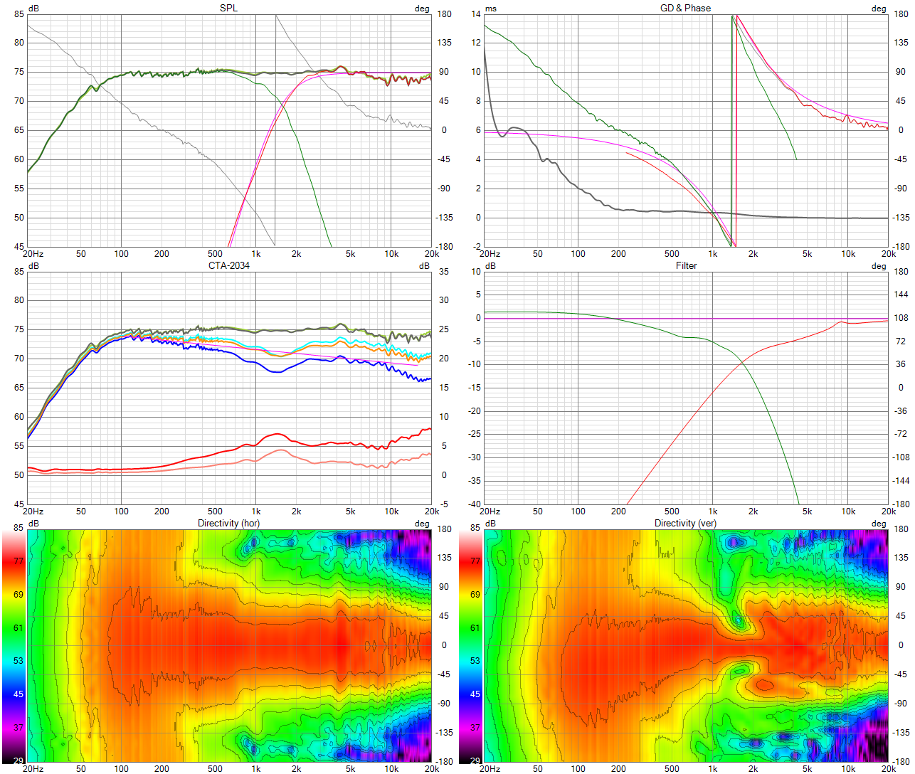

I have attached two crossover versions of the same speaker. This is a speaker that has the waveguide the same size as the woofer, my own version of something similar to Purifi's SPK16. The one with the bump in DI at 1500Hz uses an in phase LR4 at 1500Hz, the one without the bump has a 2K crossover that doesn't quite conform to any partiular named slope. The one with the bump is obviously not good but is a demonstration of what not to do when both drivers have the same DI at the crossover point.
I chose in this version to slope the on axis down to get a smoothly falling in room response. If I made the on axis flat it would be like the ascii lab as they both have flat DI waveguides. This is a choice and whether one is better than the other is down to the preference of the listener for their use case.
The goal is to obviously pick the right xover frequency...

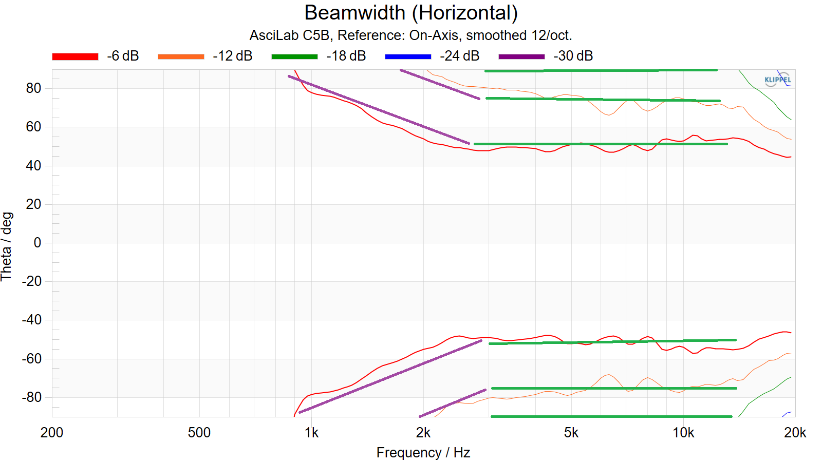

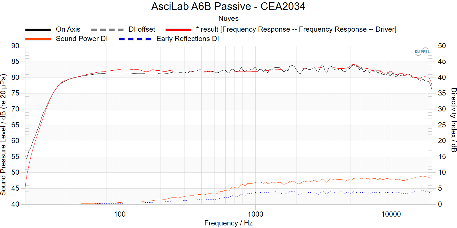

I'm not seeing how the ascii lab shows any similarities to your sims. The DI is on the fourth graph and doesn't at all resembled the DI narrowing in your sim. If this is the bump you're describing I'm not seeing it on the ascii lab.

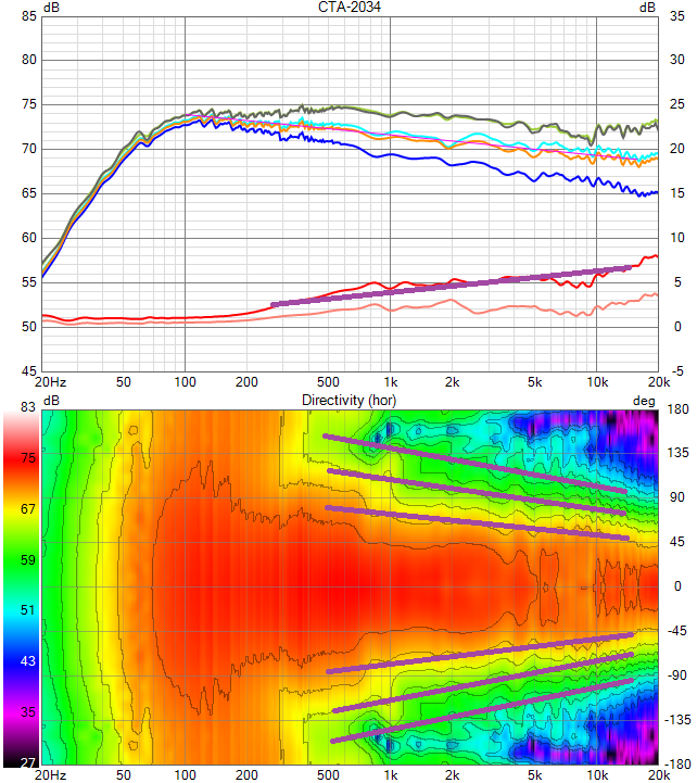

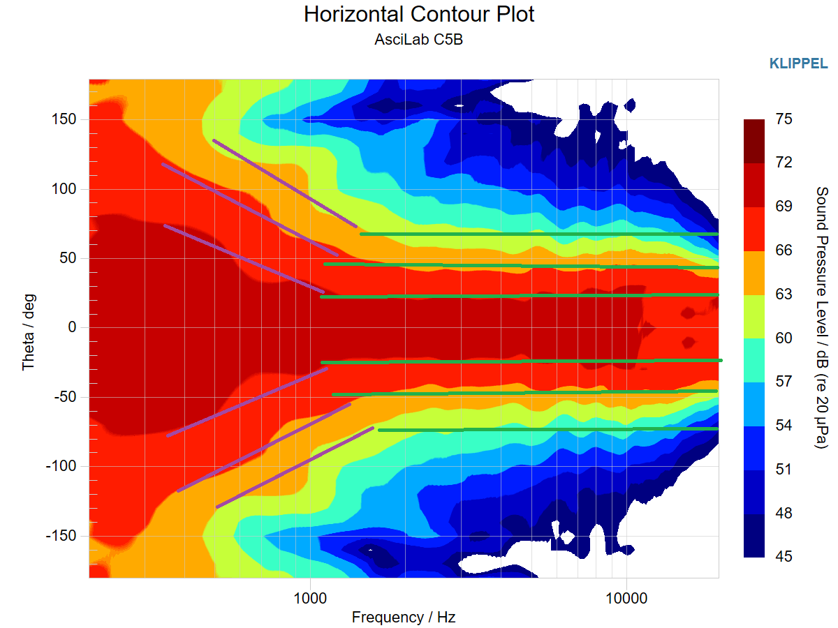

Fluid, not quoting you to get your attention, just to break down your statements and match up to the graphs (to what I think you are saying).
Note directivity mismatch around 1kHz (crossover point is ~1kHz)
...The way they have tuned the speaker is to have a flattish on axis, which above the crossover results in flat output across a lot of angles due to the flat DI. The woofer cannot match this naturally so there is a bend up in the off axis responses as the DI begins to lower. ...If this is what you want in the design or fits your preference in sound then that is how to get it.
If you would prefer a smoothly rising DI so that the in room and power is a smooth downslope with no bends or bumps then you need to blend the directivities of the woofer and tweeter and the tweeter waveguide needs to have a rising directivity that matches with the upward rise of the woofer.

Looking at some of my favorite speakers like behringer 2030p or genelec 8030c, this is how they perform I believe. The Behringer is still my favorite sounding tweeter,
I wanted to find a review of the Behringer to see the measurements and found a quote from someone in 2021 (active version) "the Behringer 2030 is the widest active monitor I know about, and it certainly sounds that way. With a bit of EQ and a sub it's probably one of my favorite speakers."
And the measurements look very similar to the Ascilab speaker, so I would expect you'd like the Ascilab or things similar.
