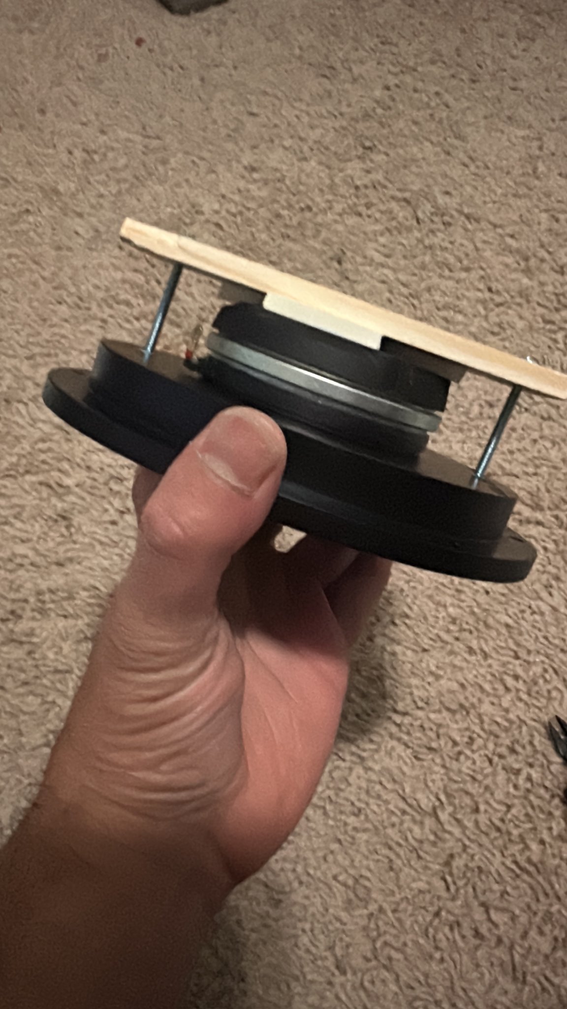

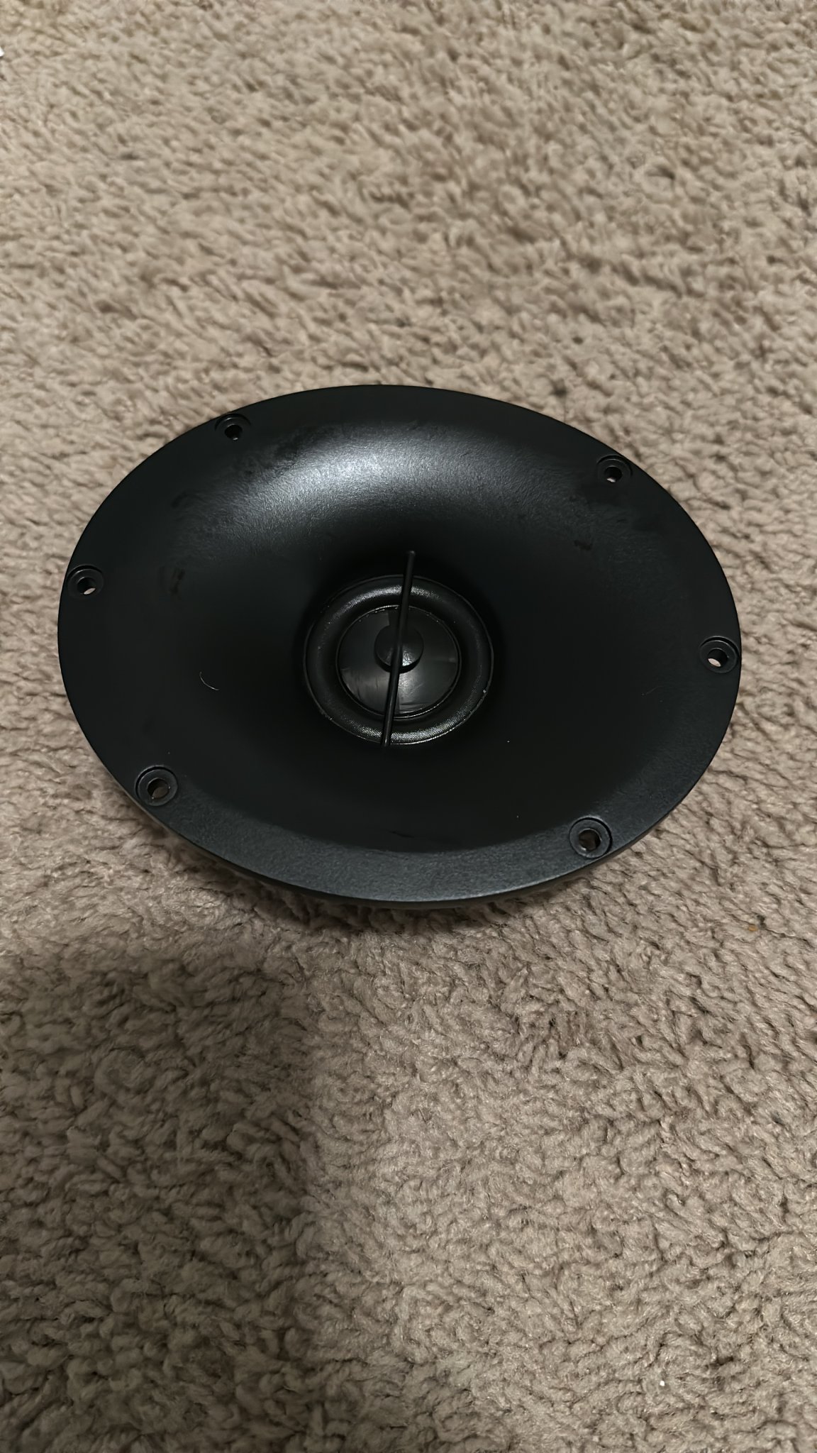

The layer lines are very noticeable on the elliptical waveguide towards the wider ends when printed face up, and there is a seam where the head moves up to the next higher layer.
when printed vertically both of the issues are non-existent

Bambu A1Wow - what printer do you use? Which material?
This looks WAY better as everything I produced.
The filament was Bambu PLA basic black
0.4mm nozzle? or 0.2mm?Bambu A1
Printed with 0.4mm nozzle and I set layer height to 0.12mm HIGH QUALITY @BBL A1 instead of standard 0.2mm

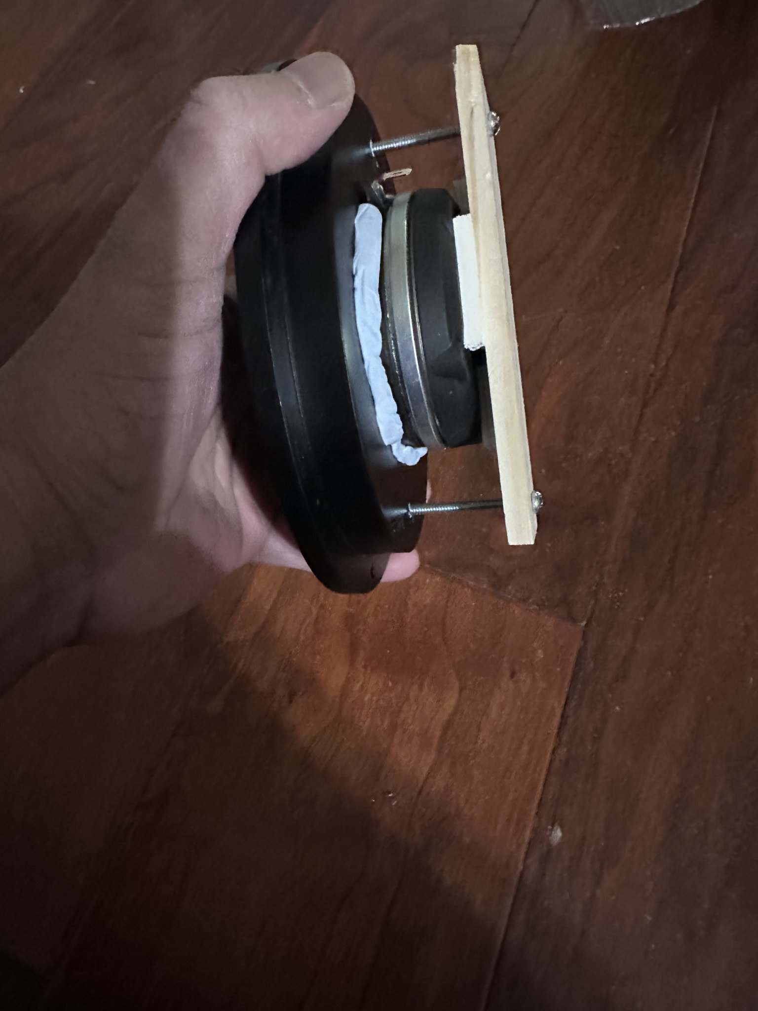

Sealing the seam between the diaphragm plate and the motor. I did this and noticed a difference on the SB26. I don't know that it would matter on the Satori.Where should I add blue tac
