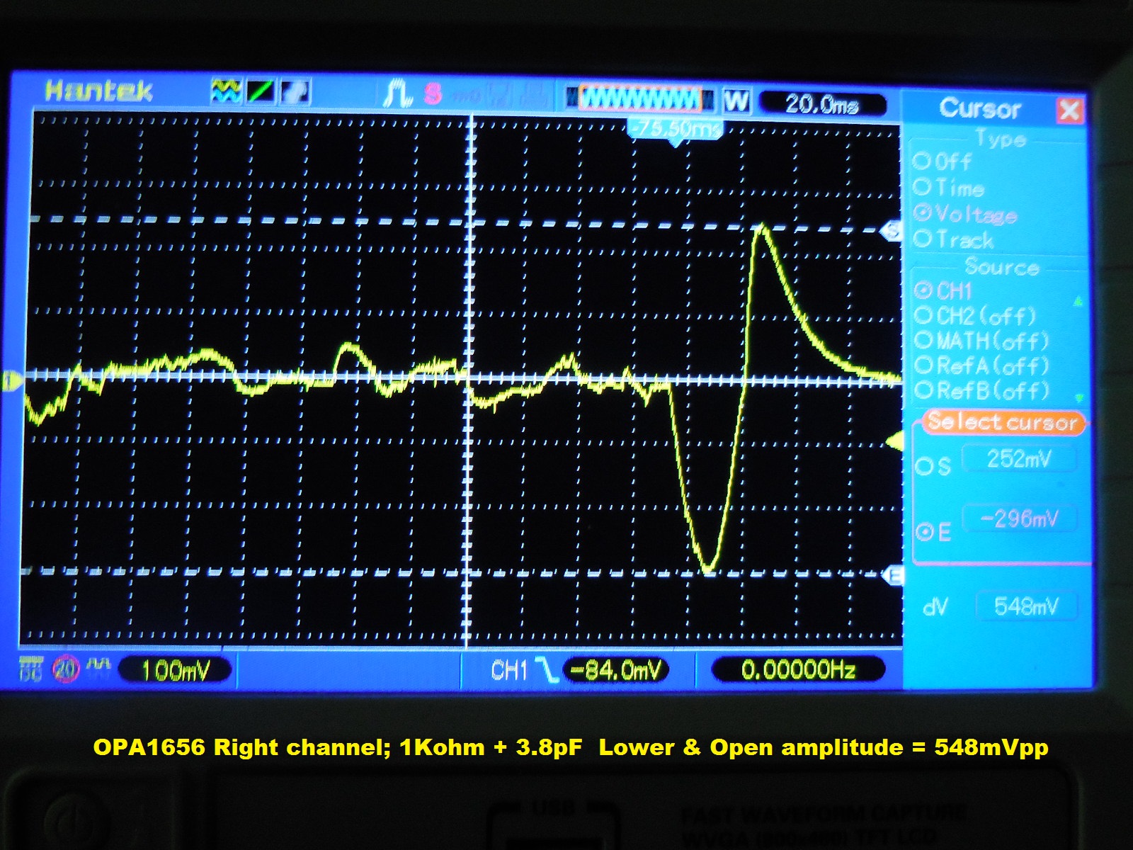

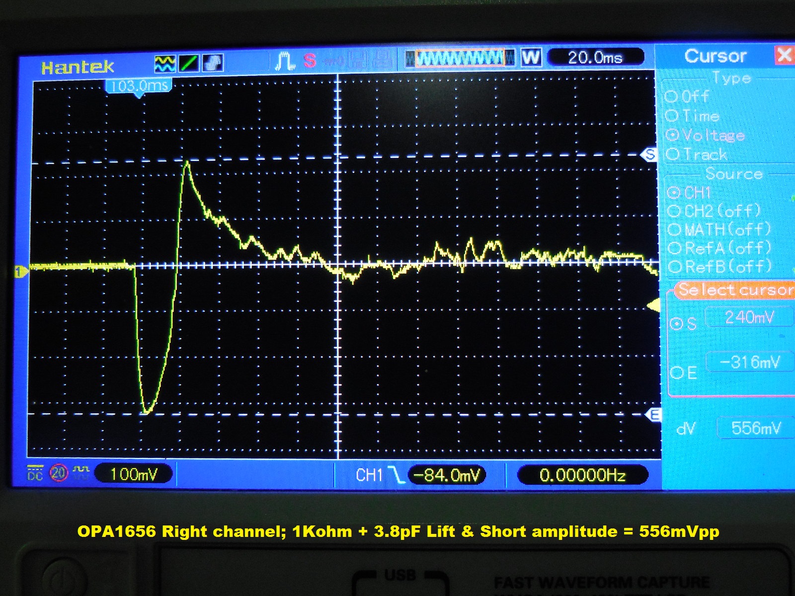

For this 3rd R/C damping trial the combo was 1KΩ + 3.8pF (approx.) placed across the Right channel’s RCA connector’s inside terminals. The 3.8pF was fashioned from 2x 6.8pF C0G ceramic disks in series. TT cables were plugged in normally; scope shots were taken off of a RCA male plugged to the Right output and the Left output cable remained connected to the system preamp for the PE reference. This was the pre-test exercising just the TT’s mute switch (aka Test #2) to determine if a listening test was warranted. This damping combo failed due the level of the Lift and Lower output disturbance.
Of possible note is that the Lift&Short transient has a clean front-end followed by a LF trail of trash. The Lower&Open transient is led by LF trash with a clean back-end.

(Almost) Purely going for my gut feeling here, but IMHO you should go in the direction of less resistance, more capacitance. Not in the other direction like you're doing right now.
I could explain this but I fear I might have my gut-feeling-math all wrong. 😉
OK, so that's too small. Could you try 33 pF, 100 ohm?
If that works, then I would suggest using 15 pF, 220 ohm as the solution, because it is then at least a factor of two away from any invisible walls/edges of cliffs and its capacitance is acceptable to you. It's a pity that the click with 15 pF, 220 ohm is somewhat worse than with 7 pF, 470 ohm for unclear reasons.
It's also what I expected, but for some unclear reason JRA hears and measures bigger disturbances with 15 pF, 220 ohm than with 7 pF, 470 ohm.
Might have to do something with the disturbances added by the measurement setup (lossy coax cable from the scope probe etc?)
EDIT: to rule out some of these smallish disturbances I would go to at least double capacitance/half resistance to see if it really gets worse in that direction...

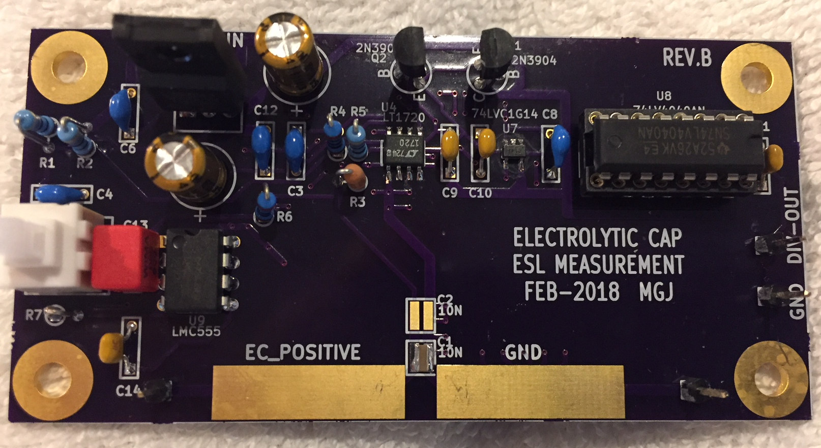

Couple years ago I built a gizmo that measures electrolytic capacitor ESL. It creates a resonant circuit between the inductance of the big eCap, and an external discrete ceramic C (in the super low inductance 0612 SMD package (reverse geometry)). Resonant frequency was around 10 MHz, well above the SRF of the eCap. The gizmo worked reasonably well, but then I gave myself permission to buy an ET1092A L/C/R/Z meter which worked even better.
link: Measuring the "ESL" inductance of electrolytic caps (at 10 MHz!)
