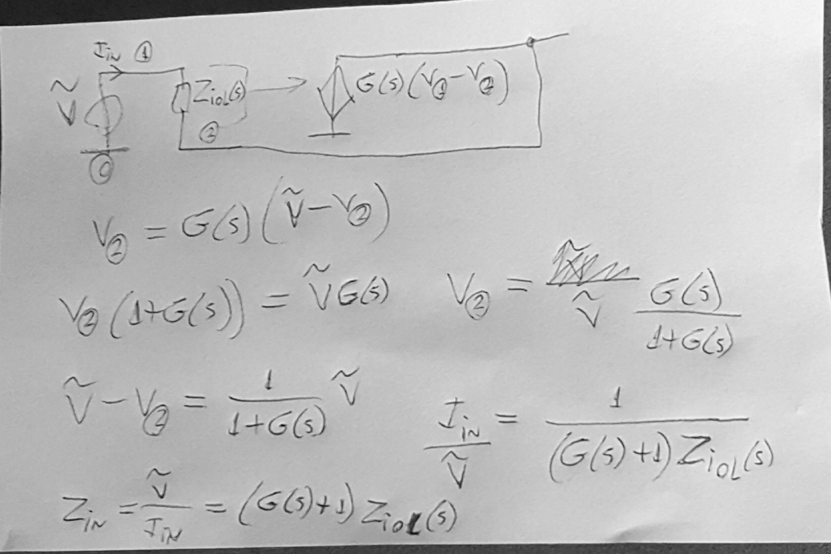

I've made a simplistic attempt to answer my own question, and I think you can get a negative input resistance with just about any op-amp, even without any board parasitics.
In the attachment G(s) is the open-loop gain and Ziol(s) is the open-loop input impedance. The closed-loop input impedance turns out to be (G(s) + 1) Ziol(s). The open-loop input impedance will normally be largely capacitive and the gain plus one factor will also have a negative phase, so the phase of the closed-loop input impedance will be beyond -90 degrees, resulting in a negative real part.
Of course this doesn't mean that an imperfect board can't make it worse, only that you don't need a bad board to get a negative input resistance.
