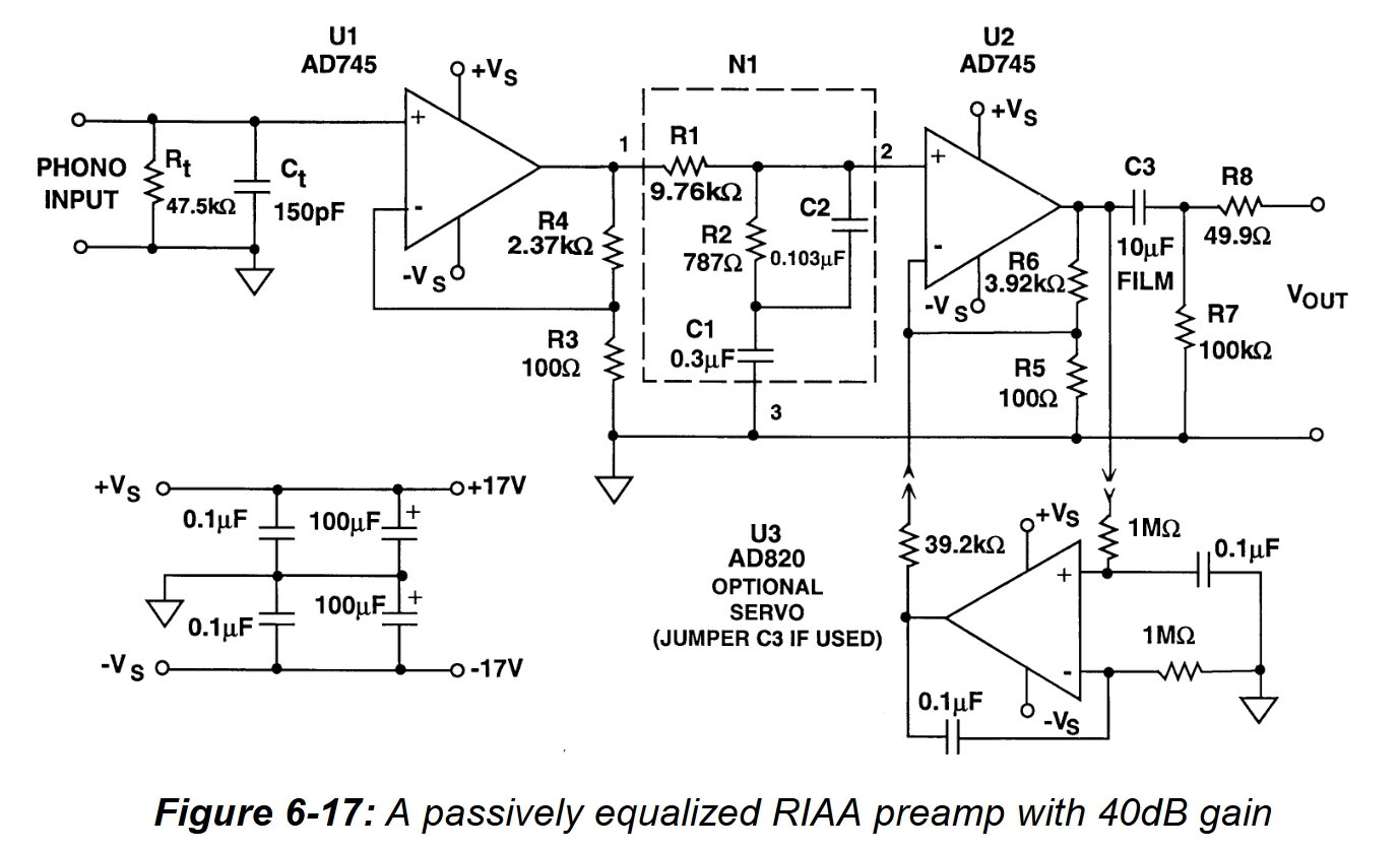

As both DC servos are based on a Walt Jung RIAA passive design, and the other on a Erno Borbely discrete preamp, my guess is they pre-corrected the servos, haven't they?

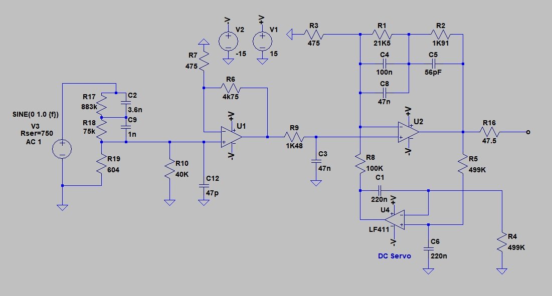

Would you suggest any changes that could improve things on the second, Erno Borbely based on design, be it on the RIAA and/or the DC servo.
I wonder if the DC servo can also work as a rumble filter. If you increase or decrease the servo output resistor also decreases or increases the preamp THD. But I wonder if it's not altering the RIAA filter too.
It does alter the RIAA correction. When you decrease R8, you increase the bandwidth of the servo loop. Besides increasing the high-pass corner frequency of the servo, that also increases the shift of the first RIAA correction pole.
Besides, you have to keep the parallel value of R3 and R8 constant to keep the RIAA correction zero at the right place.
If you want to increase the servo loop bandwidth so much that it becomes a useful subsonic filter, the shift of the first RIAA correction pole will become quite substantial. You can either precorrect the pole position such that it ends up where it should be after the shift, or add a zero in the DC servo that lies on top of the first RIAA correction pole to keep it from shifting.
The first method is inconvenient when you want to make the cut-off frequency of the subsonic filter switchable. You would also have to switch the RIAA correction network then, because each bandwidth setting requires its own precorrection.
I'll think about an elegant way to implement the second method. If I find something potentially useful, I will post it.

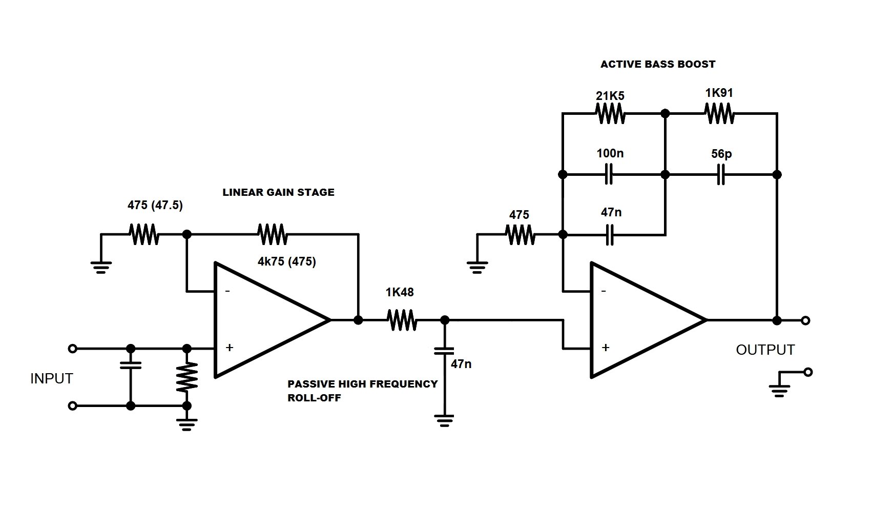

So what I did was to add a lot of crap to my TI datasheet RIAA EQ circuit. The front end had to be a Zin=47K buffer in order to receive the cart then drive the 3rd-order, 18Hz S-K high pass then on to the nice clean OPA627 RIAA section. So that’s two new additional op amp stages – albeit good ones.
The 3-stage arrangement does work. The room slosh is gone/controlled. The 3rd order @18Hz doesn’t allow the low-freq feedback room slosh to get hold - to then be boosted further by the RIAA +20dB. But I think it could be cleaner.
What I would like is a minimalistic front-end 2nd or 3rd order subsonic filter that mates with a 4-5mV MM cart, does its thing and then drives a very high-Z RIAA EQ circuit. And b/c of the Freya’s low gain, if easily done I would also like more gain in, or for the equalized output (i.e. >40dB @1000Hz) possibly within the EQ circuit itself. I’ve tried to reduce the 127R gain R but doing so jacks-up the in-series C. So first question is can one add R in the feedback loop without upsetting the RC time constants?
I’d love ideas. Maybe a RC passive high-pass up-front? I do strongly want to preserve 30Hz and above. The attached is the detail the filter I built and the rough overall sketches. (Please forgive my crayon-quality dwgs. I’m too old and/or lazy to learn a drawing package.)

What I think you are describing as cone flapping is a Arm/Cartridge resonance coupled with probably some room feedback "slosh" which tends to perpetuate or re-excite the resonance. If at all so, the TT's position has to be isolated from the room. The series input C of 100nF + the 47K cart load created a very roughly 6dB/oct @34Hz high-pass filter - driven by the complex innards of the cart. In my mind a musical sub-sonic filter must preserve at least 30Hz and up (i.e. 4-string bass, 5-string bass, the double stand-up bass, pipe organ and so on). 20Hz and up would be ideal. One has to be careful b/c low-order filters have a long reach. FWIW. Hope I wasn't off-base.
