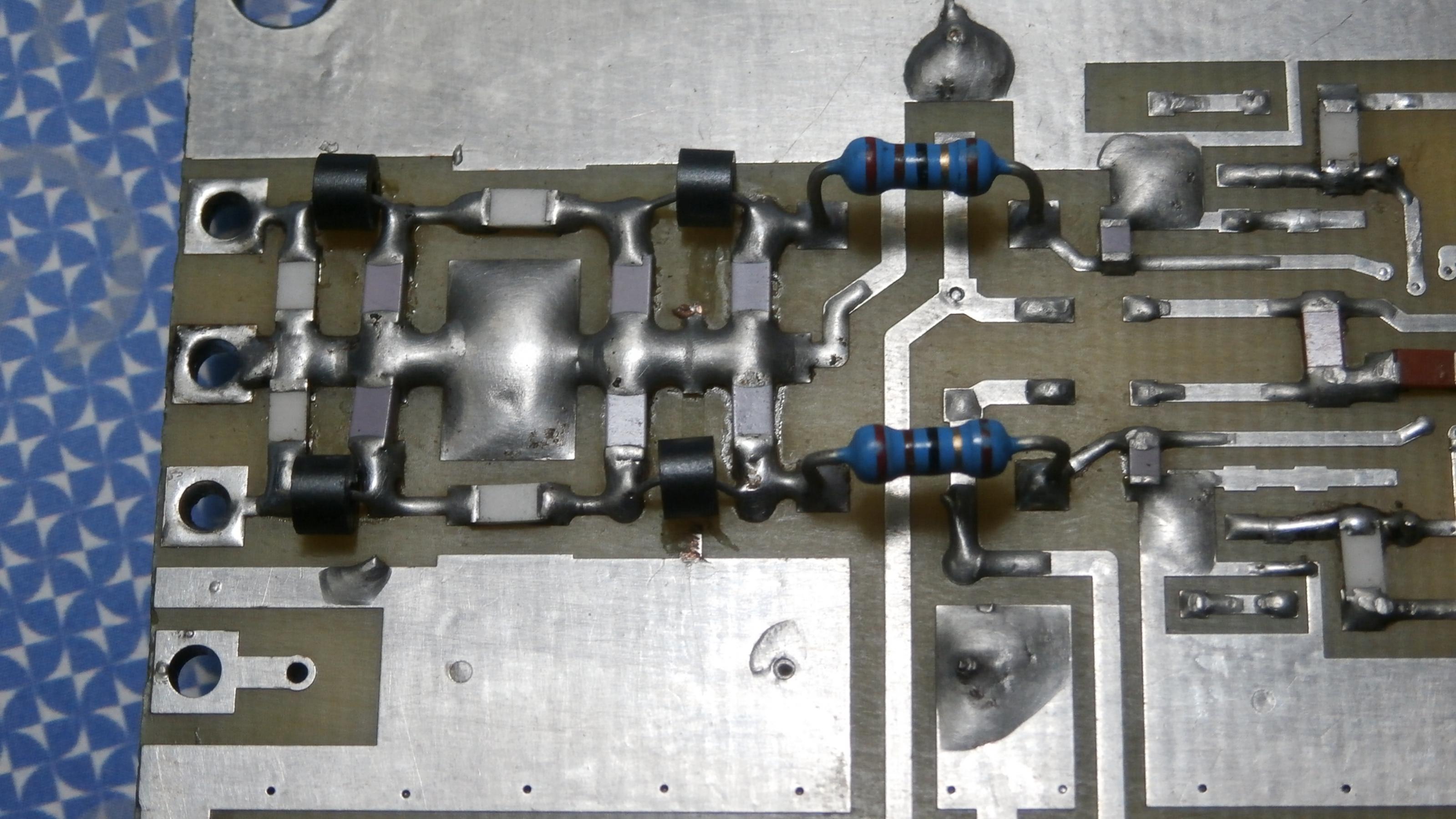

I've built my own using the OPA1656 but did not find the proto boards be a good idea for trying opamps, so I started having boards made using ExpressPCB.
And after much playing around, I found that putting the IC farther away from the actual input was an improvement with noise. To later finding that instead of one loading cap on the input, I divided the capacitance value by 3 and use three different caps on each input to the chip. In between the input on the PC board to the input of the IC for each channel, I have 47K to ground, ferrite bead, 100 ohm resistor, 33pf to ground, ferrite bead, 33pf to ground, 21 ohm resistor to IC, 33pf to ground.
The beads and resistors in series really help clean the sound up in the high frequencies. Someone in a previous post had mentioned putting a resistor in series to help lower the noise and that is what I've also done, but went a tad further.
I've integrated some filtering into the loading of the cartridge to deal with the spurious noise coming from the turntable.

mp20748: I don't remember seeing your post. Don't know why and not sure where this Reply is going. In any case, that seems like a whole lot RCL armor you felt you needed to add to the 1656 inputs. Question I have is what was it about the sound up in the high frequencies that was not clean? Was the source actually the TT? Was it treble distortion in the music or as you say spurious noise like pops, ticks, crackles and such? And was the unwanted noise quite loud? Sorry for all the questions. Just curious.
The very fast OPA1656 has to be used with great care, meaning good power supply decoupling, preferably a ground plane and a well designed PCB around the input connections.
Despite the low source resistance driving the preamp, the interconnect’s capacitance and switchable input resistors can easily lead to stability problems causing differences in sound perceptions.
Proof of the pudding would be to use a slower opamp that’s less critical like the OPA2134 or the OPA1642 and see if the supposed sound differences are still there.
I was triggered by a post that mentioned adding an 82ohm resistor that made me think about the preamp I built, that has an 100 ohm resistor in between 47k/100pf loading and the IC's input. I added that resistor as well, a ferrite bead idea from Yamaha that is common on most of their earlier magnetic preamp designs. And in my research about why did Yamaha add the bead, I was told its most likely to cut down on some of the noise that would be at the phono input. It was explained to me that the high gain of the preamp would attract a lot of common high frequency noise that is everywhere these days. These noises may not be in the audio range, but getting into the opamp could cloud its performance, and that turned out to be true. So I then implemented something I remembered on a different circuit where the input was spaced from the source using series components. So I then spread the 100pf capacitance by using three 33pf caps going to ground and in between the beads and 100ohn resistor. On that particular board I've added another 33pf right on the chips input that I change out depending on the cartridge I'm using. I built three identical boards to play with this.
And after noticing a difference I took my preamp to a guy that repairs audio stuff, and he also explained that it made sense because of the noise from the high gain input. He then pointed out that the 4 cartridge wires are not shielded for at least 12 inches from below the tone arm to right near the cartridge. So to me that confirmed why Yamaha would add the beads right at the input of their preamp. The audio repair tech provided a set of speakers and an amplifier and album. I took my Denon DP35 turntable with me that was using an Ortofon red cartridge that I paid $99 for. I told the audio guy to see if he could notice a difference and he said yes immediately and that I was using a $99 cartridge. But the bigger thing on my board is that I use regulators for both +/- supply and a lot of decoupling between the chip's supply to the regulators.
I may have used the wrong word to describe the noise, when HASH noise would have been the better word to use. One thing for sure, these chips perform better when better decoupled with lower noise on the input. The board design is also critical to minimize any parasited oscillation, which will also cloud up the signal.

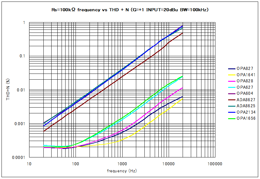

Well hello there. Yes it's been a while and I was just thinking about extending the thread, looking to bounce ideas off of the sharpies here re addition of a sub-sonic filter to the design. With minimal sonic impact. But first some musings:
What about the LT1792 caught your interest? Some cons I saw (and I am no expert) were: High offset voltage: high input bias; marginal slew rate; high input capacitance; high THD+N vs. freq.
Have you seen the less $$ dual version of the 1792? https://www.digikey.com/en/products/detail/analog-devices-inc/lt1113cn8-pbf/889437
Have you heard of the Burr-Brown Difet FET op-amp breakthrough re stabilized input capacitance in non-inverting mode (i.e. no change in C over common mode voltage swings)?
Three op amps that are difets are; the king of audio op amps OPA627; an originally maligned but excellent sonic performer OPA1642, and a close comer difet OPA2107.

FWIW: The platform and criteria I used over the years or decades for rolling op amps is a state-variable type, Linkwitz-Riley 4th-order, 2-way crossover for my mains and my subs (4x duals, each channel). I would pay close attention to what the headphone forum members were chatting about when a comparison thread or article or shootout appeared on op amp sonic behavior. Then I would pick one or two winners, buy those and populate the LR-4 crossover, I used the above "research logic" to make up for my own ignorance, laziness, lack of sonic discrimination, lack of nuance sensitivity, lack of fine detail perception but these people have the ear, have taken time and have combed through the old and new LTs, the OPAs, the AMs and so on so I will follow them.
See attached comparison.
