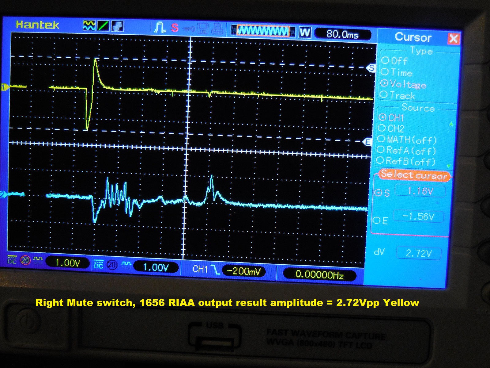

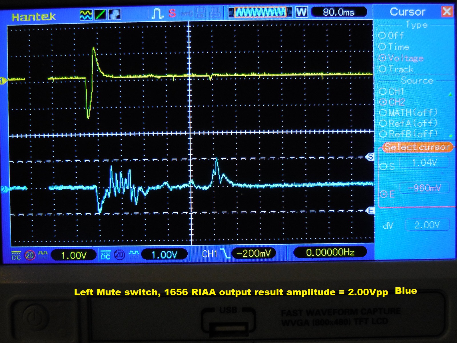

Here are the scope shots showing difference in raw output due to different mute switch personalities. This is all stock setup, no damping, TT straight in, scope probes on R&L 1656 RIAA EQ outputs. Same trace, diff is voltage cursors. Weird.

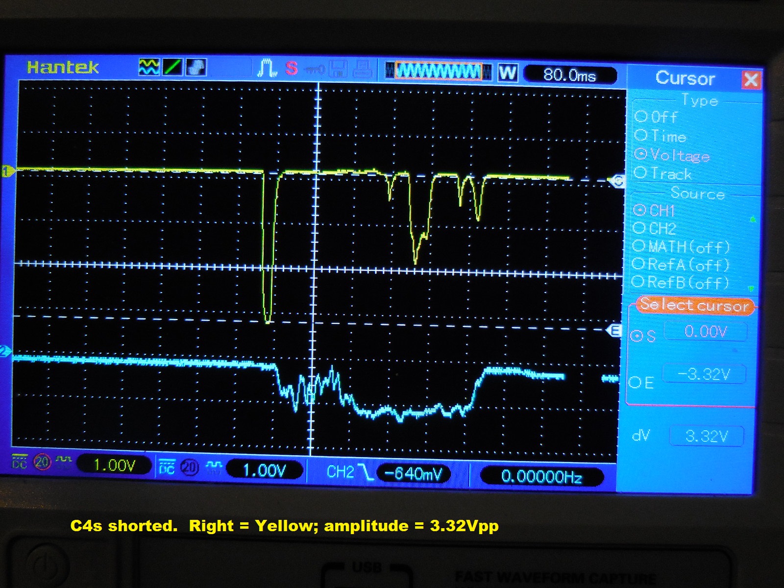

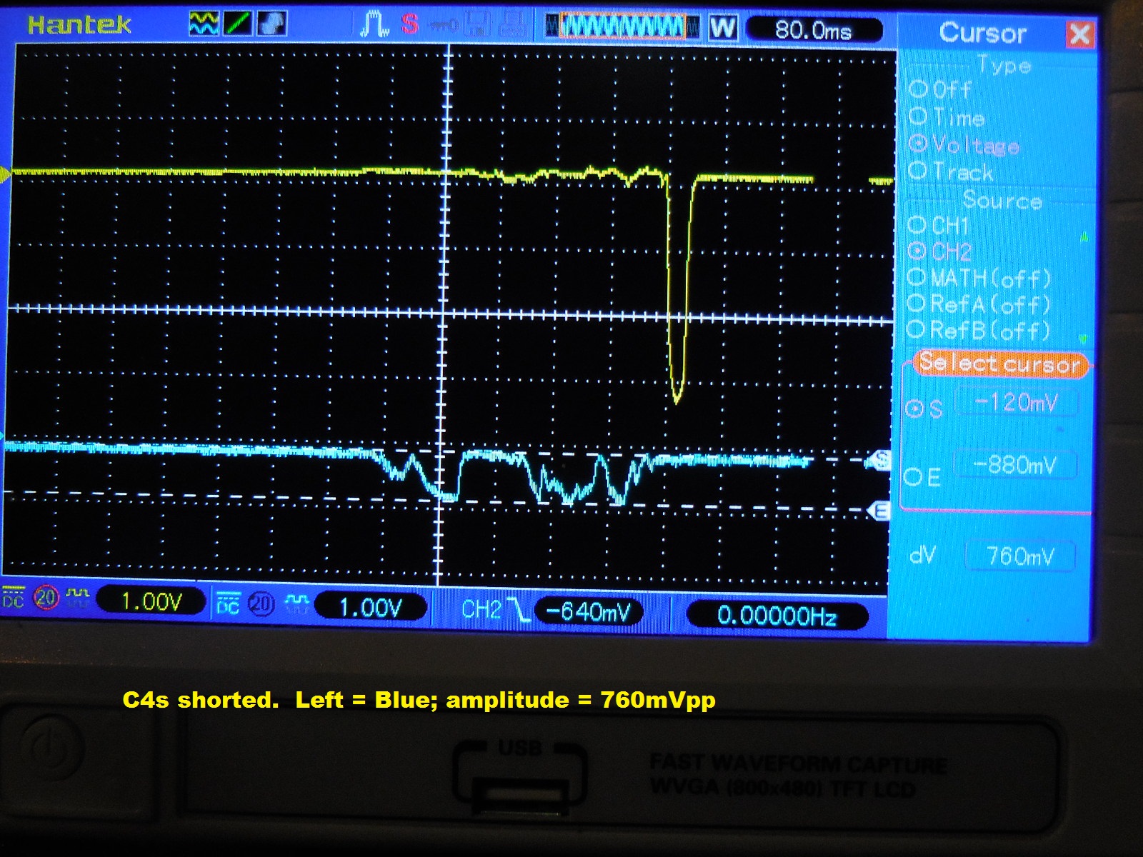

Here are the C4s shorted pics Hans. One is a Lift and the other is a Lower. I forgot which but you can see the R&L, close/open sequence shift in time, FWIW. There were large static offsets. One was ~-190mVrms and the other ~+20mVrms. Overall, not too pretty so the C4s have to stay. I "always" see them even in the 2-part RIAA EQ circuits.
O.k. Nothing new, confirming that C4 is taking no part in the thump reactions.
So keep it as before.
About the different behaviour between the two channels without damping, could this be caused by the fact that one channel on your Cart is connected between the cold side and the Cart’s housing and thus also via the arm to the TT chassis while the other channel goes floating to your preamp ?
And there is also a separate wire going from your TT’s chassis to your preamp housing, true ?
Hans

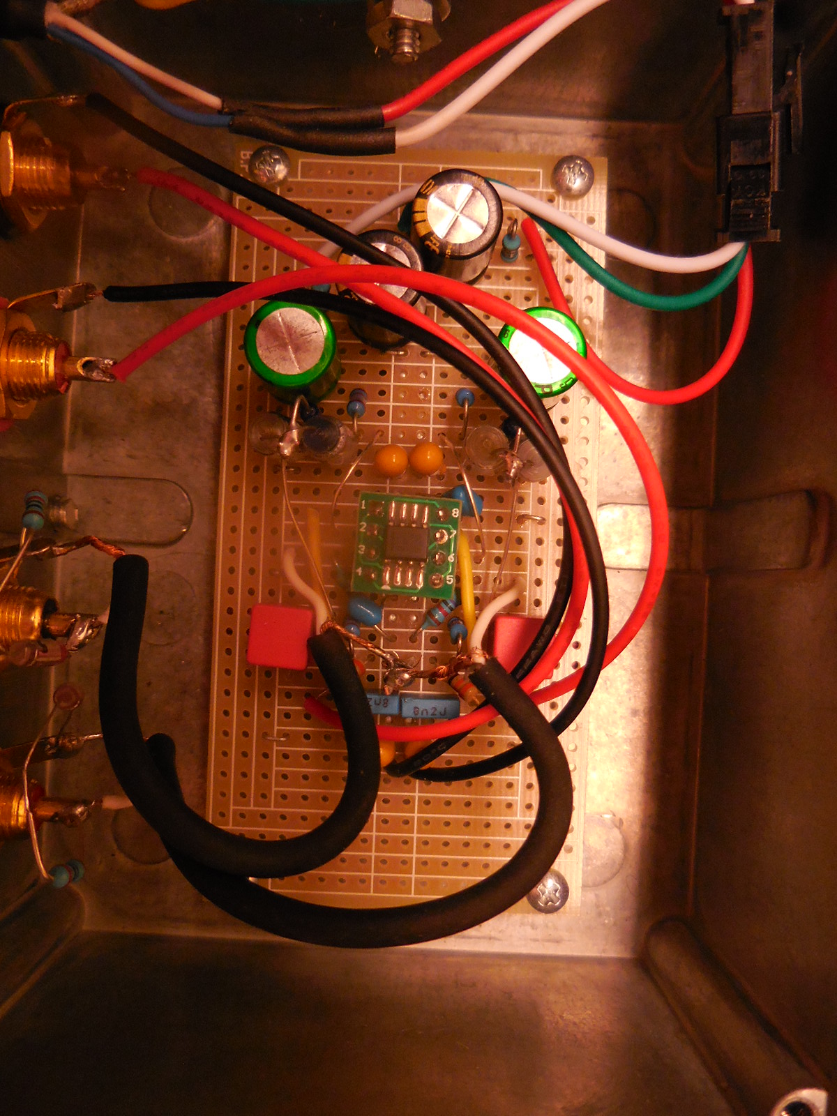

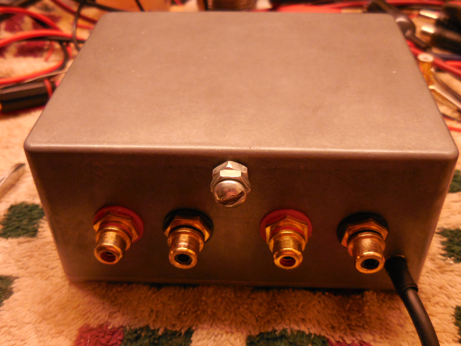

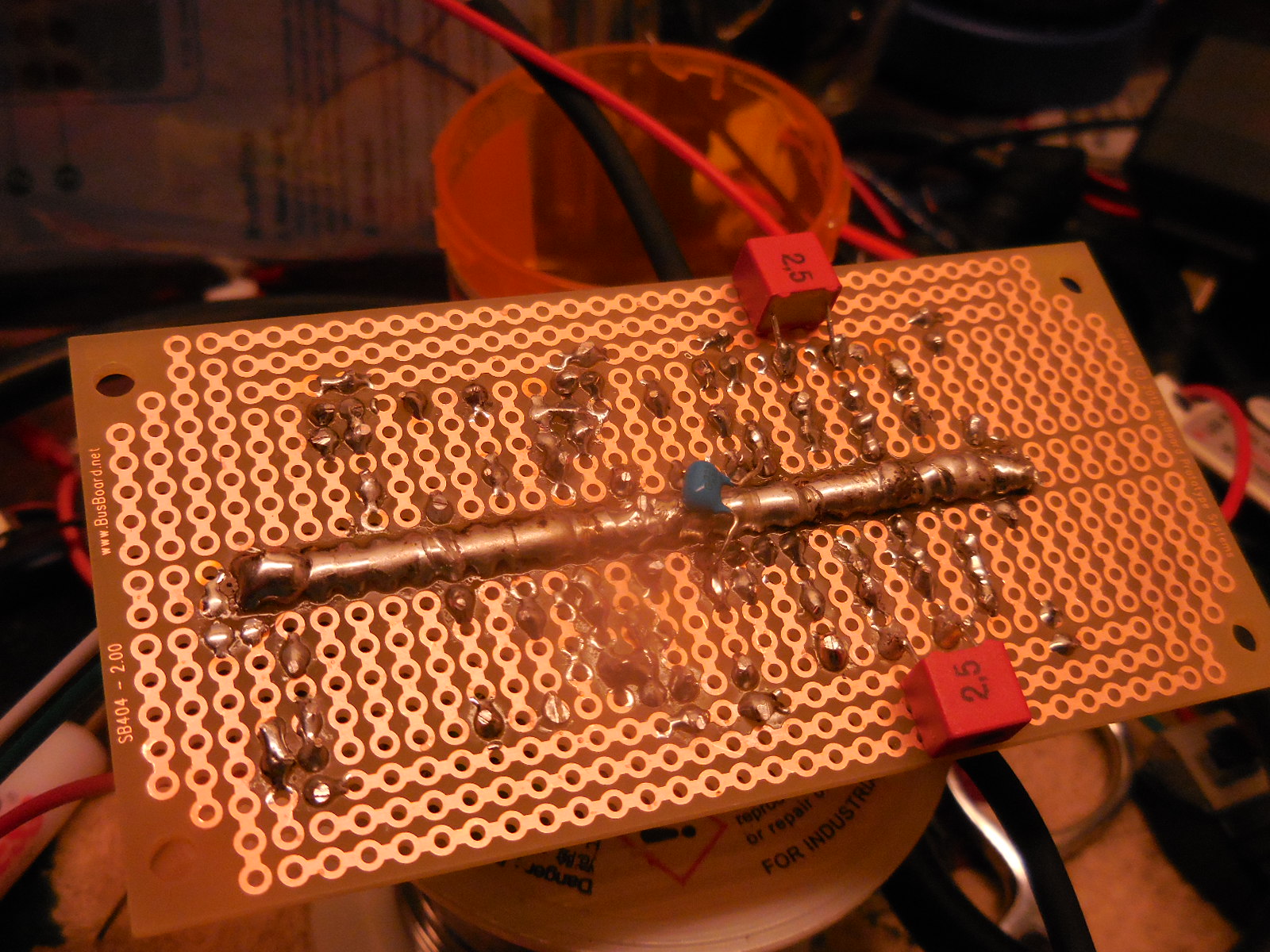

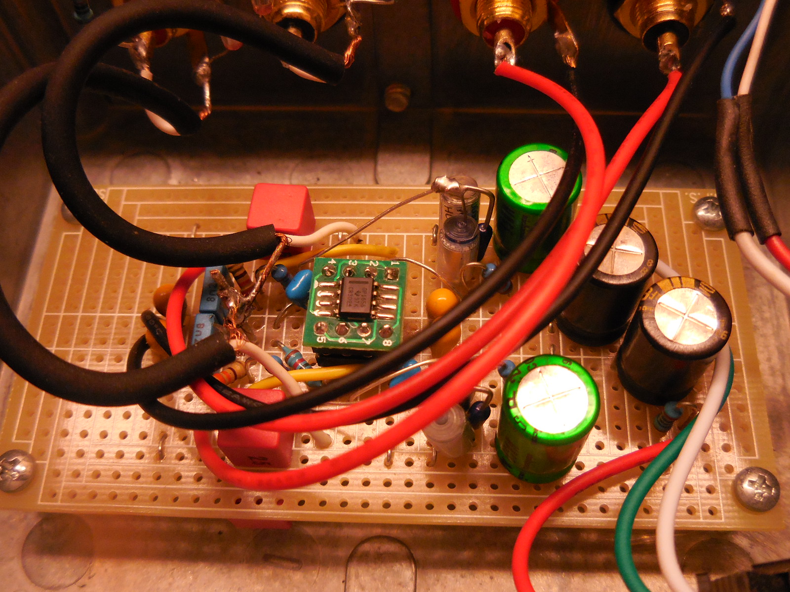

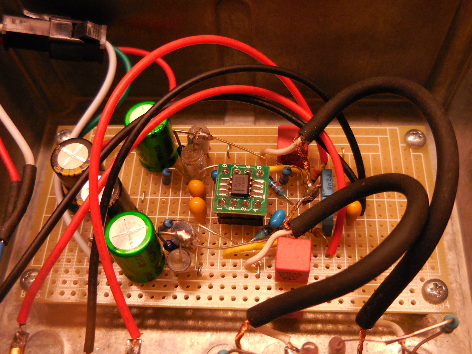

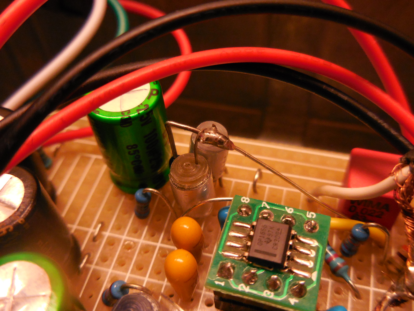

All of the experiments and trials were using the second build. Only the original pics and diagrams were of the first go. Everything test-wise pertains to the 2nd build. There was no real change in the 1656's behavior in a new environment so I saw no reason to mention it. The attached is as it's been for a while now.
I may swap in the #1 build now that I have a silver bullet just b/c it is all polystyrene vs. a hybrid. But that can wait.

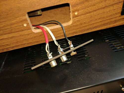

I'd have to track down why I saw a low-ohms reading between one channel's shield and the TT's gnd wire. More tasks for me!
Yes there is always a piece of ordinary hook-up wire out the back of a TT to be connected to the Phono Gnd at the preamp. Never knew what this did but if not connected you know it.
Like the attached. I think they did that in my TT.

You are using a separate wire from preamp case to TT chassis, right?
So because of that important wire, cut that short piece of wire in your picture connecting the TT chassis to one of the two RCA sockets.
Then measure the still disconnected TT between the cold side of both RCA sockets and TT chassis whether there is still a connection.
If not, both channels are now floating and should give the same response without Diazepam.
