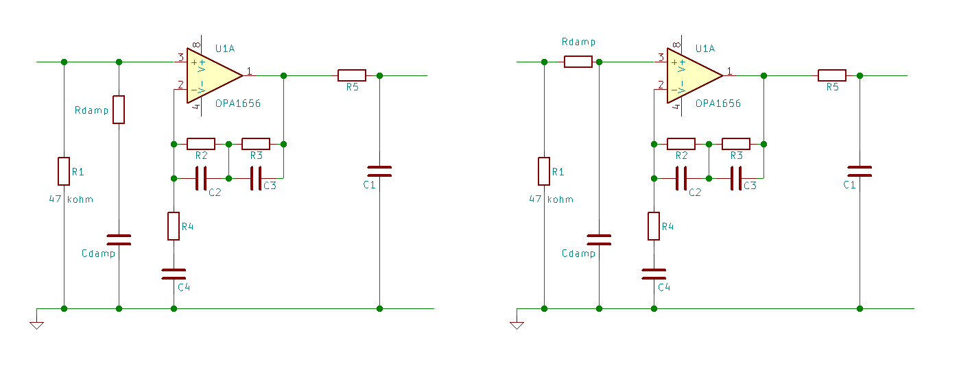

O.k, your experiment with the separate interconnect shows that your TT + Cart can be excluded from the equation.
That narrows the search for a cause.
My next suggestion would now be to shorten C4, the 100uF cap.
This will cause a DC offset at the 1656 output, but below 1Volt so still acceptable for this test.
Your main amp probable has a dc blocking cap at it’s input.
Hans
I could do that Hans and could deal with some Vos but since this is a 1-stage pre, all the DC gain would go to 60dB. There would be no warp or eccentricity or "rumble" immunity at all. Isn't that a worry? I also don't think it was the RIAA's intent to go down to 0Hz. Now yes, a hi-pass up front could help out. It's interesting that according to the TI circuit write-up the divergence from the RIAA spec in the very low-end could be lessened by increasing C4! BTW. What's your theory re shunting C4?
Do you call 50 MHz low frequency?
The thing with oscillations is that their amplitudes tend to keep growing exponentially until some non-linear effect, like some stage that clips, stops the growth. If that clipping happens asymmetrically, as is almost always the case, it causes a DC shift.
To me, the logical next step would be to try RC damping networks or RC filters, like 10 pF-330 ohm, 15 pF-220 ohm, 33 pF-100 ohm, 47 pF-68 ohm or 82 ohm. See if it helps and if so, try to stay away from the edge of the cliff.
Tell me where to put the R-C hi-pass. Do want to see the series R between the 47K and + input or up-front between the RCA and 47K?
I understand this is your final version and not a proto.
Shortening C4 is not meant as a permanent solution, just as a test because your bumps are at LF where C4 still has a high impedance.
Two possible outcomes:
1) it doesn’t change your problem, then the fast opamps that you don’t really need should be avoided and the opa627 is an excellent (but very expensive) amp.
2) it solves your problem and then it’s up to you how to find an alterative for a rumble filter if you want to proceed with the OPA1656.
Hans
It's either a damper or a low-pass, see the attachment (where I left out the op-amp supply connections and input and output connectors out of laziness). Rdamp and Cdamp are the new components.
My preference would be the right circuit because of the RF filtering and because you could use larger resistors than 3 ns/Cdamp if needed (or so I expect), but either should help if my hypothesis is correct. The left circuit has the advantage that you don't need to open any connections, just hook up something in parallel to the input, and it has a very small noise advantage.

Tonight I'll try shunting C4 and also try the damping as I still have the 15pF polystyrenes across the RCA inputs from the other test so will add a 220R in-series.
Btw, is there any prejudice against polystyrene caps? Are they considered inductive? My surplus PolyS caps are axials so are "jelly rolls" but I can see the crunched extended-foil edges through the transparent end caps.
I am now listening to a 47yr-old pressing of "There goes Rhymin' Simon" - using an OPA1656-based RIAA EQ preamp - without sonic issue. Everything is hooked-up as per usual. Lifts and Lowers are soooo soft. The Mute switch is right there, right on cue, very well behaved. I could be hallucinating again (that was embarrassing) so I will report more later, tomorrow. For now, fingers crossed; all fixed with the attached circuit mod from MarcelvdG. Thank you!
PS
This mod passed the no cart, no TT 1Kohm loaded cable-only scope test b/c I could not get a trigger. Then it passed the Lift and Lower scope test with TT and MM Cart attached. Then it passed the system volume test where I Lift and Lower and just listen at increasing volume levels.
