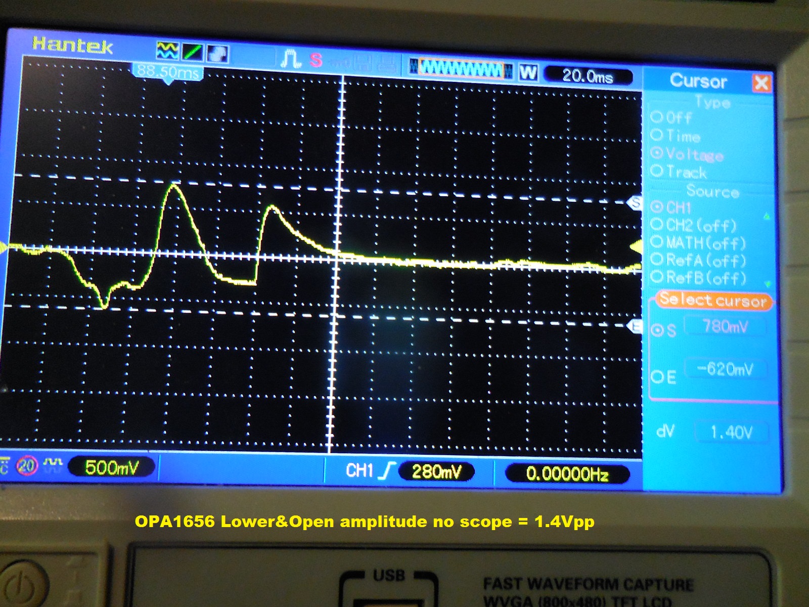

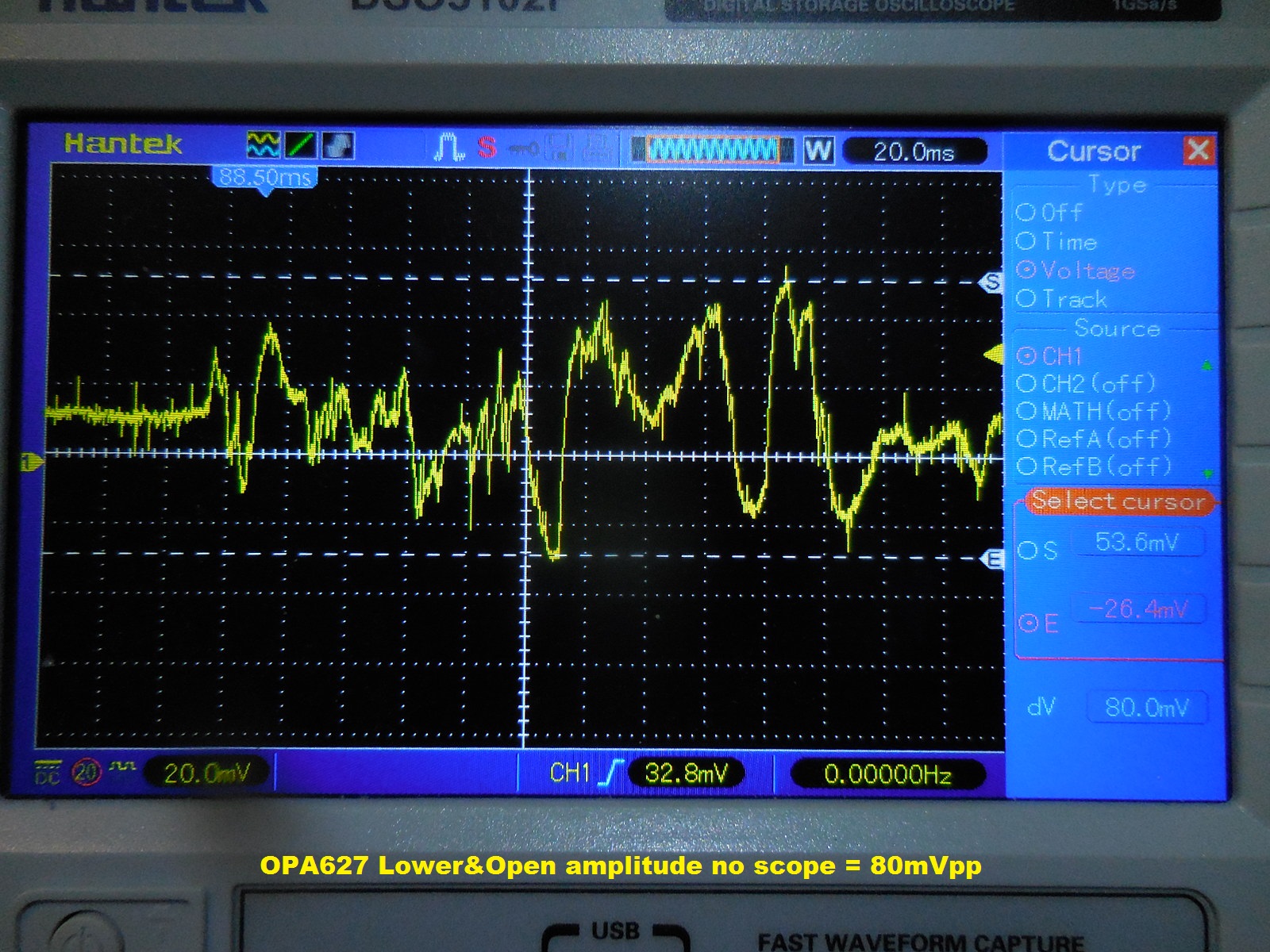

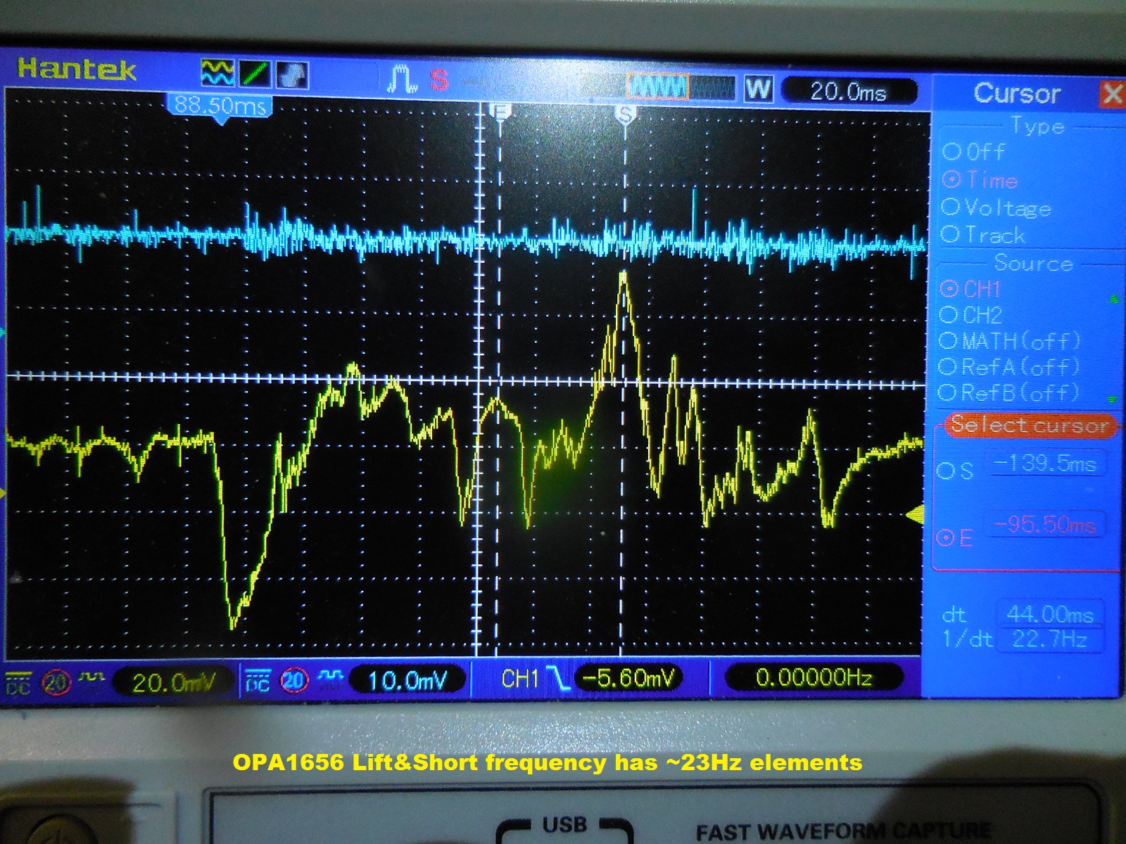

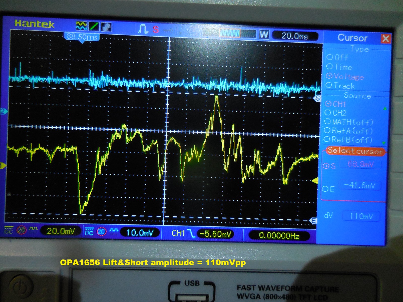

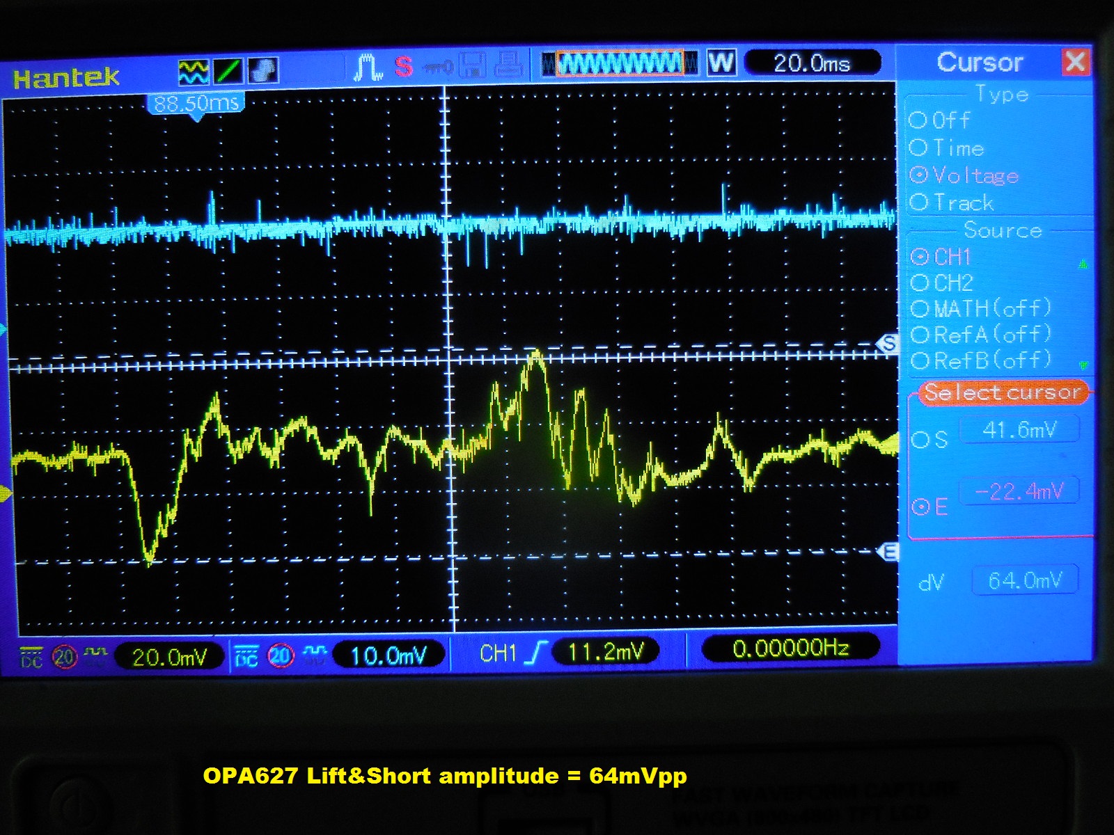

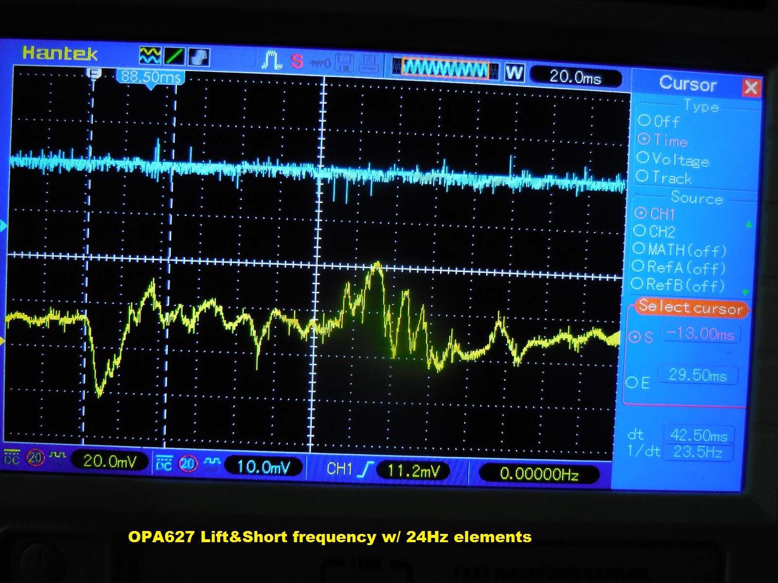

The way I did this THUMP test was to Blue-trace the cart’s right chan at the RIAA pre’s input RCA connector and to Yellow-trace the pre’s RCA connector output (hooked to the main pre’s Aux Line Input as usual).
In order to exercise the TT’s mute switch I used its “Lift/Cue” function wherein a button press lifts the arm straight up off the rest and stops. Along the way it shorts the cart’s outputs - aka here as “Lift&Short”.
A second press has the arm lower back down to the rest and along the way the cart outputs are un-shorted - aka here as “Lower&Open”.
With this scope setup I got the attached display shots. Compare the docile OPA627 to the speaker-eater OPA1656. Don’t look all that crazy different do they? Note that the Blue-trace cart output gives no indication of a smoking-gun input disturbance. 10mV/div is as low as my scope goes.

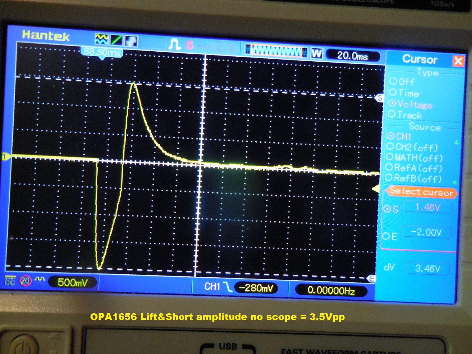

Now, I remembered how just the presence a scope probe could cause circuit trouble or cause circuit trouble to vanish. For this round of pics I removed the Blue probe + the solid 1-male => 2-female adapter used to allow tapping into the RCA input and plugged the right channel TT input cable straight in as per usual.
Hint = no more scope probe impedance across the 47K R.
These shots show both the Lowering and Lifting RIAA output results for both op amps. Seems that some posters here are on the right track. I have no endpoint pF at the op amp's + input or RC filter. My 195pF "load" for the cart is distributed all along the signal path.

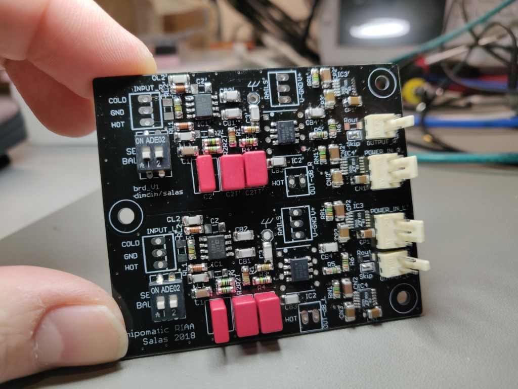

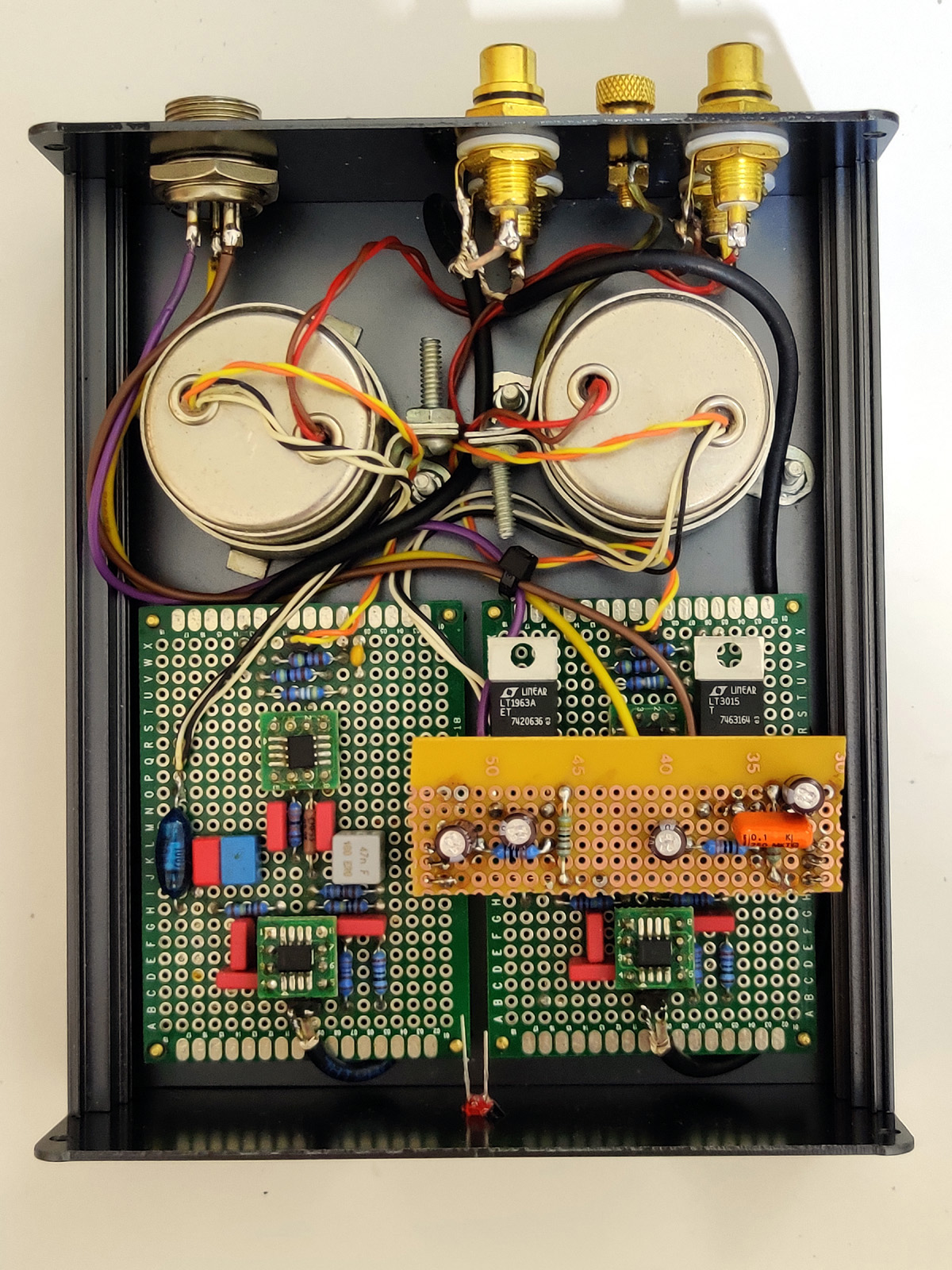

Very clean looking layout. Love to see the bottom-side 🙂 The small box type Wimas are very popular. For the main RIAA EQ caps did you find them in 1% or hand-select? I assume you used 0.1% Rs. What are the big cans, btw? Have you tried your RIAA box with a mute switch TT? I'm just real curious.
I did use 0.1uF X7Rs at pin 4 and 8 and between 4 and 8.
The blue resistors were low ppm, also better than 1% maybe. Not sure because I stuffed those boards almost three years ago. The gray and blue ERO MKP rectangular caps 1%. The blue I hand matched it to the 5% Wima MKP red next to it and to the blue balloon styrene 5%. All three in parallel to a total HF pole cap value goal. I don't have a mute switch TT.
Three friends built a surface mount PCB version with a regs section too that I authored with one of them. Five were ever printed. They had a layout bug to bodge as well. I kept the matrix boards prototype. Was measuring right so I saw no reason to remake it in SMT.

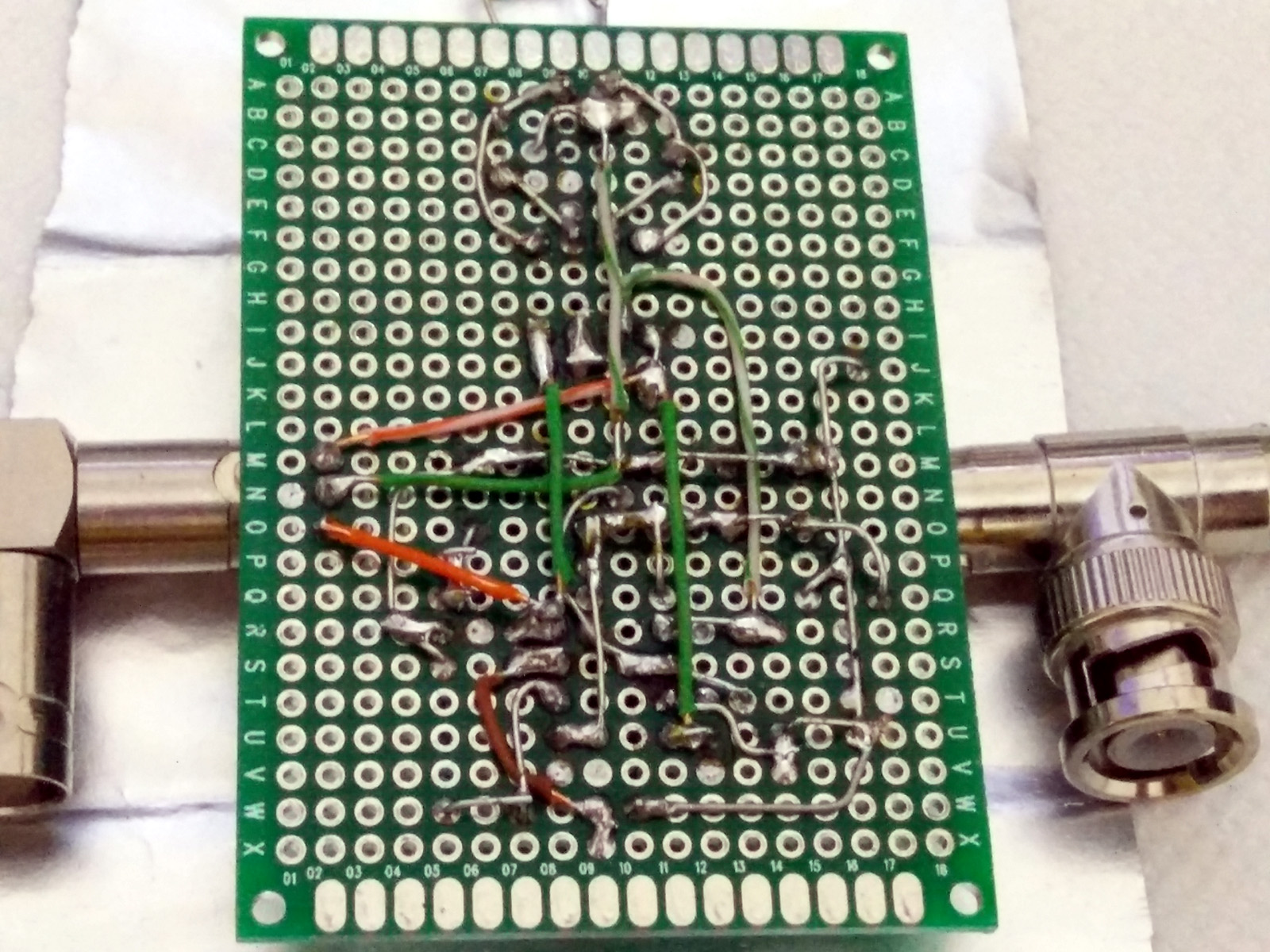

Yes, that back-side is looking appropriately DIY ratty 🙂 As I wrote in my original post page 56 I chose to go old-school with polystyrene b/c of their vaulted reputation and found them surplus in just about any odd value you can imagine. But they run large-bodied and what you want may not be in the smaller 25 or 33V body size so one settles for the 60 or 160V body which then expands the layout - requires longer leads and jumper paths back to the op amp, etc. I guess nH add up.
Still am curious about the two large cans in you original pic of the RIAA box..?
