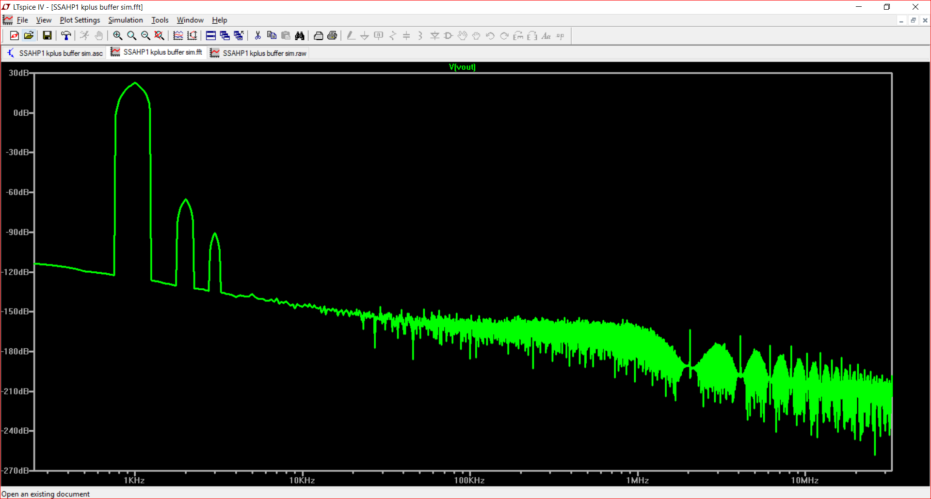

Anyway I have simulated the circuit with an LT1010 buffer IC to show what effect introducing this would have on the results. It looks tidier to me - I have attached the simulation file and FFT for your information.
It is notable that the most prominent harmonics are second and third in declining proportion regardless of the presence of an IC op.amp in the circuit see LT1010 - Fast 150mA Power Buffer - Linear Technology for more detail.
The simulation file is configured for a normal unbalanced input signal input which is the most simple route for you to take to get your amplifier working.
If you download SPICE in the first instance and then the .asc attachment you will be able to run the simulation by right clicking on the image. If you put the cursor over the circuit there will be a reading at the bottom left hand corner of the file. The dc offset is 9 mV and the Iq in the output transistors is 18 mA each.
The 1kHz THD is 0.0041% in theory which would seem optimistic when you look at the LT1010 data in the link.

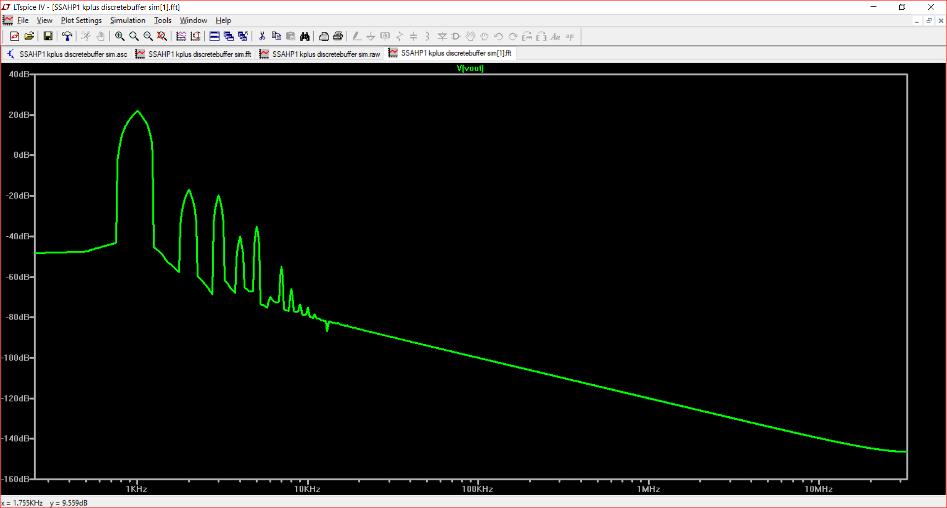

You could take Dadod's circuit as illustrating an idea. It is not too different from a circuit I used a long time ago and I have simulated this in anticipation of your asking this question.
As a first step I simulated this on its' own with a 600R load which is about as much as it will tolerate - THD with this load is worse than with LT1010 in the main circuit.
If that part is replaced by the discrete buffer in the main circuit THD increases to 1.4%
If you look at dadod's buffer you will see an 820R buffer resistor in series with the output which indicates the loading is not so demanding.
I am attaching the revised simulation with the discrete buffer and the FFT.

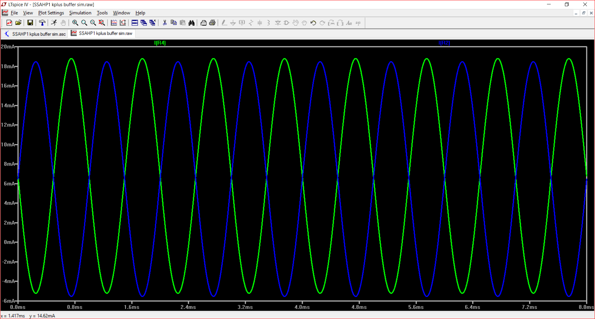

The input impedance of a power transistor is low and to drive them to capacity would require quite a lot of current.
In post 207 keantoken observed the input signal at the inverting input would see a load of 100R in the feedback path R17-R2 and R18-R4.
The amount of current drive for the purpose can be seen by those passed for instance through R2 and R4 in the attachment.
An LT1010 is a capable real life substitute for the SPICE generator - for a discrete transistor circuit you will need something better than the simple one I posted.

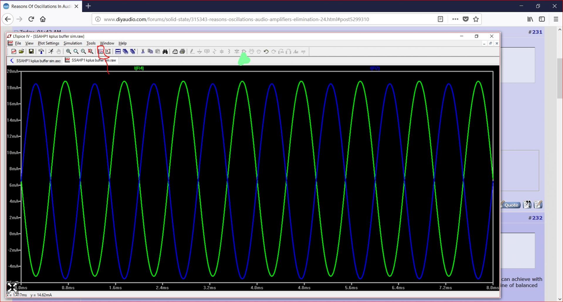

The .asc file is attached. See also the second attachment -in the tool needed for a signal generator has a green blob below. Left clicking opens the less common components elsewhere on the tool bar. Scroll across the right and click on "voltage" and the symbol will appear click on OK - you can drag one and left click at a place desired in the schematic. You can have as many as you like by repeat left clicks - here you need only one - right click to exit.
Moving the cursor over the created symbol will bring up a symbol with a pointing white hand - right click over this brings up the fields needing to be entered - I copied these from V3 and clicked OK.
After that process hovering over a component will bring up the symbol with the red arrow.
In the same attachment there is a red circle around the tool used to plot such parameters as V[vin] etc V[vout] [n001] I[C1], I[R1], I[V1] Ib[Q1], etc,etc.
You can use these to see what happens under dynamic conditions - and there is much more scope to explore what is happening at various points of the circuit.
On the question of dadod's buffer it is entirely suited for his purpose. In this circuit there is a snag in that dadod's needs a buffer resistor at the output of 820R.
You can test what would happen in your circuit by right clicking on the resistor symbol in the tool bar, and left clicking and dragging this into place in the connection between V4 and the inverting input. Move the cursor to hover and enter 820 in the resistor value field and click Ok.
Right click on the schematic and select Run and follow the steps previously outlined for FFT and SPICE Error Log.
I have revised the simulation for the circuits 1. with LT1010 as the buffer - as it turns out this is in library and 2. with a revised version of the 4 transistor buffer which gets close to this in performance using higher voltage rails available within the amplifier some resistor value changes and higher voltage transistors.
With a test load included in the simulation the respective figures for THD at 1kHz are 0.0042% and 0.0056%.
The 4 transistor buffer could be further tuned with different resistor values as long as transistor dissipation is less than 600 mW - one could try replacing these with some of those used in the main power amplifier. Hover over the transistor of choice and copy the name - then hover over whichever of the four transistors to open the dialogue box and paste. The dissipation will register with the white hand pointer symbol moving over the transistor - read this in the left side of the bar at the bottom of the .asc screen.
