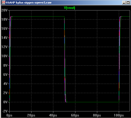

One of these is a 10 kHz square wave test with the merged section in the nfb line with a step response capacitor in parallel. In this alternative there is no overshoot in the wave before the output coil.
The ripples after the coil represent the selection of capacitors from 10n to 2uF in one shot.
With the original network as used in the 1kHz sine wave test simulation - there is a single overshoot which many would overlook - but overall the amplifier should be stable with reactive loads and it will be convenient not to alter your pcb.

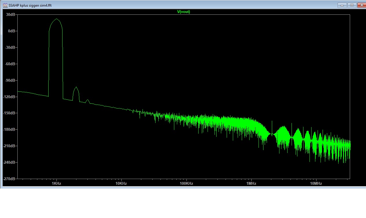

I have omitted R39 R40 (2R2) as they are not required. thd is unbelievable.

Anyway I have done a pair of simulations one of THD and one of square wave performance.
By this means I was able to cross check the results on two fronts by making the same change in each simulation - taking things one step at a time.
I have checked the square wave simulation with a variety of capacitors in parallel with 8R with varying signal input levels monitoring the result at node n20 - I have seen circuit simulations where a malfunction occurs at a low level input signal level.
I don't have the time to fine tune at length - the dc offset is 22 mV
The file is attached for reference purposes.

In my simulation THD depends on input capacitor used. 100uF isn't a practical value. I would use 1-4uF in that place.
Your last asc file don't show THD and FFT simulation in usual way. Maybe I doing something wrong.

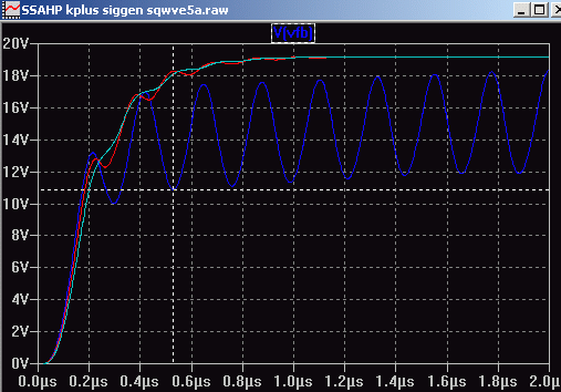

Stable ver. on lower currents
There are two changes that will make your amplifier stable.
First change your VAS transistor connections so C34 connects between the collector of Q16 and likewise so the base of Q14 and C36 connects between the collector of Q17 and the base of Q18.
Second you need an output coil 10uH //10R looks tidier in simulations of square waves but you might get away with 2uH.
C3 at the input does not affect the simulations - it appears to be superfluous.
The amplifier is running heavily into Class A with an output standing current of 900 mA.
If you reduce this operating level you will need to repeat your simulation tests as operating in this mode has mitigating effects on circuits.
I have attached the square wave simulation so you can cross check the results of any changes in your sine wave simulation.

What do you mean by "the base of Q14 and C36 connects between the collector of Q17 and the base of Q18"?
It's stable even at 176 mA and with 1uH, 100p compensation caps.

You have interpreted the meaning correctly looking at your revised simulation - "Q14" should have preceded the words "likewise so" in my explanation.
As I have pointed out at length square wave testing looks at what is going on in the MHz response region which is a great step up above 10kHz.
If you look at the square wave plot at node 18 you will see the shape is still square - this shown in blue in the attachment.
You will always have an element of inductance in speaker cable and capacitance as well - so these can be reactive enough to cause oscillation - as a friend of mine found out when he used some performance cable with his new amplifier - which was affected so badly that it caused the transformer to fail.

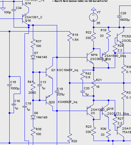

reduced loop gain in the complementary triples
Add degeneration resistors to Q18 and Q19 as mentioned by john_ellis and Douglas Self. Circuit attached.
The output inductor can be left out if a 0.2 ohm 5W wire wound resistor is used instead. And if a troublesome cable cause oscillation then add another 0.2 ohm at the output terminal. See plot with 0.2 ohms -- no ringing with no inductor.
I haven't optimized R18, R22, R37 combination (and lower half R's). There may be slightly better values.

There seems to be a problem with this on 1kHz sine input when asked to output c. 60 volts peak to peak in my simulation I get THD of 1%.
I think R18 should be a lot lower in value - in the order of a few Ohms.
I have changed two resistor values in each driver half of the attached simulation - at 1kHz contrary to the file title. THD is reduced to 0.00026%.
I have not checked at 20k sine or square wave.
Optimizing degeneration of the output triple
Optimizing R18 (=R36) degeneration of the triple worked best for me. Adding a resistor in the emitter of the first transistor "NPN" didn't help in this case (although other times it has helped me).
Changing R18 (=R36) also changes the idle current so R37(=R38) and R22 (=R23) need to change to get back to the original idle current (which was 308mA is the circuit prior to y post).
I originally started with R22 (=R23) of 330 ohms rather than the original 150 ohms and then changed R37 (=R38) to get the original 300mA idle current, that's after trying different R18 (=R36) values until I damped out
oscillation (and most of the ringing) while using a small value of R17 (the output series resistor in place of the L//R network). Then I stepped CV load capacitor to see which values caused the most ringing.
A recommended approach:
After discovering the worst ringing is with CV fixed at 100nF and R22 & R23 can be fixed 150 ohms as original.
Also R17 (output R) can be set at 1m (effectively zero). Monitor Vfb output prior to R17.
We have now reduced the number of variables to one for no ringing, being R18 & R36. See below R18 & R36 stepped 22, 33, 47 ohms. Ringing with 22R. 47R chosen.
Once the ringing is stopped then R37 & R38 are trimmed for idle current. 120 ohms used.
Then add R17. EG check 0.1 ohms with all CV range.
Bench tests are needed to finalize values for R18 & R36 due to neglected model and board wiring effects. It may require twice the simulated minimum value for R17 and or slight increase in R18 & R36 etc.
Epilogue: After optimizing the clip recovery was checked. It was noticed that there was a low level HF oscillation that started in the -25V to -15V output voltage range. Note the positive side does not oscillate, only the negative half of the output waveform in a certain voltage range. First I tried changing R18 & R36 degeneration as above for both sides did not stop this oscillation, nor did changing R36 only for the negative side.
This oscillation was stopped by increasing the base stopper resistors R27,R28,R29 on the negative side.
Plots and sim circuits for the negative side problem are in a following post.
Could you please advise how to optimize them? What values can be better?
Optimizing negative side base stopper resistors to stop HF osc
As mentioned in the post above on optimizing the degeneration resistors for the triples I checked clip recovery.
I first tried changing R18 & R36 degeneration as above for both sides but this did not stop this oscillation, nor did changing R36 only for the negative side.
Base resistors R27,R28,R29 were increased to 5R6 (originally 2R2 like the upper half).
Also, to keep R27,R28,R29 to a minimum the value of resistor R42 (in series with C20) was increased to 5R6 (originally 0.8 ohms). This stopped the oscillations on the negative side for all output voltages and CV values.
BTW capacitor C20 couples the bases of the power transistors and increasing R42 in series with C20 seems to decouple a troublesome and unexpected HF circulation path between the upper and lower transistors.
A plot with a 3Vpk 20kHz sinewave clipping shows clip recovery is clear of ringing. Nice.
However, a weak HF oscillation between -25V and -15V (last part of sinewave) can be seen in a zoom below. Here the base resistors are stepped on the negative side only from 5R6 to 2R2 (original value)
The oscillation is with 2R2 base resistors (blue) and no oscillation with 5R6 (green). Other values used are R18=47R, R19=150R, R37=120R, R17=0.22, and upper base stoppers are still 2R2. The sim file is supplied.
How to optimize R42:
First optimze the degeneration resistors (as covered in the other post) to get one side free of oscillation for any CV loading with the output series resistor.
Use a simewave that clips so you can cover the full output range.
Step Rb for the the negative side base resistors working backwards eg 6R8 5R6 4R7 3R3 2R2. Watch which step causes the simulation to crawl when it breaks into oscillation. Stop the simulation and increase R42 eg 0.8R originally to say 10 ohms.
ReRun. If all the steps are clear of oscillation reduce R42.
If it oscillates at one of the steps then try a higher value of R42 until there is no change in the step it oscillates -- so choose a the value of R42 one or two steps higher than the one it oscillates at.
Fix Rx at this value (disable the Step command for Rx).
Reduce R42 until oscillation starts again and then use say double that minimum value. I found R42 could be 5R6 and Rb (R27,R28,R29) is also 5R6 (coincidence?)
...Plots and sim circuits for the negative side problem are in a following post.

Oops
Yes, I got the same 1% with my (high) degeneration value and with my base stopper mods as well.
But with your mods it does oscillate at 20kHz.
So I tried my base stopper mods and my C20's series R42 with your degeneration resistor of 2.2 ohms etc and it now works good -- no oscillation with 20kHz and low 0.00026% distortion at 1kHz 60Vpp 🙂.
So my post on optimizing the degeneration resistor must have given a local optimum and not the the global optimum. 😱
Rather than step 22 ohms and above it needs to step from an ohm and above. But what prevented me from doing this was another oscillation coming from the negative half, which it seems, needed to be cured first before the degeneration could be optimized.
So team work has done it, but not in a linear way.
Thanks mjona!
Yes, it seems my optimum is not a good one for low distortion.There seems to be a problem with this on 1kHz sine input when asked to output c. 60 volts peak to peak in my simulation I get THD of 1%.
