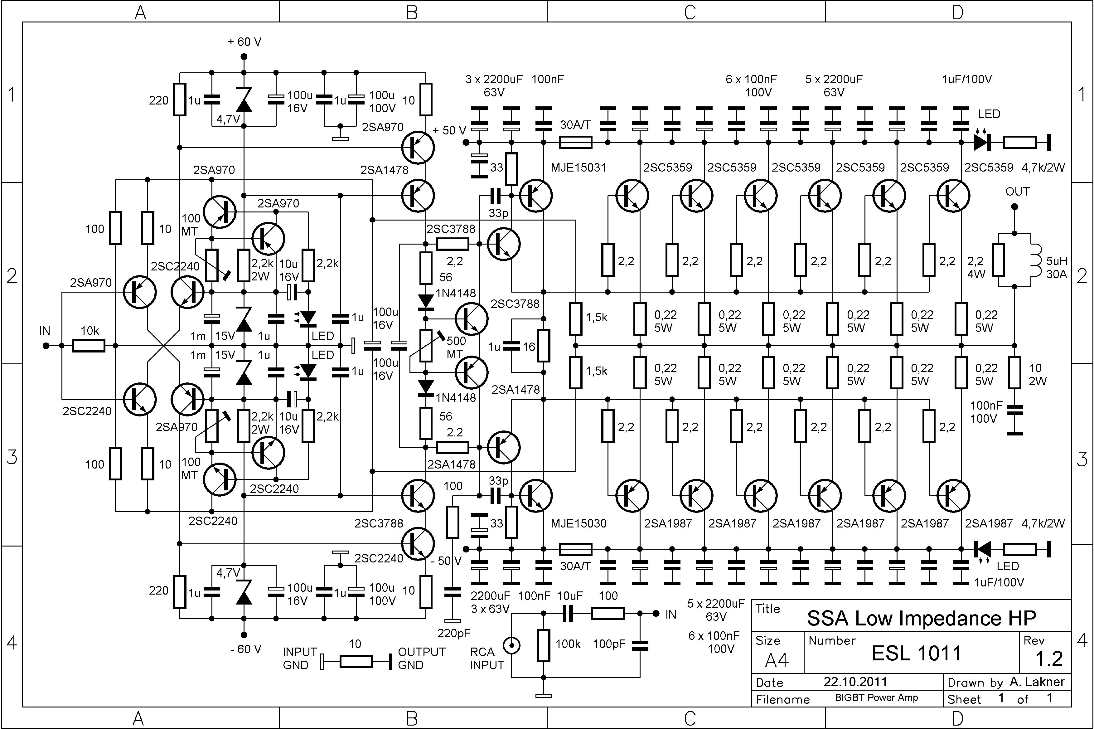

Don't you mean output capacitance or Cob of output transistors? They have 145pF and 240pF each.
I just copied the values of C20/R42 from other schematic, I thought it was for hf filtering. Please feel free to change any component think right.

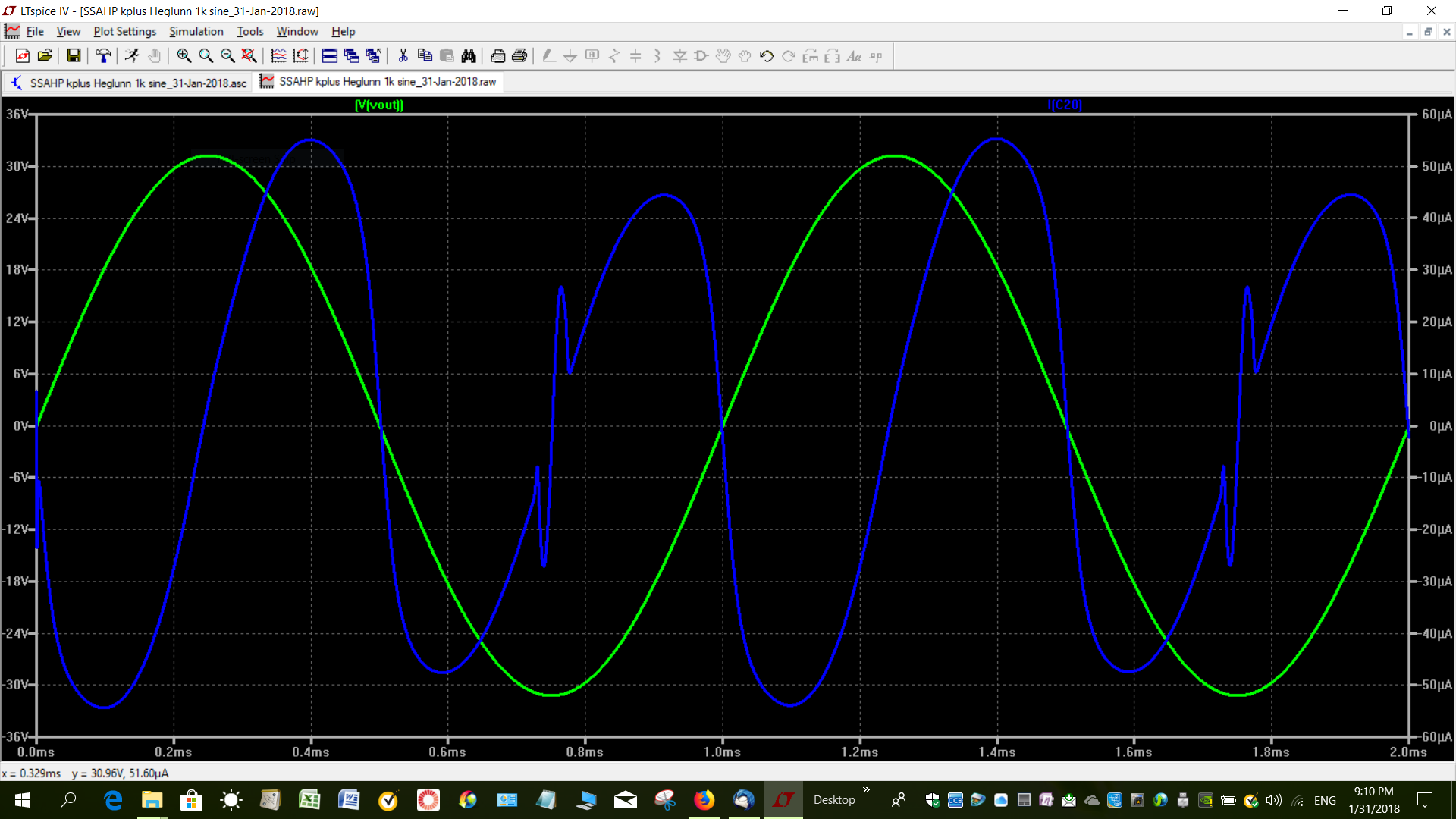

This picture shows there is a rift in the current wave form through C20
You will be pleased to know with the change in values mentioned in my previous post the current in the input cross LTP pairs is reduced to be in the order of 3.45 mA
I wrote this because after this change the whole compensation and schematic could be different than current one we are exploring. However I'm not sure if such higher bias current values is better or not compared to usual 3-4mA. Higher GBW isn't bad, it provides wider frequency responce, if it can be handled right. Perhaps there should be some sweet spot like with output bias current for minimal crossover distortion.
That looks like one of the transistors is hitting saturation, plot the base current of each transistor to see if there is a bump in the waveform at the crest.

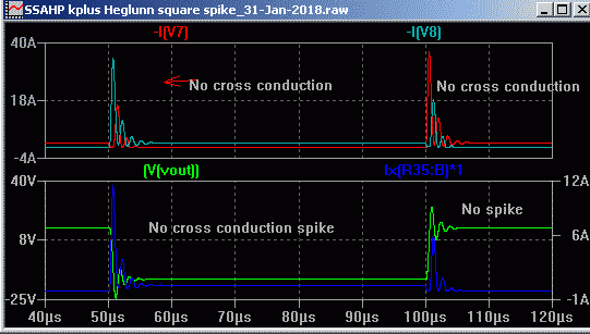

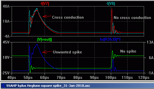

Hi mjona, keantoken,
Attached is the circuit set so it generates a cross-conduction spike.
Settings are R44/R46 2R, Ls 100n, R37/R38 30R (for near original idle current).
The rising edge (right 100us) does not have any cross-conduction.
The falling edge (left 50us) has nearly 40A of cross-conduction at the peak.
Next break R42/C20 link and re-run with all other values the same, gives no cross conduction spike
showing it is current through R42/C20 that can cause this unwanted cross-conduction under certain conditions.

Why a CFP triple needs degeneration resistors and not caps
In a simulation you should step the inductance to find how high it can go before it loses stability and then design for half that value so you have a 'safety factor' -- which often gets swallowed up by unaccounted for inductances or random variations in parts.
I agree a 'Capacitor is the main tool for compensation' -- in your circuit C34,C35 (100pF) provide the primary compensation to obtain the gain and phase margin which can be done using the 'AC' simulation.
However, there can be hidden instabilities due to Class-AB switching effects, as in this case in the CFP driver. This is because the AC run only plots at the idle current operating point and doesn't consider changes in gain and capacitances and FT over the whole operating current and voltage range.
This is the cause of the difficulty. So we need to make the CFP driver less nonlinear and this is best done with degeneration resistor in the emitter of the first transistor and another in the second complementary transistor (Q18,Q19).
BTW the CFP is usually inherently stable when operated in Class-A; it's a winner in Class-A as Douglas Self showed many years ago in his book. This is because in Class-A the transistors don't turn off. Unfortunately, I don't know of a simple way to modify this type of output stage to keep the CFP driver transistors conducting slightly when one side turns off in Class-AB. The FT of the CFP and the power transistors plummet when they turn off in Class-AB which means extra compensation and extra degeneration is needed to stabilize this CFP triple output stage over the full range of CV loads, currents and voltages.
The value of 50nH that I was using for my simulation shows that it can be made stable even with relatively high inductances. Bear in mind there is 20nH per inch of interconnections including the power transistor emitter lead and bond wires and then to the output summing node....The output emitter resistors I'm using have <5nH. They are cheap, small and affordable. Why we have to use inferior parts? Or you set this value for wirewound resistors to omit output inductor?

Cbe is the capacitance of the base-emitter junction. For output transistors it is usually very large compared to Cob.
I think the Cbe you are referring to is the junction capacitance when the output transistor is off. The Cbe in the hybrid pi model is much higher when the transistor is turned on, due to its ft. In the hybrid pi model, C_pi = gm/(2pi * ft). gm is pretty high when the transistor is on. Of course, all of this is only a small-signal approximation.

A sawtooth pattern is normal for this cap when operating in full class AB at medium or high power.
C20 is 1uF in my simulation at 1kHz the sawtooth current hardly registers 0.06 mA. The waveform transforms to a spike of 770 mA at 20kHz.
The sawtooth shape loses it's form if the value of the cap is increased - peakier higher in magnitude - not a good look.
The value can be reduced but I have kept it to 1uF due to the slightly better shape given with square wave tests. Perhaps a matter of smoothing over something that could be better optimized in my simulation.

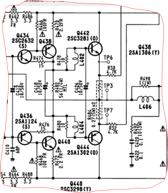

I notice some changes in the driver stage. For what it is worth I have seen stages like the original one on the thread - see attached.
I have looked on this as an exercise as developing a workable prototype so I have restricted my changes to component values with a couple of deletions.
I have noted the points made by Bob Cordell about circuit board layout so a re-work may be on the cards in which case the extra information may be relevant.
