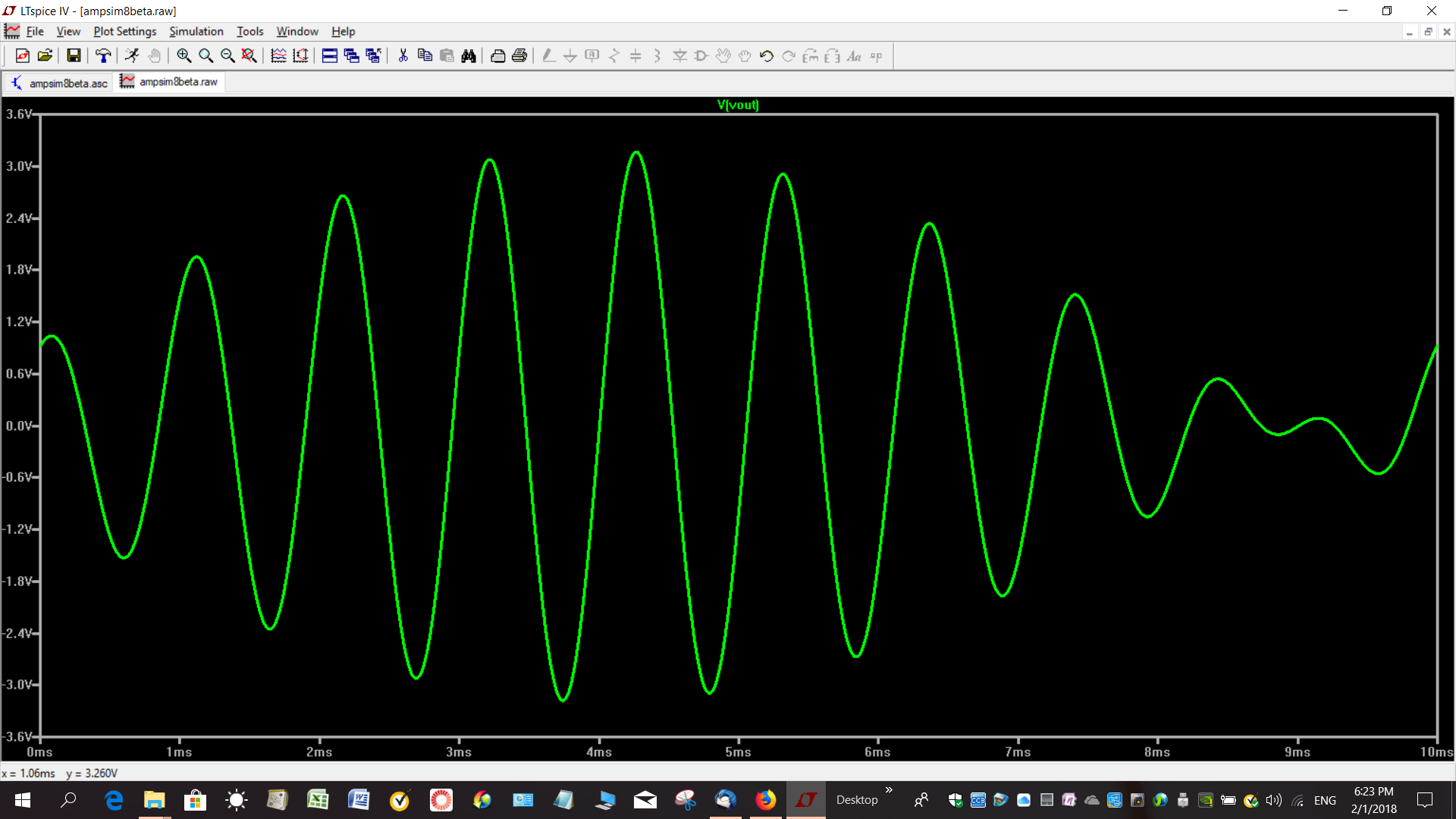

I would continue to work on, but I don't know how to do all of these in LTSpice. The only simple mode works for me is 1K sine wave test). There is also no any usefull video on Youtube how to simulate amplifier in LTSpice

Here is a rig I made which can do square, sawtooth, sine and sine burst input as well as OLG measurement. It may be hard to use in LTSpiceXVII due to interface changes though...

It looks normal but the FFT looks cleaner and the THD into 4R is 0.000000%. I must be missing a trick here - I don't think this is right.
In the test set up I have been using the result into 4R// a variety of test caps ranging from 1nF to 2u2 is between 0.000114-0.000118% bracketed figures 0.000174-0.00185%.

The first .four result is an FFT of the input voltage, just to make sure your input is clean. Second result is output THD. Third result is THD with only the first 4 harmonics. In theory these harmonics are the most benign, so if your first THD result is much higher than the 4-harmonic THD, then you have a lot of high order harmonics and this is supposed to be bad. But you should make up your own mind, this is not supposed to replace a listening test.
If that is error log stuff everything is zero across the board in your test rig until the last reading of the four which comes out at 0.000272% bracketed figure 0.000312%.
The FFT of the circuit using Bob Cordell's test method at 20 Volts peak has high order harmonics between 10-20k that I don't like - the worst of them is - 96dB.

I have tweaked the circuit a bit - reducing some values C34 and C35 (Vas) C14,C17,C5, and R18 (Output).
In a square wave tests I look at R20 ahead of the coil and the indications are the circuit is stable with a 4 ohm load and wide range of parallel test caps.
Unrealistically I have left them in the sine wave simulation attached - looking to see what is not to like there - even though in reality the load will be removed to the end of a length of speaker cable once any delay relay kicks in. You can delete the capacitors if that is more appropriate.
I modeled the emitter resistors as inductors with resistance of 0.47 ohms.
The odd values for the resistors in the output zobel are parallel combinations of low wattage film 0.6W types e.g. R18 is 5 off// 51 ohms.
For me this is a paper design so if the place for my simulation is the waste paper basket you can be blunt about it.
A couple of minor changes to reduce dc offset R14 and R15 reduce from 10 ohms to 8.2 ohms. R37 and R38 reduce from 43 ohms to 39 ohms.
