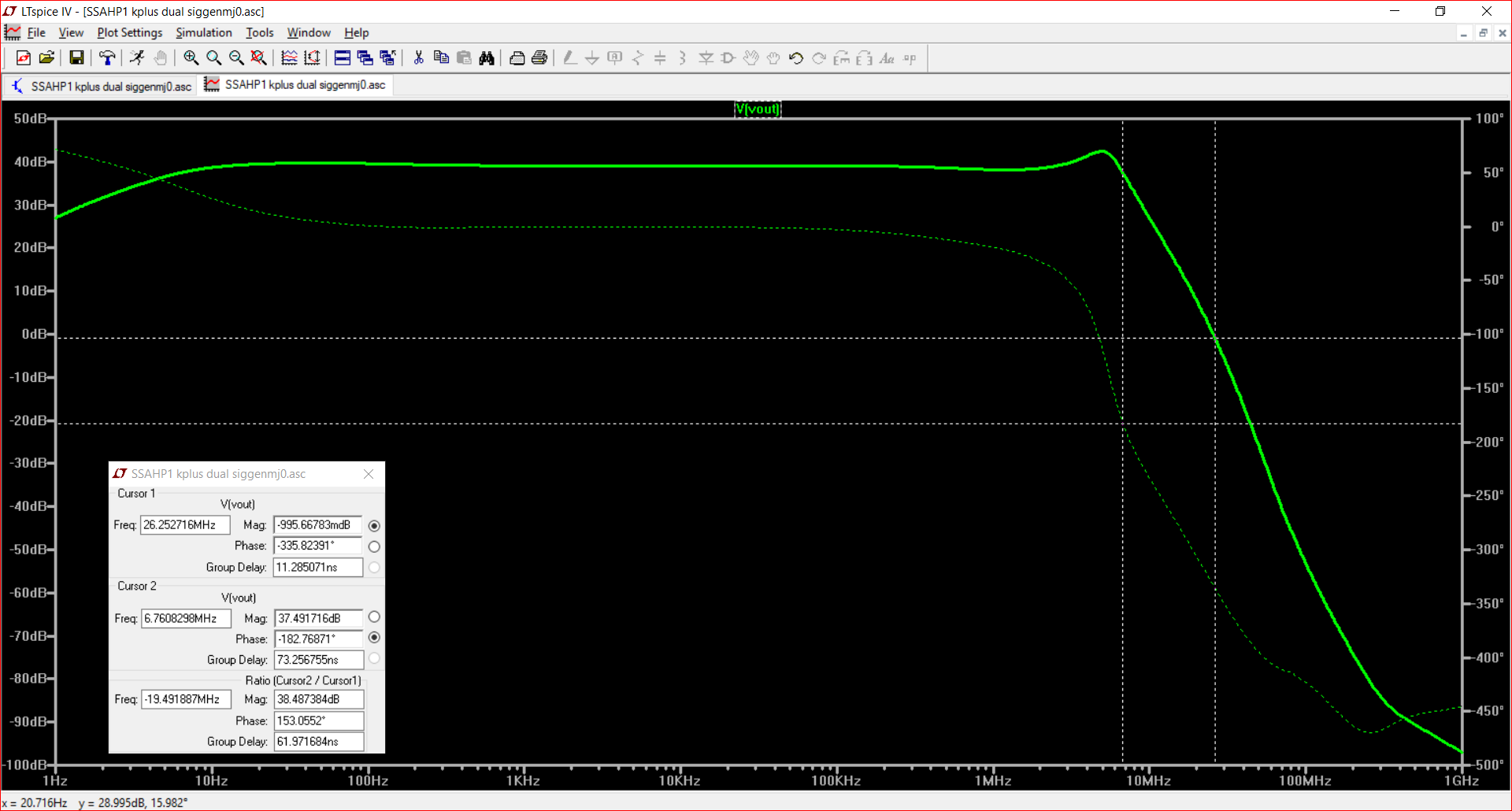

Intent is to make working this CFA schematic without oscillations, preferably with balanced input
I tried the the circuit on LTspice and was impressed, although I didn't get insights about stabilizing it. I think I will try inputting a square wave because the output of the 1kHz sine wave was very clean. Maybe a square wave would tickle any instability that might be present.

A Bode plot shows this latest circuit to be seriously unstable. At the frequency where phase reaches -180 degrees gain attenuation is practically nil.
Thanks for that insight. That leads me to lean heavily in favor of the Cdom method.
I forgot to say this is representative of the circuit with an 8R test load - albeit this was missing in what we have been given to work with.
We might tend to forget that a speaker voice coil has a small inductance in series with the coil resistance.
