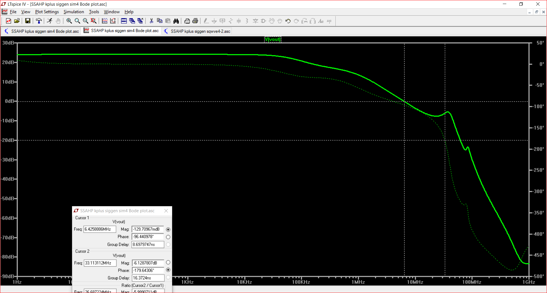

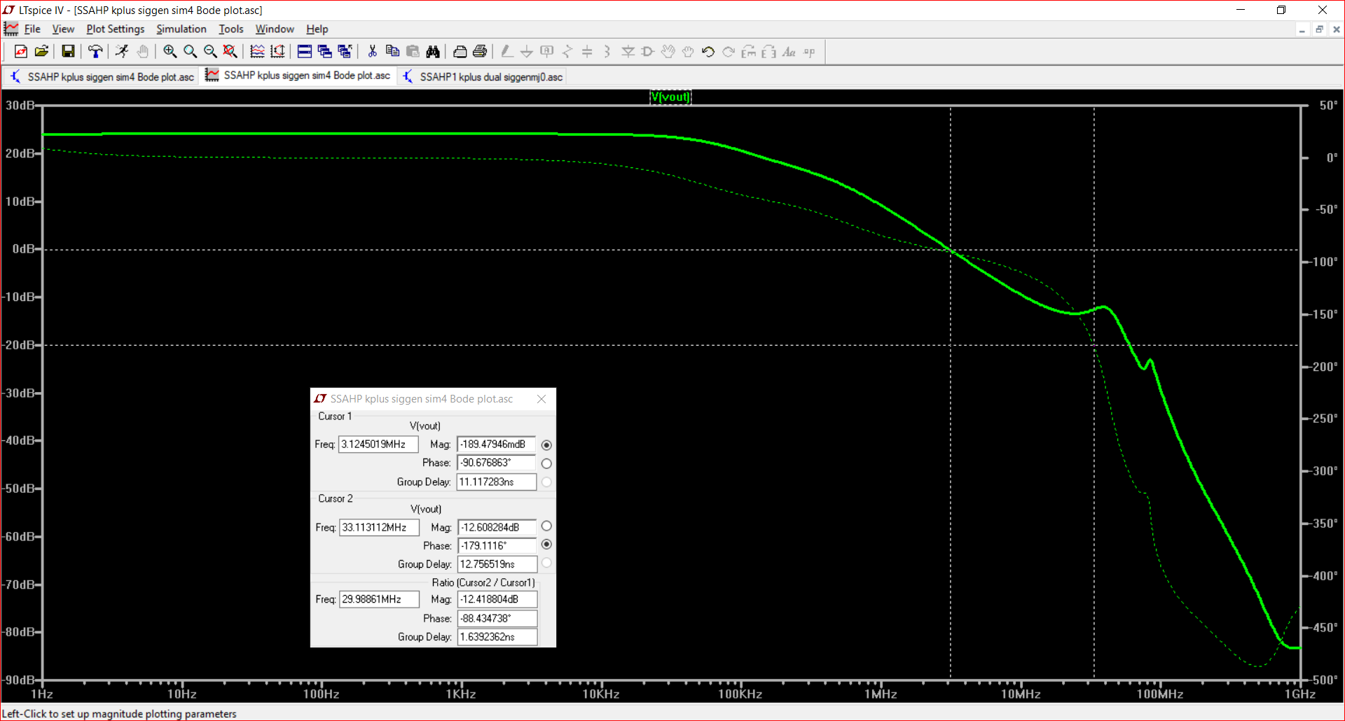

I did a simulation I thought solved the stability issues in this circuit a couple of months ago. I was undecided about posting it then and forgot about it since the interest went quiet.
I have done a Bode simulation which is now attached.
I am hesitant to post the .asc file as the emitter resistor values I see as problematic.

That is a very good point.
I used 200 pf in my original version of this simulation (for square wave into 8R//2uF Quad 63 load) but cut this down to 100 pf - the same value you suggested.
These - C36 and C38 are connected respectively between collector Q18 and base Q14 and collector Q17 and base Q16.
For some subscribers high frequency performance is the holy grail and they would be unimpressed with the result attached.
