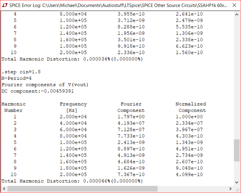

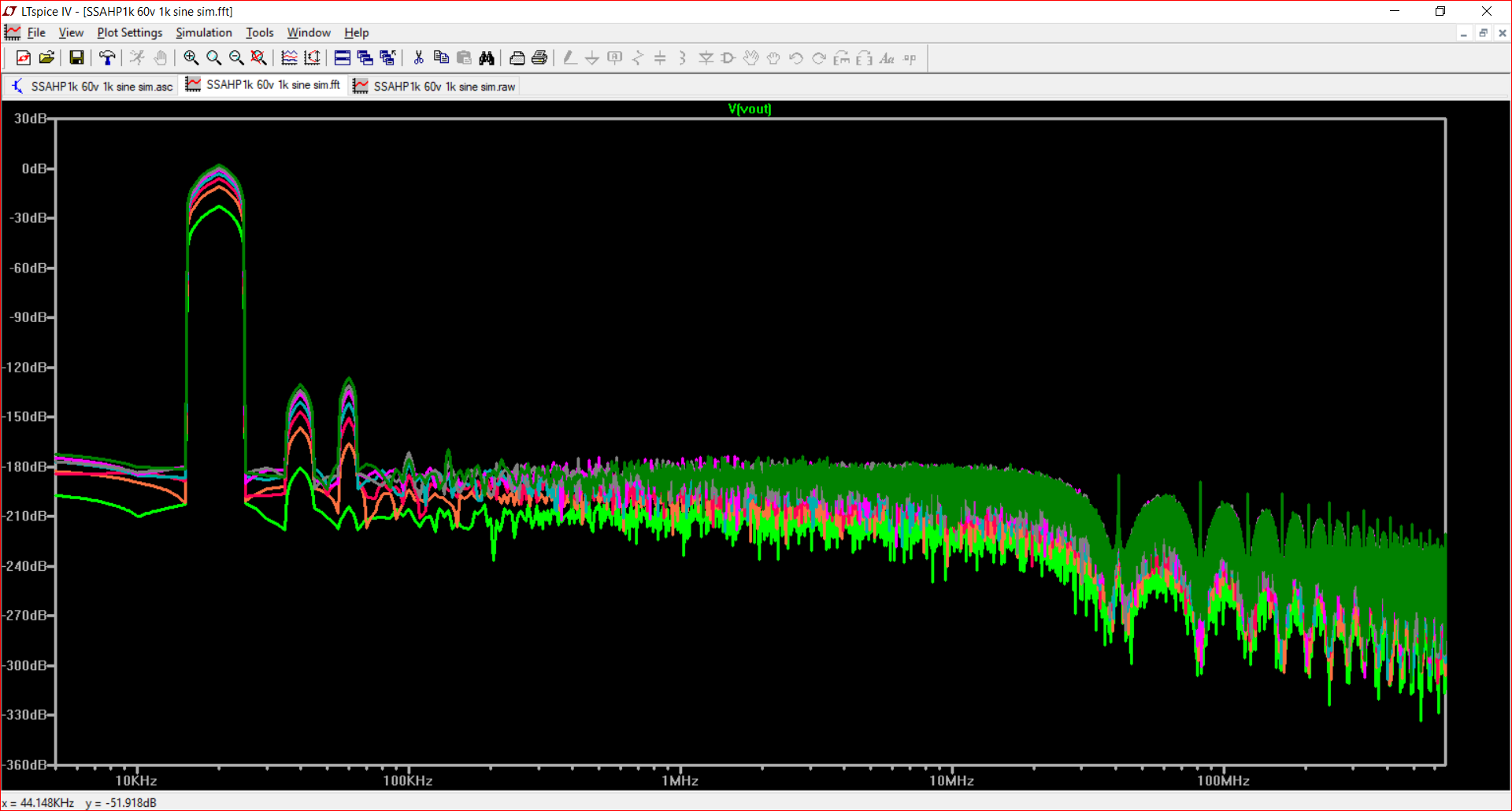

I have measured the THD accordingly and attached the fft and some of the distortion results - practically non-extant with 40 volt rails. The buffer transistors are high voltage and the dissipation in the transistors is about 150 mW which is well within their ratings.

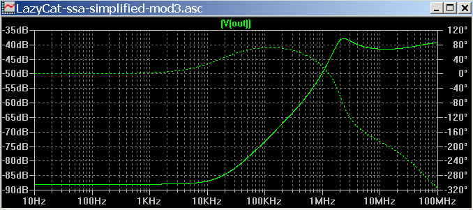

CFA input stage with true differential inputs using Rush pairs
There is a discrete full complementary symmetry buffer feeding the alternative input since the input impedance at that point is low.

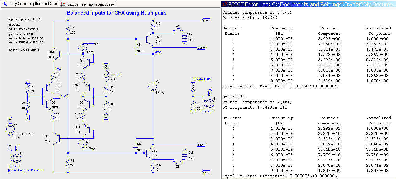

The attached circuit shows a way to get true differential inputs using Rush pairs.
The discrete buffer is not required since the standard 4R differential opamp arrangement can be used for high CMRR.
The 4R diff amp assumes input sources are low resistance which is usually the case.
Plot below has +In and -In connected together.
Rush pairs can reduce the input offset voltage and currents when all the PNP's are the same batch and likewise the NPN's.
They are a variant of the LTP differential amp and can be thought of as an unfolded LTP, but does not need a tail source like the LTP.
The 10 ohm resistor between the two emitters of each Rush pair provides emitter degeneration just like the LTP.
To get ~10k input resistance on the inverting input then you can make R19 a T network to keep the feedback resistances low (~1k5).

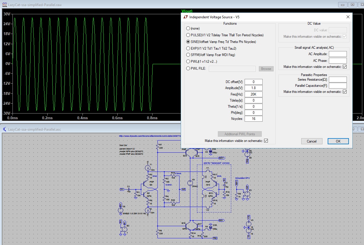

I tried to change input frequency in my sine wave sim from 1K to 20K, but it doesn't work that way.

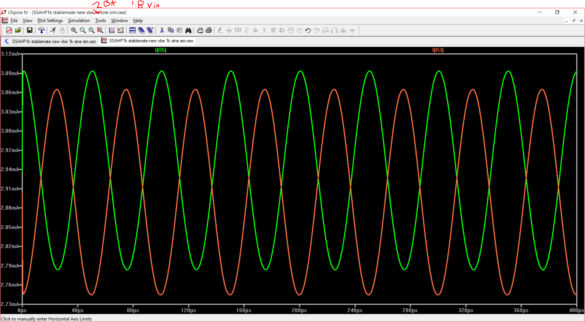

The purpose of emitter resistors is to inject a negative feedback voltage into the emitter to counter the voltage drop due to the element of series resistance (r'e) in the emitter diode.
With emitter resistor values of 0R1 that will be 260 mA at room temperature nominally 25 degrees C where r'e is 26 mV.
With three pairs of output transistors that will be 780 mA which will generate a lot of heat even with 50 volt supply rails.
If there is a rise in the transistor temperatures - for every 11 degrees C increase you can expect the conduction to double.
If you run the circuit at a lower current with 0R1 then the balance between the forward conduction diode voltage drop and that of the emitter will be out of check like moving the pivot point of a see-saw one way.
To quantify that, if you set your iq to 120 mA per transistor to match my setting the emitter resistor drop will be a mere 12 mV i.e. not congruent with 26mV in a push-pull sense.

No, if the settings are correct the output stage THD for20kHz is 0.0082%; The input figure is 0.000726%
The way I measured the input voltage was to move the vout label temporarily to the bottom of R3.

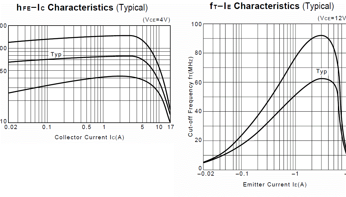

Multi-emitter and ring-emitter power BJT specify the maximum fT. fT changes with collector current. It can be that a "high fT" power BJT has fT 30 MHz at Ic 2 amps but 100kHz at ic= 50 mA and ft 100 kHz at ic 8 amps. This holds also for base drive impedance close to zero. Makes compensation difficult . The original single diffused 2N3055 was rather easy to handle in terms of compensation as fT hardly varies with collector current
The characteristics or functions hfe(Ie) and ft(ie) are typical for power BJT with multi-emitter or ring emitter.

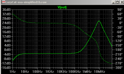

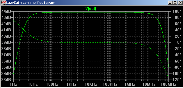

The attached circuit "1a" shows the AC plot when the second input "In-" is fed with an inverted signal wrt to the first input "Vin+". The gain reads 43dB in closed loop. (You would expect to feed an inverted signal to this input since it is marked "In-" in the original circuit by Lazy Cat).
Now open all the links to isolate the add-on parts to the 2nd input and the gain becomes 23dB. it's a huge difference in gain! You would expect the 2nd input to only add 6dB higher (double) with the second input added. So the second stage doesn't do what we expect it should.
The reason we can get this amp to "work" with the second input "In-" fed by the same noninverted signal is the gain is then 22.5dB in closed loop -- which is the same as that of the single input! So effectively the second input stage is "in neutral" and not contributing any gain. Which means it is could be removed since it works just as well without it provided both inputs are fed by the same signal. And it is a simpler circuit without the second input.
The second input is labelled as "Vin-", but it doesn't work as an inverting input, at least not over the voltage range that we want to use it for.

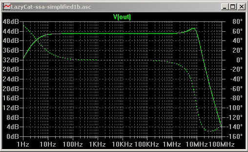

To show this I attached circuit "1b". It has 1k7 input attenuator added to the first input. Feeding with both inputs in phase we get -4dB (plot attached) and +43dB with the inputs out of phase.
So we now have differential inputs? ... Yes and no. A .trans run shows the differential action only takes place for the first 10mV of the input signal range with gross distortion over most of the input signal range. So the second input stage doesn't do what we want.
And I can't find any simple way to modify the circuit to make it work with differential inputs over the full input voltage range of 1 or 2 volts. None of the suggested ideas work as differential inputs with the second input is driven with an inverted signal. Feeding the second input with a noninverted signal as mentioned) does not give the amp a balanced input at all.

The alternative input stage I have suggested could be used on your present PCB. It requires 4 extra transistors for the input stage.
Each of the input transistors Q2,Q3 will have Rush pairs and then there is the diode string of 4 biasing transistors which could go a a small matrix board.
Q6,Q7,Q8,Q9 reamain as current sources but different values for R8,R9. cascodes Q4,Q5,Q10,Q11 remain the same.
Compensation should be almost the same.
BTW I left the ccs and cascodes off my demo circuit because I was using the simplified form to demonstrate that it works and can give you differential inputs.
