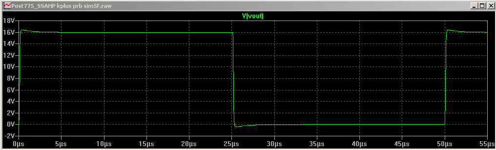

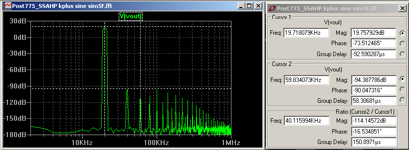

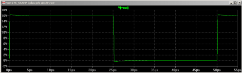

Thanks Damir. Some progress on SSAHP sims with OITPC.
Sim 5E plots attached: PM 92 degree, GM 16dB.
It now gives negligible squarewave overshoot, and THD 3ppm at 20kHz 15Vpk.
AndriyOL, notice the new values -- I hope they work on your board this time. Lag capacitor (C3 in sim 5F) is the the critical one to get it stable in sims; too large and the THD at 20kHz rises. If it still oscillates with the new values try doubling C3 (or larger). All the best.

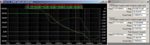

For sims I found I can step two values with the Tian probe using a second plot expression with @3 and @4 replacing @1 and @2 as below:
-1/(1-1/(2*(I(Vi)@3*V(x)@4-V(x)@3*I(Vi)@4)+V(x)@3+I(Vi)@4
This expression is on my sim 5F below the Tian .step line. Stepping can be seen in the attached "prb" plot; green is R44 15 ohms and red is 10 ohms. Check the ErrorLog for the stepping order: green is 1st, red 2nd.
Stepping in the Tian probe helps a lot to see what each C or R does to the GM and PM. Then you step C or R's with a squarewave to minimize ringing and overshoot. Then check CL with 5nF, 50nF, 1u. I used 500pF as the default for the initial OITP Tian set up.
And a thanks to Dave Zan. The Tian probe does need the output feedback capacitor (C5) after the voltage source as you suggested to get correct results with OITPC. It made all the difference for optimizing for a high PM!
