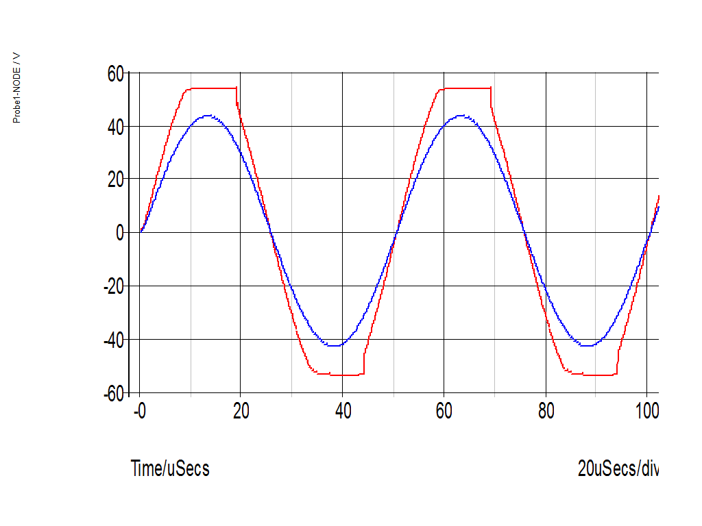

Here is a simulation (sorry for the poor quality) of my 100W design using global feedback compensation at just over 100W and clipping as simulated. 100W distortion at 20kHz is 0.0016%. Still to be build and verified, however, the previous version achieved 0.003% at 20kHz, measured. (FET means FET input stage.)

Miller compensation I'm using is not robust enough than to maintain stability. What do you think LC is using in FO modules to stabilize such amps?

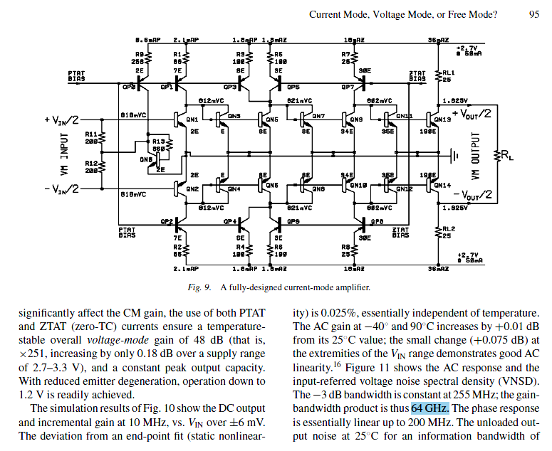

Hi Eva,
Thanks for pointing this out. But did you mean 100GHz GBW? I read a paper by Barrie Gilbert where he mentions 64GHz GBW for a 2 stage CFA with feedback (using a 25GHz process) here at p95. Copy of p95 attached.
Your point about dropping one 'half' of the LTP in a CFA to "eliminate" phase shift from IN- is a very significant step for audio power amplifiers.

Hi Eva,
...The whole point of current feedback inputs seems largely misunderstood in audio. Where is the extra "speed" coming from? It comes from eliminating one gain element from the feedback path, so propagation delay and phase shift are reduced, allowing for highest GBW for a choice of part types.
In high speed current-feedback op-amp design (where state of the art of linear amplification is currently expressed, not so much in audio), typically IN- input current goes straight (through input transistors acting as cascodes) to drive VAS. LTP phase shift and delay are eliminated from IN-. This can represent an improvement of 33%, as in 3 gain stages becoming 2 (counting output stage as 1 gain stage). These op-amps are available with GBW of over 100Mhz, made with transistors exhibiting unity gain FT as high as 8Ghz. These op-amps are often used for video signals.

EF2 derivative of the Lazy Cat circuit.
The voltage gain parts of this circuit are weighed down by having three sets of output power devices - the greatest capacitance in a power transistor is that between the base and emitter which with three sets is a liability.
The bandwidth of individual output devices holds up to 3-4 amperes which is adequate for a power output of around 40 watts into 8R. With fuse protection in the supply rails the current handling of a single output pair is adequate.
It is then easier to devise a layout where the half wave currents cancel than with multiple sets.
As far as THD with 30 volts peak sine output at 20 kHz into 8R and any parallel capacitor load of 100n or lower = < 0.0024 % this increases to 0.0153% with 2uF in parallel with 8R.
The equivalent simuation figures for the CFP drive with 3 output sets are <0.0124% and 0.0279%.
I have substituted some Cordell device models in place of a couple of others. The dot include statement on the schematic is linked to Cordell's website which provides some other models to choose if one wishes to test confirm or replace those originally provided.
In the EF2 the currents flowing through Q14 and Q16 have some spikes in the wave forms these are fed back to the inverting input via C34 and the amplifier output is clean.
I thought I should bring this to attention in view of some doubts recently expressed.
I have tried video op.amps in pre-amp stages that which I had was claimed to use Class B inputs - I am happy to take whatever does the job. This device did but my final choice was for an audio grade op.amp.
As a matter of contrast there are no spikes in Q14 and Q16 in the CFP drive circuit which uses Miller compensation.
See also the EF2 zobel capacitor currents where C6 equates to zero current thus zero volts.
In the EF2 I have added V4 which for this simulation represents a dc servo amplifier such as an LF351. I have some concerns about the low values of R4 and R6 being hard to set the dc offset alone and maintain this under dynamic conditions.
The EF3 simulation showed double the distortion of the EF2.
