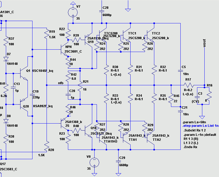

Subcircuit for inductive resitors
LTspice does not seem to allow 'Lser' parameter with a standard resistor so you have to use a subcircuit for now.
This requires a custom symbol I call "Rx.asy" (included in the zip file) and Rx subcircuit (already included on the circuit) which is:
The plot shows the effect of emitter resistor series inductance on the AC response as I(R35) which affects the 10MHz-50MHz region (see below). All 6 emitter resistors have inductance stepped 0n 5nH 100nH. Also R17 is stepped (same values) so the effect of resistor series inductance for R17 can be seen in the V(vout) plot.
A tip for using this subcircuit is the Ls parameter can be defined as a fixed value and then hidden from view to avoid clutter. Right click on the resistor and set L=<myvalue> and to hide it double click the 'X' in the Vis column. You can tell which resistors are subcircuits because the use "R=0.2".
Another tip is when first placing the subcircuit resistor you change it from U1 to R<#> where # is the next available resistor number (which you find by adding a standard R then deleting it). After setting the first subcircuit resistor number then the next are automatic when you use F6 to copy the last one.

The attached circuit has inductive emitter resistors as a subcircuit.I'm using vishay wsh as emitter resistors in output stage. These are low inductance parts.
Is it possible to set inductance value for resistors in simulation?

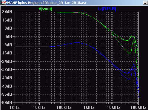

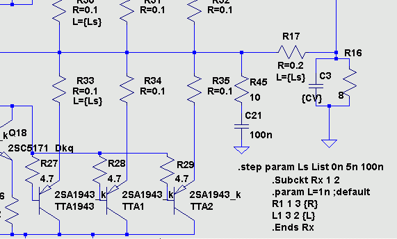

<snip>

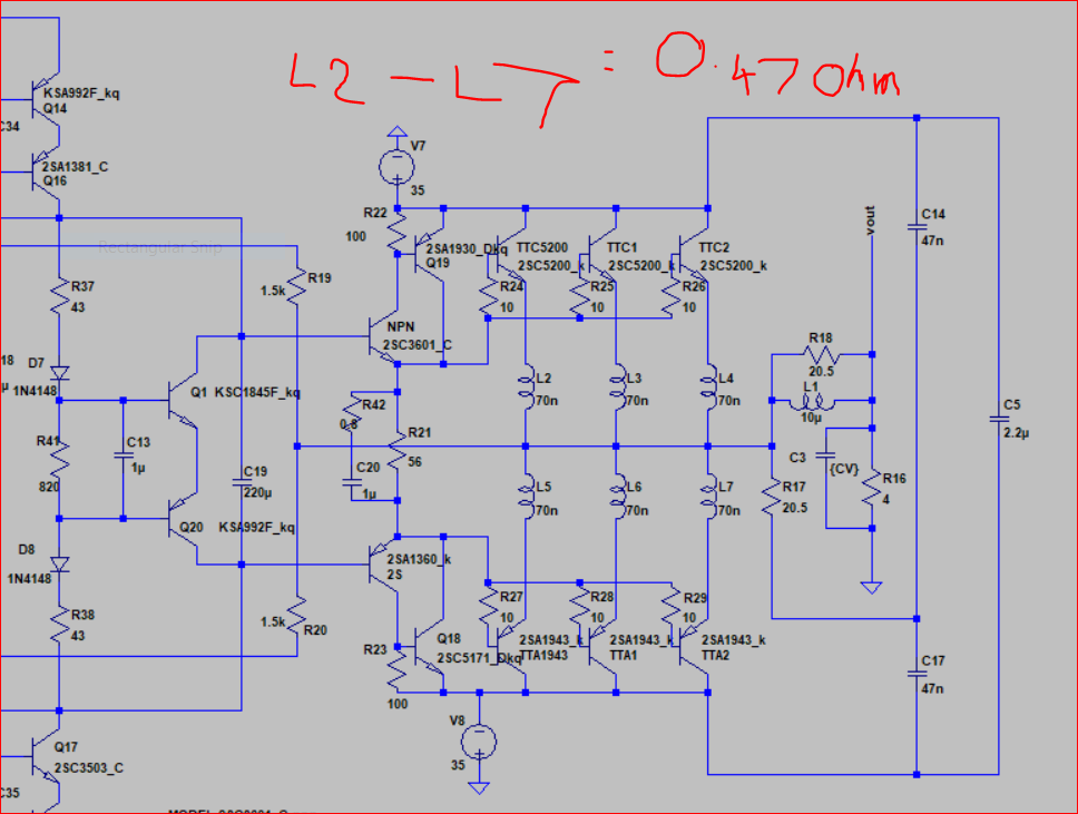

Thanks for this information. The only information I could find about inductance values in wire-wound resistors was a lot higher than those in the extract of Cordell's book.
The value of 70nH for an emitter value of 0.5 ohms matches closely to one of the values I considered previously in a simulation i.e. 0.47 ohms.
I took a short cut by replacing the emitter resistors in my simulation with inductors having a value of 0.47 ohms to see where this led.
As far as 10 kHz square wave testing is concerned the inductance limits the peak output somewhat which is not surprising since this involves a bandwidth reaching into the MHz domain.
I was not able to run this test on your latest simulation as an error message came up.
I explored the idea of replacing the output coil I had used with a buffer resistor of 220m allowing for some inductance.
While this buffer and the zobel network maybe outside the feedback loop these still connect to the inverting signal input via the route from the output via the feedback resistors.
My argument is inverting inputs are summing points. A portion of a signal fed back from a speaker will flow through the zobel network to earth - since this is an ac form the disturbance caused will generate a signal from earth back to the summing point.
Since inductance alters phase it is easy to set up an arrangement between these two signal arms which does not help stability.

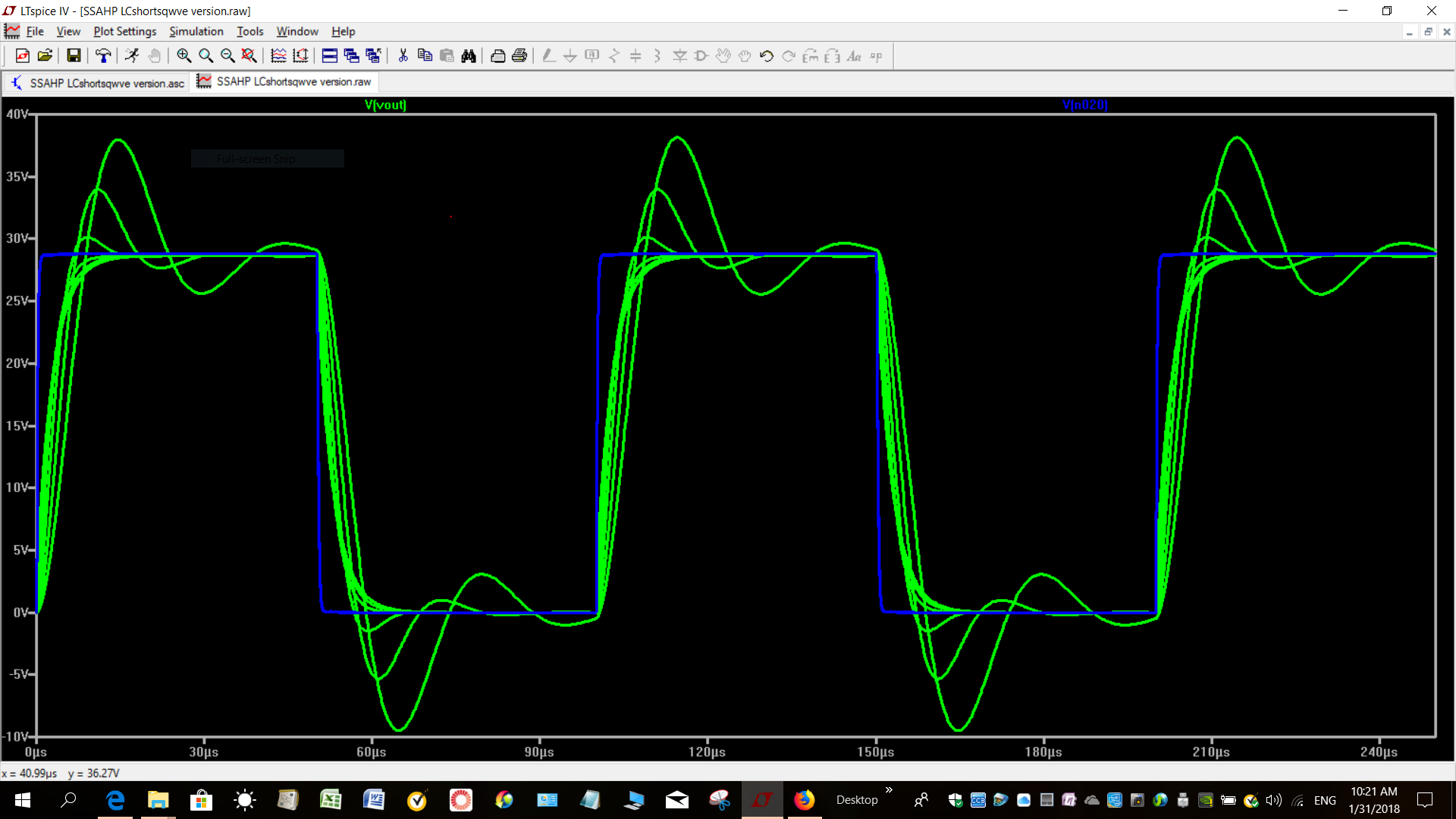

If you would test your circuit with a 10kHz square wave signal with the settings PULSE(-0.9 0.9 0 100n 100n 50us 100us 8) see what your result is.
...I was not able to run this test on your latest simulation as an error message came up.
Yes, the problem is the line .step param Ls List 0n 5n 100n
Strange, Ls=0n is OK for AC runs but not .trans. A bug maybe?
Change it to
.step param Ls List 1n 5n 100n
...or better still .step param Ls List 1n 10n 50n
...If you would test your circuit with a 10kHz square wave signal with the settings PULSE(-0.9 0.9 0 100n 100n 50us 100us 8) see what your result is.
I tried that and noticed the massive current (2A peak) transient sent through the Zobel ground via R45 and C21. This is a serious practical concern to keep the induced voltages in the ground return of the Zobel out of sensitive parts of the amp. I ran into this problem with my BiModal PCB recently and used a separate track for the Zobel return to the power common.

With this further degeneration for the CFP driver I returned to the original base resistors or 2R2 and 0.1 ohm emitter resistors and all seems to be well.
This latest combination is now stable at 1kHz and 20kHz sine, also with the fast rise squarewave and the full range of CV (Cout), and 50nH emitter resistors and 0.2 ohm +50nH output resistor. Sims are files attached. Idle current is reset to 300mA and distortion is 0.00035% at 1kHz and 60Vpp.
Bob, you suggested my 22 ohm Zobel is a bit too large. I use a slightly larger value (in simulations and actual bench versions) than normal to first get it stable and compensate the amp, then I reduce the value to the normal 10 ohms (as two 22 ohms in parallel) as a safety factor .
I have reservations about R42+C20 across R21 -- it sometimes allows a cross conduction condition where the power transistor current spikes unnecessarily and may cause secondary breakdown failure if the amplifier oscillates in the 100kHz to MHz range. I simulated with R42 as specified (0.8 ohms) as well as 5R6 and open and did not see a lot of benefit using it. You could leave it in for now to see how it goes with the latest mods on the bench and if there is any HF oscillation then open R42 to check if this is the reason. You may risk losing a set of power transistors by leaving it in, but then you won't ever know if there is really a problem in practice with it or not. It's your call.
The latest simulation mods below with the Zobel capacitor split and feeding back into the rails rather than the power common. Good idea mjona.
I also added further degeneration for the CFP driver, now in the emitter of the first and the base of the second transistor. The emitter degeneration of the second transistor has been discarded because the new combination seems to be better.
Without the emitter degeneration in the first transistor there was an oscillation at 1kHz but did not show any of the other tests, hence the need for this latest approach.
Thanks Bob.
Several posts ago, AndriyOL raised a point about the level of current in the front end of an earlier simulation using the component values that have been carried over into your latest version.
Consequently I increased the values of R8 and R 9 to 62.5 ohms and 60 ohms respectively - these values are responsible not only for the dc offset but also the current levels in Q16 and Q17 which will reduce to 8.5 mA with the changes - down from 45 mA.
This made a considerable difference in my simulation and suggest you try these values in yours.
