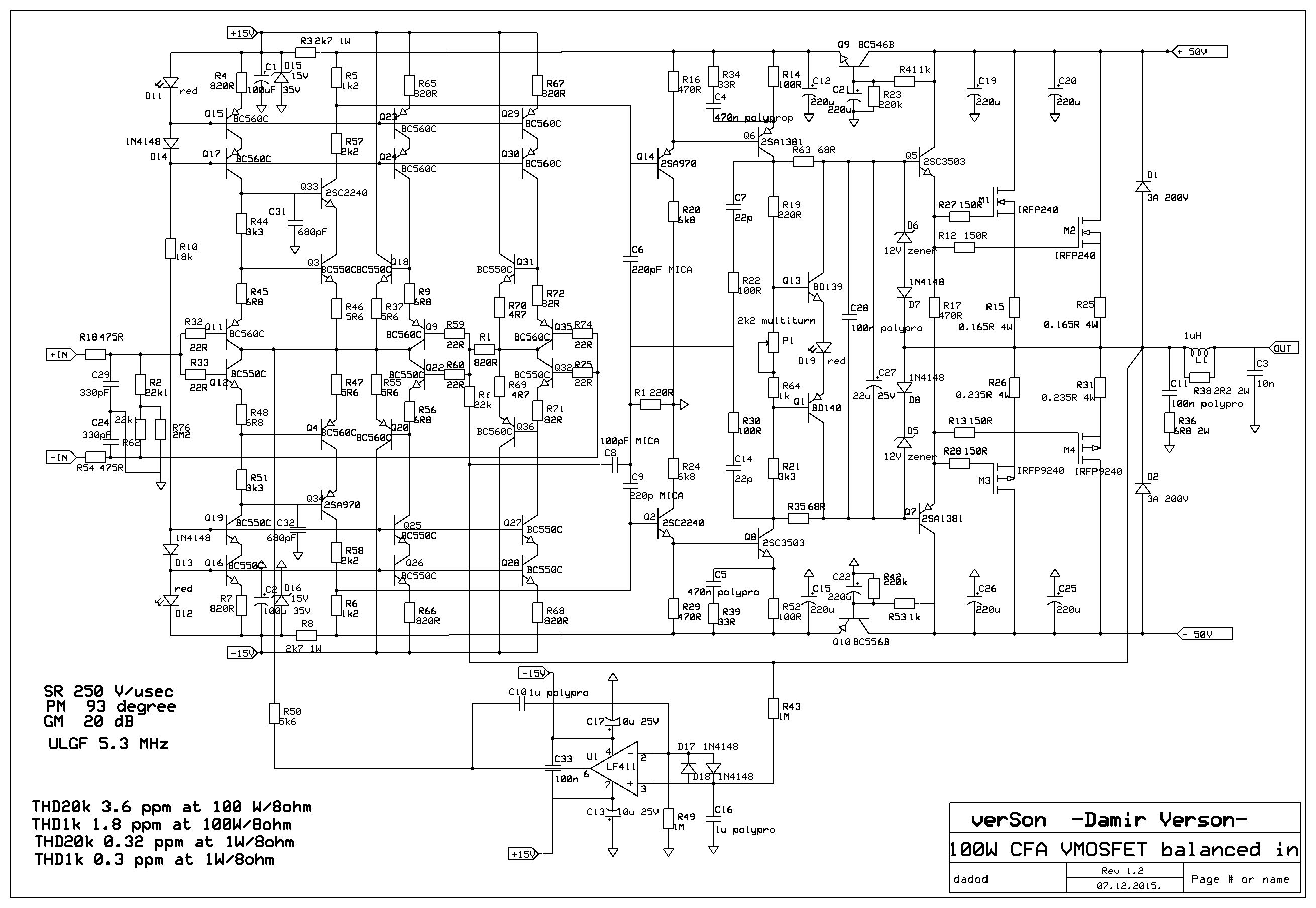

I would very like to have it working with balanced input, if someone on the forum could solve this gain issue, of course if it's possible without an offboard solution.

I have had a another think about this after a simulation of the circuit with the inverting input grounded - disappointingly the THD came out at 2% at 1kHz.
With a bit more time I have spotted that in the original simulation the signal to the inverting input is itself inverted.
With a balanced drive one input will already be inverted with respect to the other and so the signal feeds to the inverting and non-inverting amplifier inputs need to be in the same phase.
It is not clear whether or not you have a balanced drive from your preamplifier but as far as the simulation goes the inverting input signal symbol needs to be turned upside down.
With CFAs you need at least some kind of buffer for the negative input because you would be driving a 100 ohm resistor to the feedback network.
One way to get around this is to use an opamp to subtract differential inputs before going to the amp. So the amp remains SE. This way the opamp wouldn't need to be driving 100 ohms.

I planned to feed the differential signal from the DAC directly without preamp.
There is no any detailed info or schematics of discrete balanced or semi-balanced amplifiers, only with opamps.
This is original balanced input schematic http://www.diyaudio.com/forums/solid-state/193923-simple-symetrical-amplifier-85.html#post2715946

But the schematic you showed is equally complicated, and here you can see the missing buffer at the cold input (-).Thanks for your contribution, but it's too complicated for me.
Do you mean LF411 opamp? Could you please show how it can be implemented in the schematic I used?
He means the 4 transistor arrangement of Q31,Q32,Q35, and Q36.

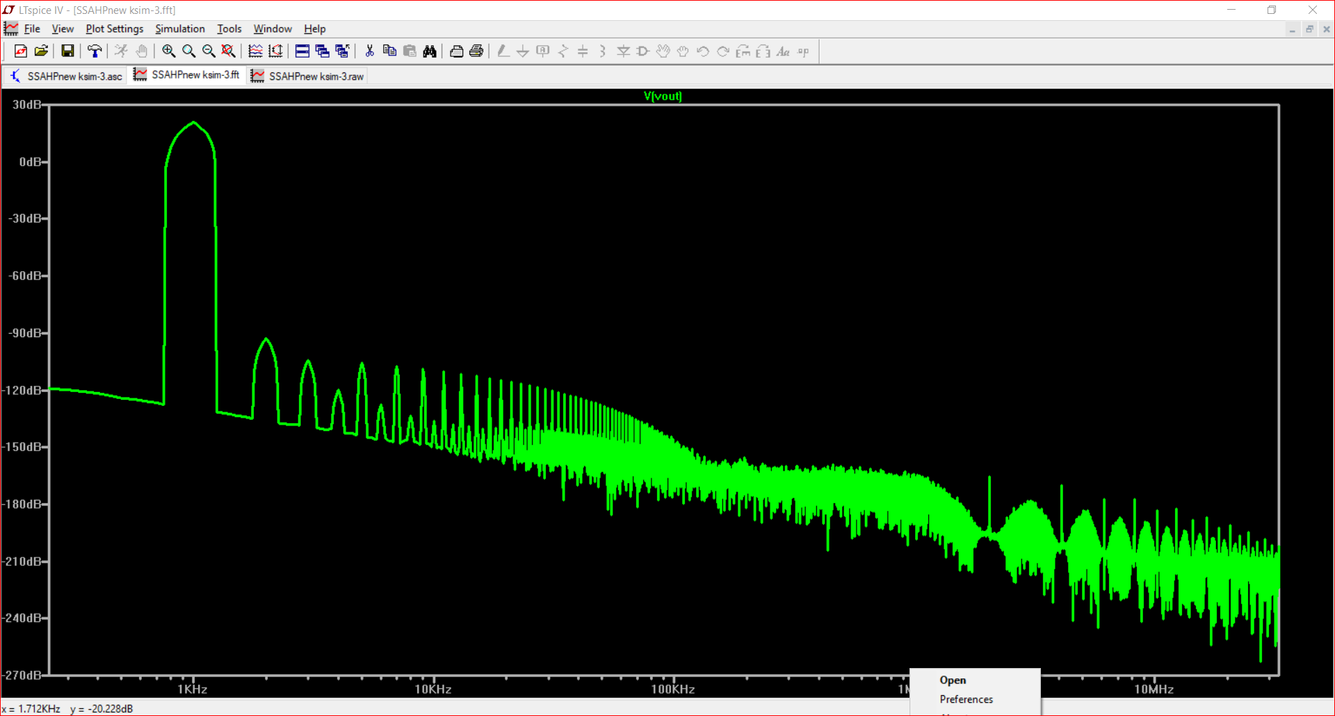

I have simulated the amplifier with a balanced signal input. Used that way it has very low distortion as can be seen from the attached FFT.
If your DAC lacks a volume control and or balanced inputs you will have to decide what approach you want to take. For instance do you want the benefits of balanced line feeds between your DAC and the amplifier or is it OK to house both the inverting circuit and buffer on new boards inside the main amplifier case.

How to convert this in THD+N in %? Perhaps we might need models from actual devices used to calculate the noise?

On paper the first three places after the decimal point are zero. I am not touting here - I use simulations with a certain amount of trust to see if a design is workable or not.
