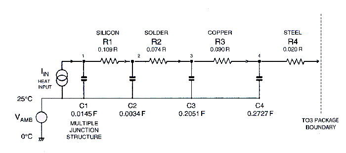

A thought strikes. (Happens sometimes) It seems to me we may have been assuming a bit too quickly that the sensing diodes are isothermal with the transistor junction, and that all we need to do is find a way to match the tempcos and all will be well. As I understand it, all we know about the internals is that the diode is mounted on the other side of the metal plate that contacts the outside world.
Considering that I have been responsible for ordering 100,000s of power transistors, it occurs to me that I am lamentably ignorant about the details of their internal construction. Back in the day when I was doing the thermal simulations in Chapter 13 of my slim monograph http://www.dself.dsl.pipex.com/ampins/books/book.htm I got some data about the MJ15023 (TO-3) from Motorola Toulouse. The picture below shows the figures for the internal thermal resistances and thermal masses that they gave me, scaled so they can be put straight into a SPICE simulator.
Apparently the silicon die was soldered to a copper header that in turn was welded (?) to the steel TO-3 flange.
The TTrak devices are obviously plastic, but it seems plausible that once more the die is soldered to the metal plate that we can see, and that the diode die is soldered to the same plate in a different operation and using a different blob of solder. That means (refer to the picture) that there will be a temperature drop in the body of the transistor silicon, and another in the transistor mounting solder, which means the diode will never be at the junction temperature.
There is now no steel flange, so there is just the thermal resistance of the thermal washer between the copper part and the heatsink. A rough calculation gives me 1 degC/W for a TO-264 washer of the standard material.
Taking the values from the picture, in the absence of any other data, the total resistance between junction and metal plate is 0.164 degC/W. Treating that as a resistive divider with the washer resistance, and assuming the heatsink does not change in temperature during the timescales we are interested in, that means that the sense diode can never reach more than 86% of the transistor junction temperature.
This does not explain why I needed four effective diodes rather than two to get the compensatiion right- a figure of 50% would be needed for that. But it is a thought.
This is of course a very simplistic model, and ignores other heat paths inside the package. We know these exist, because the top of the package gets hotter than the adjacent heatsink. But what are they? Does anyway know anything more about the internal construction of the TTrak devices? Are the transistor and diode in a little hollow in the plastic, or what?
I may know a thing or two 😀
Conceptually, the same equivalent schematic you got from Motorola applies for the NJL; all decent power devices (be it in TO3, TO247 or TO218, fakes not included) are mounted using what is called a "copper pre-form". Now, the values for the elements are generally not exactly known and no semiconductor manufacturer is going to oficially reveal and guarantee such parameters. What you got is most likely the result of some calculations, simulations and estimates for TO3.
I may crack a new NJL device, but last time I've checked the diode is not mounted using a copper preform, (this would connect the diode substrate to the collector; also copper preforms are expensive in terms of mass production) but using insulating epoxy. Which makes the thermal series resistance much larger than the transistor silicon-preform stack. Therefore, it is safe to assume there is a significant temeperature gradient between the transistor chip and the diode chip. How large, it is hard to say, only some calculations could be made... My estimate (based on other devices I worked with) is 10-15%
Look at these NJL devices as the best of the worlds in terms of temperature tracking; the Sanken devices are a little bit more elaborated but they are essentially not that much better. The ultimate device would have to be built with on chip, dielectrically insulated, diode but I certainly doubt this will ever be in production due to the economics. A separate diode chip is almost free, while an integrated, dielectrically insulated diode will most likely double the cost of the transistor itself. Add to this the lack of flexibility (OnSemi is selling the same transistor chips but without the diode, in the three pin TO218, as the MJL series) to understand why we are probably never going to get the goodies we are hoping for. All we can do is to understand how these devices are working and hence how to use them to our best. In this sense, what John is doing is very good stuff.
Douglas

Yes, I believe you are right. That's why I think this whole thread is a bit misguided trying to just match their temperature coefficient. Measuring the real thing is what counts as always 😀
Thermal trak diodes will be measuring something closer to case temperature than junction temperature - but this is still very good compared to measuring heatsink temperature. Don't know how much better than a top mounted transistor it is though, but maybe a bit as thermal conduction through the epoxy is probably not as good and fast.
Also there is a positive feedback mechanism which causes some extra temperature dependency of bias current if temperature sensor doesn't measure junction temperature: Increased junction temperature leads to increased bias current which also leads to increased power dissipation and so on...
Are you sure the model you posted is correct though? It has only 0.284 of total thermal resistance, but maybe it uses som other scaling between power dissipation and model current than 1W <-> 1A. But still you are right, transistor junction will be at much higher temperature than the copper baseplate. It's probably better if the diode is mounted near above the chip than on the baseplate.
It would be interesting to know where the diode is. Is it above the chip in the epoxy or is it down against the back of the transistor? The plastic packages are usually made with the chip soldered directly to the back plate which is already copper unlike in TO3 where it is steel. This is probably the reason why plastic packages have better thermal resistance than TO-3. (Steel doesn't conduct heat that well)

I am confused. What is a copper preform? Is it something that goes between the die and the metal plate? If so what holds it all together?
If the diode is mounted using insulating epoxy, that doesn't affect the rough calculation I did in the steady state, providing there is no significant heat loss from the diode. But there may be- this is why I would like to know the construction details. Certainly epoxy rather than solder would increase the time-lag.
I fear that to get a real feel for this we need a proper Finite Element Analysis of the package, and to do that we would need more data about the device than we are ever likely to get.
Does anyone know of a freeware FEA package? They do exist, because I was sent one, but the instructions are in Russian...
