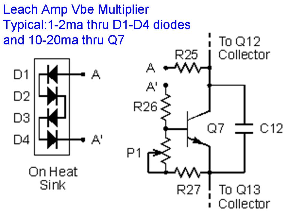

JPV said:The initial question was: the temco of the diode and of the Vbe of the transistor are not the same for the 3XXX series at normal bias current in the diode ( whatever this means)
It seems that looking at the datasheet of the 4XXX, the tempcos are the same around 10mA in the diode.
JPV
It looks like the 3xxx series is designed for Leach type Vbe multipliers with ~1ma current, and the 4xxx series is designed for series connection in a VAS stage with ~10ma current.
I use Sanken 2SA1215Y and 2SC2921Y with a Leach Vbe multiplier VAS circuit that uses separate diodes epoxied on the back of the Sanken packages. The Leach Vbe multiplier puts ~1ma through these series diodes. I use 2NPN+2PNP epoxy glued diodes for 4NPN + 4 PNP transistors on each half of a SuperSymm topology.
(a) Because of the large thermal mass of the heatsink and the different thermal paths of the ThermalTrak diode die vs. transistor die, will diodes glued on the back of a Sanken package have superior thermal tracking to ThermalTraks?
(b) SPECIFICALLY: Does the 3xxx ThermalTrak offer superior tracking to rear-package epoxied diodes in a Leach circuit?
Thanks for any help on these basic questions.

Ok the more date the better. But what we realy need is the Vbe drift around 100mA. The tempco coefficient is changing by 0.2mV/°C per decade of current. Therefore, if we know it at 100 mA the drift mill be nearly the same at other realistic currents.
The Vbe change at constant temperature should be 60mV per decade of current.
I use Sanken 2SA1215Y and 2SC2921Y with a Leach Vbe multiplier VAS circuit that uses separate diodes epoxied on the back of the Sanken packages. The Leach Vbe mltpilier puts ~1ma through these series diodes. I use 2NPN+2PNP epoxy glued diodes for 4NPN + 4 PNP transistors on each half of a SuperSymm topology.
SEE Post #185
"An experiment that can validate how well N-diodes in the Leach Vbe multiplier can compensate for K-output transistors using the ThermalTrak Tc factors would be very useful."
The Leach muliplier allows to use 4 diodes in the base leg to generate 6 diodes drop of the triple T Locanthi/Leach output toplogy. The number of // ouput transistors is irrelevant.
Being able to tune independently the tempco of the diodes in a Leach Vbe multiplier with the help of a spectrum analyzer will give IMHO the best crossover distortion avoidance.

The idea is to know if you have the headroom for adjustments.
You will have to adjust using a spectrum analyzer anyway.
The 0.2mV/°C change in tempco is basic solid state physics.

What about the following test.
Adjust the Vbias for 100mA in the output transistors with no signal
then by switching a resistor in the Vbias circuit, increase in one step the output bias current to 1A. without signal. This will be a nice step in power and allows to measure the ouput current and the Vbe while drift is operating. This will give accurate view of tracking dynamics.
