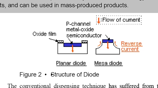

Here's a link to what I know as a mesa. It took a bit to find it, apparently they've used the same name for a fully planar device as you worked with.
What you have defined as a MESA, I remember as a planar diode with a guard ring.
Perhaps the definitions have changed over the years..It was difficult to find a picture on the web which matched what I remember, almost everything seems to be showing up as you said..
http://www.hitachi-pt.com/products/mechatronics/electronics/pdf/elec_02.pdf
Here's the picture of what I speak of...don't worry about the words or spelling, it appears to be translated badly from japanese.
Cheers, John

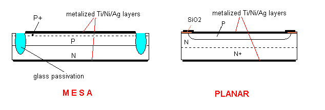

jneutron said:
In your picture, is the glass passivation really filling up the etched valley all the way to the top surface? Or is it a passivation coating, and the dicing saw cuts in the middle of the valley?
Cheers, John
Firstly, after phosphorus diffusion, the wafer is HF soaked, cleaned and sandblasted.
Then, the wafer is covered with some Si etching resist layer
The wafer is surface diamond-saw-cut, 1/2 of the total wafer depth, into square chips.
Then, the gaps are etched in order to remove any cut-induced strains and filed with a glass based powder compound. The glass is formed at high temperature.
The etching resist layer is then removed and photo resist is applied in order to form the mask for metal layers
After vacuum metal deposition the dicing saw cuts in the middle of the gaps

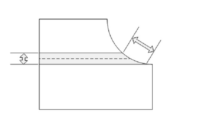

Ah, thank you.
For the normal guys, I've attached a depiction of what we're talking about w/r to mesa's.
The left half is a typical saw cut device. The depletion region (the space where the reverse voltage appears) is the slightly greyer area around the junction. Where this zone hits the surface, there will be a voltage gradient and resultant leakage.
On the right, the mesa topology cuts this zone at an angle. So, the entire voltage is across a longer surface, this reduces the voltage gradient so the resultant leakages...most of a normal device's leakage current is along the edge..
Thanks again, roender..
Cheers, John
