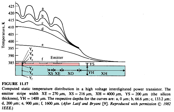

Doing some background reading last night I came upon this graph in "Bipolar Semiconductor Devices" by David Roulston, (see http://www.dself.dsl.pipex.com/ampins/library/library.htm) which gives insight into temperature drops actually inside a power transistor chip. It is the result of simulation rather than measurement. I believe quoting it here comes within "fair use".
In the diagram YS is the thickness of the silicon at 200um. YH is not defined, but at a thickness of 1400um (=1.4mm) it is presumably a metal header. As you can see, the maximum temp difference between junction and the top of the header is about 14 degC; between junction and the bottom of the header it is 41 degC. Diodes mounted on top of the header would apparently see almost exactly 2/3 of the junction-case temperature drop, just as predicted by jneutron in Post #379. However, as you move away from the junction sideways, the temp on top of the header drops rapidly towards the temp at the bottom of the header, so 2/3 is probably very optimistic. A lot depends on just where the diode is mounted.
DouglasSelf said:I reckon you've put your finger on it. I think we have to face the fact that the diode is nowhere near the junction temperature, and that is why I needed a multiplication factor of four to get correct compensation.
I must admit I'm a bit disappointed. 🙁
Because of the large thermal mass of the heatsink and the different thermal paths of the ThermalTrak diode die vs. transistor die, will diodes glued on the back of a plastic package have equal or superior thermal tracking to ThermalTraks?

Perhaps everything is not so bad.
The thermal circuit is linear, this means that in steady state the delta T of the diode is proportional to the delta T of the transistor chip for a specific delta power input
There is only one source of heat: the transistor, it is then possible to correct the tempco by multiplying it with a constant.
One measurement is enough to estimate this correction and it looks like it is a factor of two to correct a diode tempco of 1.6mV/°C.
If we bias the diode at 0.1mA, then the temco is multiplied by 1.2 and the gain of the Vbe multiplier should be 1.6. Reasonnable.
The transient will remain a problem. But the copper specific heat is half the specific heat of silicon and if the diode is close to the chip, the copper path has perhaps a negligeable capacitance. The ratio of mass of the two chips is the driving parameter.
The transient mistraking will be only relevant at very low frequencies so the crossover transient distortion due to mistracking. This is a good reason to use multiamplifiers and electronic crossovers.
JPV
