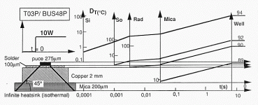

I have finally managed to unearth the information that Motorola Toulouse sent me in 1995. The attached picture of a TO-3P and its thermal response at least makes it clear that the transistor is constructed by soldering the die directly onto the metal part that faces the outside world, and there are no preforms or whatever to complicate things.
Unfortunately the temperature graphs are an object lesson in non-communication. All the axes are logarithmic, presumably to turn exponentials into straight lines, and each temperature line has a different scale. The top of the chip seems to start off at less than 1 degC, while the bottom face of the copper starts off just below 10 degC. We apparently have an infinite isothermal heatsink, but no idea what temperature it is at, unless the zero at bottom right means it is at 0 degC. If so, we have an 89 degC drop across the mica washer, which seems highly unlikely.
If the temperatures at far right can be trusted at all, they seem to say that the junction is 4 degC hotter than the top of the copper, and 5 degC hotter than the bottom of the copper. I have grave doubts about the temperatures but at least the construction is clear.

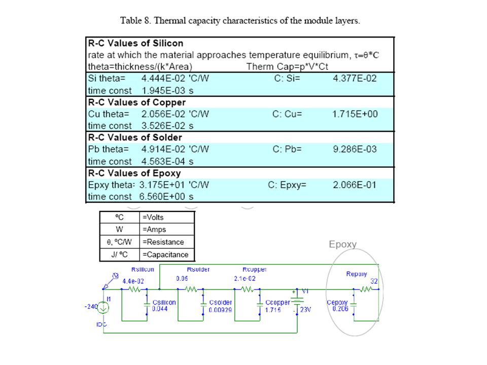

Another nugget of info from Toulouse. The attached picture shows the stresses undergone by a power transistor chip during construction. How it withstands those temperatures I do not know. The bottom right picture clearly shows that the chip is completely immersed in plastic, and it does not sit in a void.
Now we know why the tops of transistors get so hot. Anybody got any info on the thermal resistance and specific heat of the plastic used for this??
I'd guess those scales are in percent of final value of the temperature drop from that point to the infinite isothermal heatsink - and in that case they do make sense. 89 probably means the temperature from mica washer top to heatsink has reached 89% of its final value after 10 seconds and the 94 at top means the chip has reached 94% of the final value after 10 seconds.
The missing 6% is then caused by heat still flowing into the package.
89 degrees C drop over the mica washer at *10W* doesn't make any sense at all. 😀
DouglasSelf said:Anybody got any info on the thermal resistance and specific heat of the plastic used for this??
LineSource said:
Thanks LineSource, just what I wanted. I am going to put together a TTrak SPICE thermal model.
megajocke said:I'd guess those scales are in percent of final value of the temperature drop from that point to the infinite isothermal heatsink - and in that case they do make sense. 89 probably means the temperature from mica washer top to heatsink has reached 89% of its final value after 10 seconds and the 94 at top means the chip has reached 94% of the final value after 10 seconds.
I did think that might be it, but one of the vertical scales is labelled in degrees C.
I see that, but the numbers don't make any sense at all in that case
(mica insulator with 9k/W thermal resistance for example...)

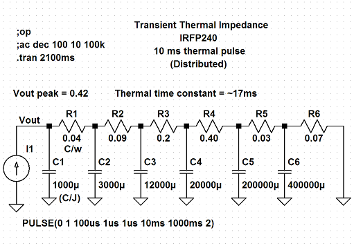

The attached LTspice thermal simulation is one that I did previously for an IRFP240 vertical power MOSFET. That device has a dc thermal resistance of 0.83 C/W and is likely not too far off from what a ThermalTrak transistor would look like.
Transient Thermal Impedance (TTI) describes the peak rise of junction temperature due to a pulse of power being applied to the junction. It takes into account the distributed thermal impedance and thermal inertia of the device. In the simulation below, a 10ms 1-watt pulse (1 amp is the electrical analog) is applied, and the junction temperature is seen to rise by 0.42 C at Vout (voltage is the electrical analog of temperature). For a 10ms single pulse, the transient thermal impedance is thus 0.42 C/W.
This model was constructed by matching the transient thermal impedance curves provided in the IRFP240 data sheet over about six decades of pulse time. The non-uniform distributed transmission line-like structure is due to the three-dimensional nature of the heat flow out from the junction. In many devices, the source of heat flow is like a very large number of small point sources distributed across the surface area of the die. If the heat flow was one-dimensional, the model would look more like a uniform transmission line.
R1 – R4 and C1 – C4 model the heat flow in the silicon die, which is the dominant source of thermal resistance. R5, C5, R6 and C6 model the heat flow in the copper header. In this model, 0.1 C/W of the total thermal resistance is allocated to the copper header. Because R6 is returned to thermal ground, this simulation models the device as being attached to an infinite heat sink.
The header heat flow is crudely modeled with the assumption of a local thermal region where the die is located and a larger heat-spreading region corresponding to the larger total area of the copper header.
In this model, a ThermalTrak diode attached to the copper header next to the transistor die would be modeled as having its temperature as that existing at the junction of R5 and R6. The thermal resistance to the diode and the thermal inertia of the diode are assumed to be insignificant. In other words, the junction temperature of the diode is assumed to be the same as that of the local area of the copper header to which it is attached, both on a steady-state and transient basis.
The dominant thermal time constant of the model is about 17 ms. This means that the junction temperature of the transistor reacts and changes quite quickly. It is especially important to recognize that, while a significant temperature differential may exist in steady state between the transistor and diode junctions during significant transistor power dissipation, the temperature of the transistor junction will relax quickly to nearly that of the copper header with a time constant of only about 17ms, when power is removed.
Bob

Are you sure R4, C4 "belong" to the die?
A die of 5x5x0.3mm will only have about 12mJ/k thermal capacity while if R4,C4 and everything to the left is in the die it would need to have 36mJ/k. Or is the die this much bigger? Doesn't make much difference though for the application, those 0.4k/W would be the mounting of it and the copper just below it, not accessible for a temperature sensor.
megajocke said:Are you sure R4, C4 "belong" to the die?
I have assumed that they do belong to the die, but I freely admit that the model was constructed to fit the IR transient thermal impedance curves with only an heuristic approach to the physical construction.
There are many assumptions built into making such models. For example, one of my assumptions was allocating 0.1 C/W to the copper header and all the rest to the silicon and its attach. An even more important assumption is that the IR TTI curve is correct. It is likely that the IR folks arrived at this curve through use of a finite element model, like FlowTherm, augmented by some pulsed power measurements. They probably had to do some hand-waiving as well.
The most important thing is the dominant thermal time constant. I think that if only the estimated 12mJ/k thermal capacity was used in a conventional lumped/distributed model, and knowing what the dc thermal resistance is, one would end up with a too-small dominant thermal time constant.
Note also that for many devices we do not enjoy the luxury of a published TTI curve. However, one can infer to some extent the dominant thermal time constant by taking a look at the SOA curves at voltages below where secondary breakdown effects come into play. The pulse width where the SOA begins to increase substantially above the dc value can give a rough clue as to the dominant thermal time constant.
Bottom line, there is necessarily a lot of hand-waiving and SWAG estimating here, but it is far better than nothing.
Bob

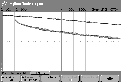

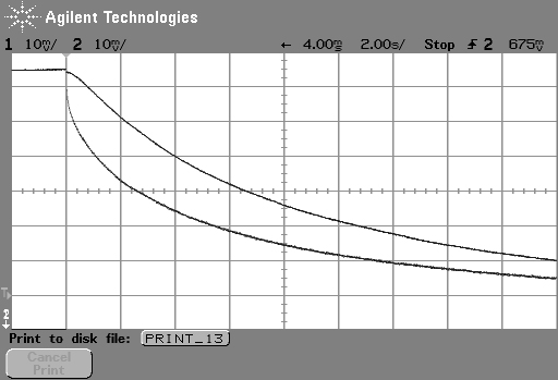

My interpretation of the graph in post #401 from Douglas is this:
The graph shows no absolute temperature but a delta T as the graph is labled DT(°C). That means before the step in power dissipation from 0 to 10W the temperature rise is 0.
Indeed the final temperature of 94°C temperature rise is a bit confusing - the graph does not note what thermal sink is used and what temperature it has. If mica has something like 0.71W/mK a 200um thick isolation on a TO3-P case with 15x20mm has a Rth of 0,939 °K/W and thus @10W => dT is 9,39°K. So heatsink temperature was Theatsink = Tcopper -dTmica = 89°K - 9,39°K ~ 80°K. At 10W power the Rth of the heatsink was a poor 8K/W.
At second the straight lines on algarithmic scale indicate something like a time constant for the thermal response on a stepwise change in power dissipation (like a RC time constant).
The first graph I would read something like 4°K/1ms for the SI region. Unfortunately the scaling is lousy.
Michael

Here's some more data on the NJL4281/4302. The attached scope capture shows the thermal time constant between the diode and the transistor's Vbe.
No attempt was made to match tempcos as the purpose of this test was to measure how fast the diode would respond to temperature changes in the transistor.
This test was performed with two curve tracers. One was supplying the compensation diode with a 10 mA constant current. The other tracer was driving the transistor. The transistor was ounted on a heatsink.
The two traces are the diode's Vf and the transistor's Vbe as temperature increases due to a 3A step in collector current.
As you can see, the diode responds rather quickly...
John
