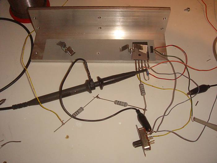

DouglasSelf said:The question was asked a while back as to how the response of the internal diode compared with the temperature rise on the top of the package. (Which has I think now been demonstrated to definitely be the best sensor position for non-TTrak transistors)
Time for a Yuletide experiment. In the attached screen-shot the diode voltage for a 5mA current is at the top, and the lower trace is the temperature at the top of the package as measured by an LM35 TO-92 temp sensor. Assuming -2mV/degC for the diode, both scales are 5 degC per large division. The power step was 6W, TTrak was on a sizable heatsink, thermal washer Koolpad K230 fitted between the TTrak top and the LM35.
The internal diode responds more and faster, no question there. Hmm!

Nice work. If I'm interpreting your time scale correctly, (5 sec/div), it looks like the thermal time constant of the transistor/header assembly, in connection with the thermal resistance from case to heat sink, is about 20 seconds. I'm assuming the heat sink is fairly large, and doesn't move much thermally. What do you estimate the thermal resistance from case to sink is in your experiment?
In experiments I did yesterday, I wanted to measure the thermal mass of the transistor/header. I put in 12 watts and estimated that the thermal resistance from case to sink was about 0.7 C/W (not a great contact). The heat sink was large.
Hi Bob
Quick answer in between excessively large meals.
The time scale was indeed 5 sec/div. Heat sink large enough to alter very little on this time scale.
Thermal resistance from case to sink calculates as 0.77 degC/W but probably a bit higher as mounting pressure low to avoid crushing the LM35.

Yes, much more than a second. The test I did on Xmas Eve shows that the diode voltage took 29.5 seconds to reach 63% of its final value. I must admit that is a lot slower than I expected.
Attached is a pic of the experimental setup so you can see the heatsink size. Not exactly the Large Hadron Collider, but I think it did the job.
