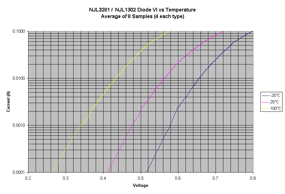

All,
Here are the diode temperature curves for the NJL3281 and 1302. Note that I didn't perform the testing at as many temperatures as I did for the 4281/4302. This is for two reasons:
1) They agree with the datasheet about as well as the 4281/4302
2) Time constraints.
Now, onto Vbe tempco testing on all 8 at Ic=0, and Vbe tempco on a single representative sample at Ic=100mA...
John

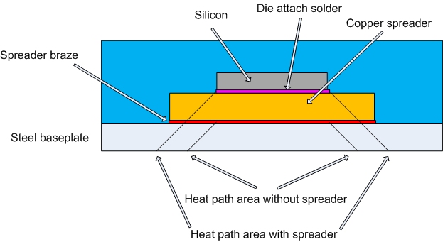

Here's a drawing of a typical device.
Can anybody tell me where the diode is located? Is it on the spreader, on the baseplate, or on the top of the silicon?
I also show the heat path difference, and this is the reason for the copper spreader, to reduce the heat flux density through the heatsink compound, and reduce the theta JC..
Note...the lines are the 45 degree lines of the heat spread model.

jneutron said:Here's a drawing of a typical device.
Cheers, John

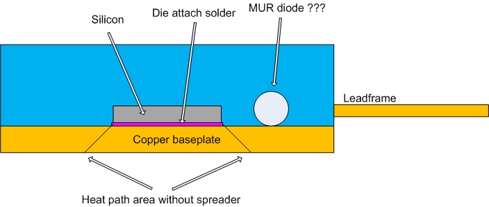

This is what charles Hansen is writing in another thread:
they take a MUR120 (sans the epoxy body) and mount it to the copper lead frame near the transistor die. The resulting product has less than 2 pF of capacitance between the transistor and the diode.
Stinius
Stinius
If the die is on the copper lead frame, then it is outside the 45 degree cone. If you have a really good thermal interface between the leadframe and the heatsink, the diode will never get to the die temperature, and there will be a considerable thermal lag.
That may explain why it takes twice as many diodes to achieve real tracking. And why devices in the oven look ideal.
If you use a very bad heatsink to leadframe interface, the diode will probably track better. Like, dry mounting the device without compound..
YO neighbor: any chance of x-raying the device? Is charles talking about a diode with actual leads and glass passivation, or is it a chip with wirebonds?
Cheers, John
Cheers, John
Thanks for that, but what is it a drawing of? The devices we are talking about have a plate of copper connecting with the outside world, though it does have a silvery coating, possibly nickel???
(Moment of doubt. Pause to scrape coating off a 2SA1302- yes it's definitely copper under there. I'm not going to do it to one of my precious TTraks, but I think it is a safe call that they are copper too- they're certainly not magnetic)
Perhaps your drawing is of a TO-3? Modern ones have steel flanges, as a moment with a magnet demonstrates; for example:

From the discussion, there was mentioned a copper something and a steel baseplate. I drew exactly that.
Is it more like this??
Yes I think it’s more like that.
Anyway it’s outside the Thermal “transmission line” I it’s something that is called that, but I guess you understand what I mean.
Stinius
I'm pretty sure almost all plastic devices use copper baseplates. Some, like the 2SC3264 in the huge MT-200 has an internal spreader looking like a TO3-P though. It seems the collector lead is usually attached to the baseplate from the beginning too on most devices.
I can see why it is needed in the steel (doesn't conduct heat well at all!) TO-3:s but with copper baseplate I don't know if it is much point, heat conduction through the commonly used insulating pad isn't too good which should mean improving the lateral thermal resistance won't help that much. But I'm not sure - I don't know what the typical thermal resistance from one end of a package to the other is.
Wouldn't that 45-degree thing you shown only be valid for materials with similar heat conductivities?
From http://en.wikipedia.org/wiki/Thermal_conductivity in W/(m*k)
Stainless steel 12.11 ~ 45.0
Lead 35.3
Aluminium 200
Gold 318
Copper 380
Copper is about 8-30 times better than steel!
The 45 model works quite well for typical constructs of silicon, copper, moly, aluminum, beo and alumina...normal materials I've used for military power hybrids as well as TO packages.
Where it starts to fall apart is when the contact material is significantly lower in conductance, as it starts to form an isothermal. The ultimate isothermal is of course, the oven data John is seeing.
This is exactly what you speak of, and yes, you are thinking correctly.
If the diode is outside of the transmission path, then it makes the oven data inconsistent with high power heatsinked operation, as Douglas is finding.
My statement regarding 6 milliamp operation of the diode is due to the production spread, it is tightest at 6 milliamp..
Cheers, John
FWIW, here is the Vbe tempco for a single unit of NJL3281 at Ic=100mA: -2.42mv/ºC. The unit I picked was "middle of the pack." Not the lowest Hfe, nor the highest...
Since the Hfe varies so much, to support Ic=100mA, the base current will vary from unit to unit. When base current varies, so does the tempco for Vbe. But from the data I've collected, this tempco will typically range from 2.3 to 2.5 mV/ºC (on average) for the 3xxx and 4xxx series when standing at Ic=100 mA (Ib=0.4 to 1 mA).
JPV, on to your characteristic curves...
John

Could you also do the x-ray?
I tried, but the back plate made it difficult to discern what was inside. I'm far from an expert at running the x-ray... The best bet would be to mill the plastic away...
John
