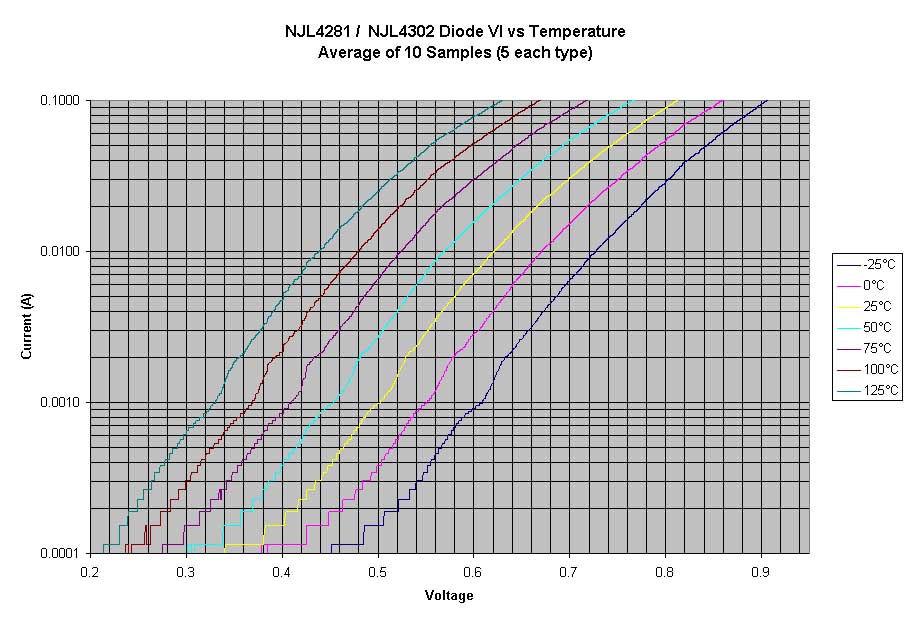

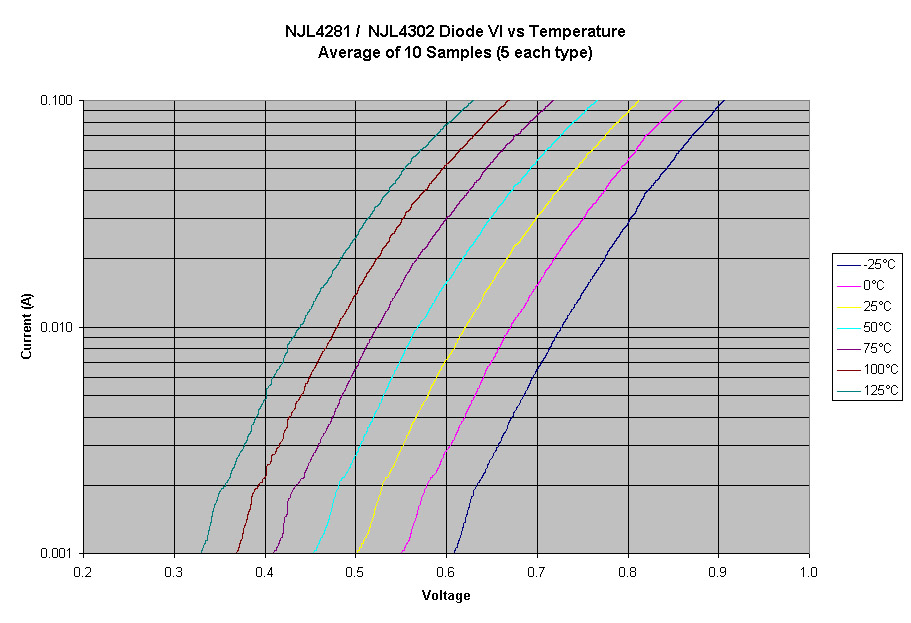

jgedde said:I wasn't able to finish all the temperature runs today. Still left to do are 100 and 125 degC for the diode, and a tempco determination of the transistors. All will have to wait until tomorrow. So far, it seems the datasheet is very close to reality. By this time tomorrow, we will know all... Then, on to verifying/tweaking the PSPICE model for the diode...
What should I run for base current for the transistor tempco tests? I'd like to keep self-heating to a minimum, but still get a tempco that's at a reasonable value.
Hmmmm. I was just thinking... What if I used another Tek 576 (I have three) to drive the transistor, and use another to look at the diode. Then I'll capture how the diode reacts to load changes in the transistor. In other words, how long it takes to stabilize to a new curve. Just speculating. I have already spent way too much time on this..... 🙂 Oh well, it's for a good cause. So far, you folks have been invaluable to me in sharing your experience and "lessons learned." I guess, even if I do this test, I'll still end up ahead time-wise given that the advice given to me over the past two years has saved me a lot of wasted time...

Because the objective is to minimize crossover distortion with transient variation in temperature, I believe that it is important to know the Temco of the transistor Vbe around 100mA bias current ( optimal bias for 0.22ohms in the emitter) in the 300 and 400 °K range. Variation of Tempco is minimal with 100% variation of Ibias
For the diodes, more information is needed and checking if the datasheet is correct is important.
Normally knowing two points per current is enough:
Vbe at 300 and 400 °K for different constant currents ( a few steps of 100 micro amps around one milliamp and then steps of one milliamp including a 10 mA measurement).
The different current steps can be done at one temperature and then repeated at the second temperature. These small steps will see the Vbe settling rapidely and the overall measurement should not be too long (IMHO). We then can plot the data on a graph and see if they extrapolate well to the band gap voltage.
Here is a confirmation of the -0.2mV/°C change in Tempco per decade of decrease of current.
http://www.national.com/rap/Story/vbe.html
This would also allow you to choose the right current in the diode to perform your ultimate test with two 576. With all this, we will know!!

The results are close to the data sheet.
Can you make the 3XXX data at a lower peak current like max 10mA to have a correct resolution at 100 micro amp
It seems that resistance starts to influence above 10mA.

JPV said:The results are close to the data sheet.
JPV
IMO it would be nice if John did exactly the same test on the 3xxx that he did on the 4xxx.

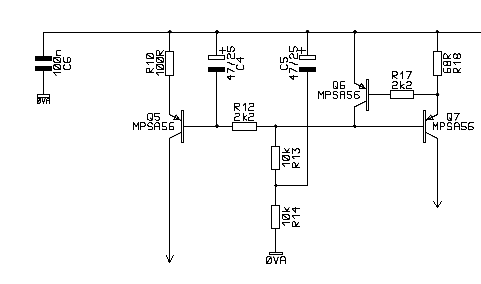

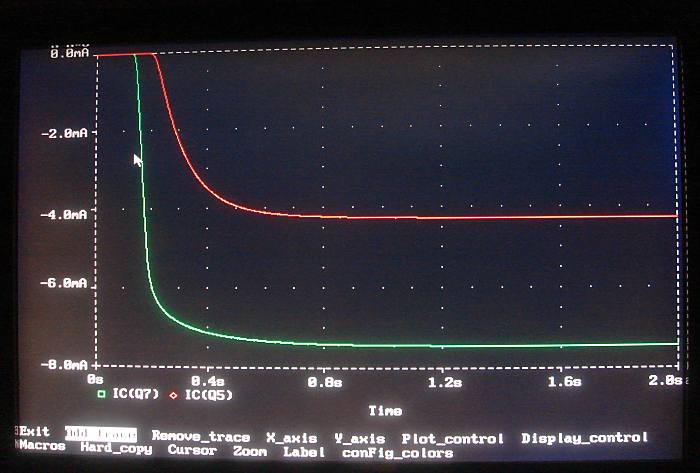

Having taken to heart the comments about amplifier start-up transients, I though I'd better find out what exactly happens in the amplifier I did the TTrak tests on. The picture below shows the biasing system, identical to that of my Load-Invariant amplifier. Q6 exerts NFB control of the Q7 VAS current, and the same voltage is used to bias the input stage tail source Q5.
I did a PSpice simulation and the results will be in the next post.
The dodgy screen-shot below shows how the two current-sources start up.
The VAS source reaches 90% of its final value in 267 msec, and the input tail source 472 msec, due to its extra filtering. This appears to show that the THD vs time data for at least the first second should be ignored.

I think that the real interesting region for the diodes is from 500 micro amps to 10 mA because that is where it will be used and where I am using them.

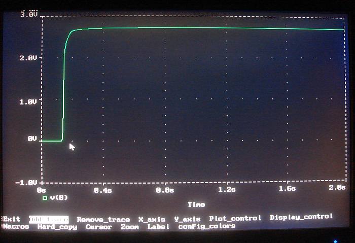

But... the important thing is not the VAS current but the voltage the Vbe multiplier gives, and I suspected that it would reach final value much faster. I put a 4x Vbe-multiplier in the VAS collector circuit, with the result seen below. The Vbe-mult output stabilises faster, because of its regulating action, and reaches 90% of final value in only 164 msec.
However- it's more complicated than that. Before the proper VAS current can be established, the input stage must be working enough to turn the VAS itself on, and the input tail source starts up much more slowly. This is getting complicated.
All in all, I think we had better forget the first two seconds or so of my tests, but I think everything after that is valid, and the conclusions in posts #239, #240 are correct about the faster TTrak response.
JPV
Stinius
I will have to repeat it the same way as for the 4xxx. When all the diodes are wired in series, the voltage resolution available goes down the tubes, hence the "stepped" appearance below 100 uA.
If the data is very close to that of the 4xxx units, I think we could safely say that one wouldn't want to run VAS or multiplier currents less than 1 mA anyway. But, if the data differs, I need to rethink my measurement scheme to be able to accurately log data in the 100 uA to 1 mA region because this might be the region where one gets a tracking tempco with the 3xxx units.
