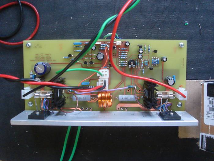

jgedde said:Douglas,
There is one possible explanation for both the 20 second dip at start-up and the fact you need 4 diodes...
It really seem as if there is another tempco at work here... You said you're using an EF type driver stage. I would strongly suspect the tempco of the output stage drivers are coming into play here. They must be carrying their own standing current, and their Vce isn't zero. Therefore, they are dissipating power. Since theta-ja is typically a large number, in 200 seconds, I wouldn't expect any huge change in case temperature, at least not with the finger test. 😀
So, you would have two tempcos that are changing; and not necessarily in sync with each other giving a second order total tempco.
An IR thermograph of your 200 second run would be invaluable as far as verifying whether this is so.
Where are the drivers mounted? On your main heatsink? Or do they have their own? Do they even have/need a sink?
The "finger test" reminds me of the many times I've gotten a DIP tattoo...![]()
Hi there
It's good to be back! Thanks to all for alerting the mods.
It is possible that the driver Vbe's are contributing to the results we see, but I think it is unlikely. I did my best to keep the drivers cool. They are mounted on separate heatsinks (quite large ones for the small power dissipation) with no thermal coupling to the main heatsink, and throughout a day's testing they stayed stone cold. Take a look at the driver hsinks on the attached pic of the test amp.
I did some rough checks by measuring the driver Vbe's and this seemed to confirm the driver junctions were not heating significantly. However, I certainly wouldn't rule it out without some more testing.

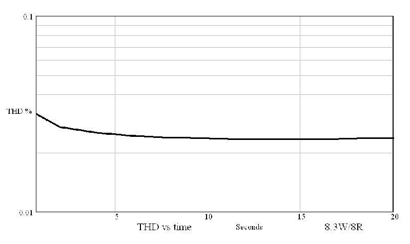

Here are the results of another TTrak test. Here I was measuring the distortion of the under-biased amplifier versus time, as described before. I was looking for some confirmation that the TTrak diodes really do respond faster than conventional methods. I have also found time to turn the AP data into respectable graphs.
The plot below zooms in on the first 20 seconds of the response for conventional compensation with the sensor on top of the output device, taking readings as fast as a AP System-1 can do it, which seems to be something like once a second.
The second plot below similarly shows the first 20 seconds of the first ThermalTrak experiment I did, with the TTrak diodes in series with the driver Vbe-multiplier, and a VAS current of 9.2 mA.
It is clear that the second plot has a faster initial transient. For conventional compensation with the sensor on top of the output device the time-constant (time to reach 63% of final value) is about 2.5 seconds, while for the ThermalTrak case it is about 0.5 seconds. I must admit I was expecting the ThermalTrak response to be faster than that. Two thoughts:
Firstly the AP doesn't take readings fast enough to give very useful time resolution here.
Secondly there may be some wholly non-thermal settling down of amplifier operation during the first seconds- I am thinking particularily of the ripple-filtering in the VAS current-source biasing. That should be fairly easy to check by changing the filtering time-constant and seeing if the THD/time plot changes.
I should like to express my thanks to the Signal Transfer Company http://www.signaltransfer.freeuk.com/, (who sell PCBs of my designs) for ordering the ThermalTraks for me, as I don't have an account with DigiKey myself. Many thanks chaps.
