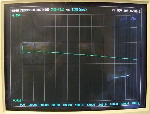

THERMALTRAK TESTS 1
I have at last got round to acquiring some ThermalTraks, and doing a few hours work with them. And I am here to tell you that all our theoretical discussions appear to be well off the mark.
The test amplifier is an EF Type 2 and is essentially the Load-Invariant with the output stage converted from CFP to EF.
The maximum power was 20W/8R but the amplifier was run at 8.3W out to increase the dissipation.
The main heatsink is deliberately small to speed up heating and cooling; it got warm but not hot; using the Mk1 fingertip, I would say about 40 degC.
The driver heatsinks are large for the power level, to minimise driver heating and keep things simpler. They stayed at ambient temperature.
A solder mask has been dispensed with to make it easier to solder to tracks.
I used the method I mentioned here of underbiasing to about 0.03% and measuring the change in amplitude of the crossover spikes with time.
I have not had time to make pretty graphs of the data, so I'm afraid all I can show you is some screen-shots that are of less than stunning quality, but I hope they will show what's going on.
Since it appears you can only attach one pic per post, this will have to be in installments that I will number at the top.

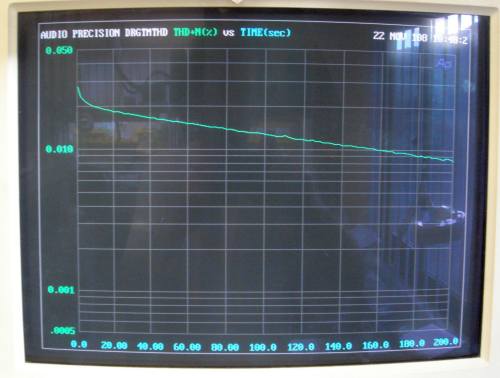

The first three tests use conventional compensation to establish a reference. The TTrak diodes were not used.
Test 1) Sensor transistor mounted on the driver heatsink.
There is an initial fast increase in bias, I assume- but do not know- that this is the output device junction heating.
There is then a steady increase over 200 seconds as the main heatsink warms up. The amplifier is seriously undercompensated.

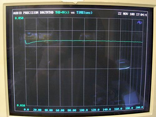

THERMALTRAK TESTS 2

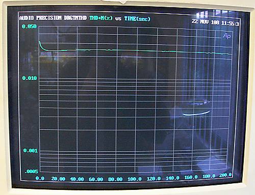

The sensor transistor was then moved to the main heatsink, to give conventional compensation.
Test 2) Sensor transistor mounted on the main heatsink, about 2cm from the edge of the output device.
The compensation is much better; somewhat overcompensated as the transistor Vbe is multiplied 4 times but the drivers are staying cold.
THERMALTRAK TESTS 3
3) Sensor transistor mounted on top of one of the output devices.
The initial transient is now faster (10sec rather than 35sec) which is what I would expect. The long-term compensation is also good, though that is more luck than judgement- the amount of thermal coupling to the sensor happens to be about right.
This is intended to represent the best that conventional compensaton can do.

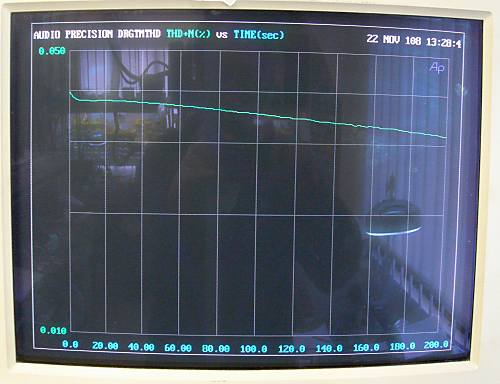

THERMALTRAK TESTS 4
This is the first use of the TTrak diodes. They were simply put in series with the sensor Vbe-multiplier, which was turned down in voltage as it is now only compensating the drivers. The sensor was moved back to one of the driver heatsinks. The VAS current was 9.2 mA.
NOTE- the scale has changed.
The initial transient is now both smaller and faster, but over 200 seconds we are clearly undercompensated. This was no surprise as we know that the TTrak diode tempco at 9.2 mA is less than that of the transistor Vbe's.
More soon.

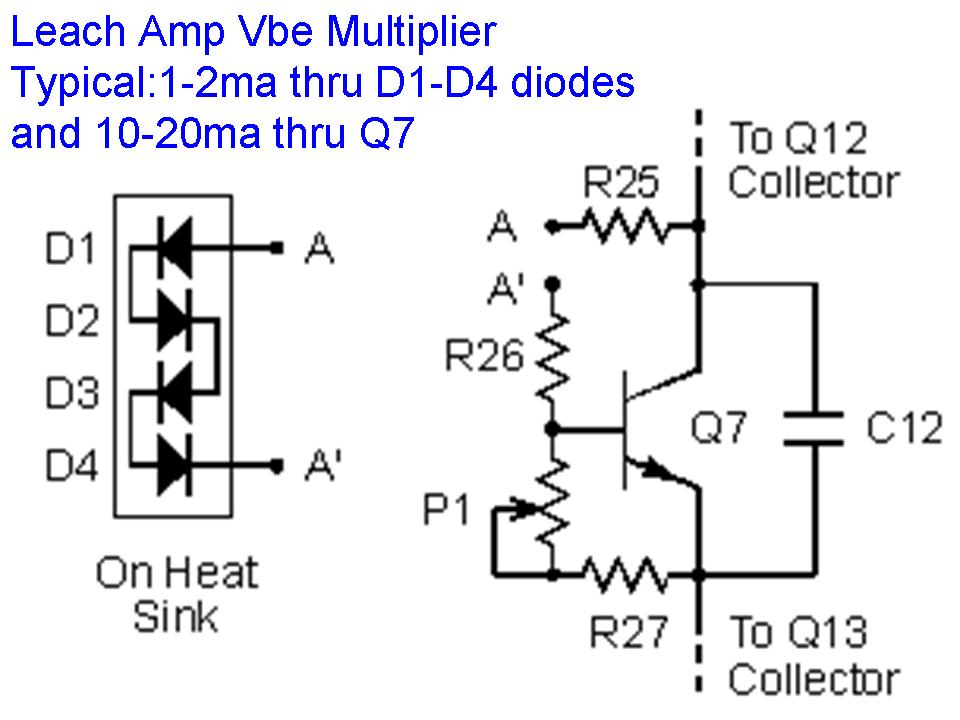

How well will the Leach-style Vbe multiplier work with ThermalTraks?
Most Leach designs typically have 1-2ma thru the diode string and 10-20ma through the Vbe multiplier transistor.
To built an optimally biased circuit, many designs require using fewer diodes between the base-collector than the total number of output transistors.
An experiment that can validate how well N-diodes in the Leach Vbe multiplier can compensate for K-output transistors using the ThermalTrak Tc factors would be very useful.

THERMALTRAK TESTS 5
This is the second use of the TTrak diodes.
We worked out that the TTrak diode current needed to be much less (158uA) to give correct tempco matching. Here the TTrak diodes have been taken out of the VAS path and fed with 800 uA (for various reasons not 158uA) and their voltage drop added to the driver Vbe-multiplier.
The results are better than Test 4, but still undercompensated.

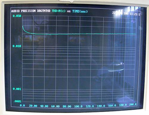

THERMALTRAK TESTS 6
This is the third use of the TTrak diodes.
This time the TTrak diodes are once more passing about 9.2mA but their Vf is multiplied by a factor of two, and then added to the driver Vbe-multiplier. The long-term compensation is now good, though our theory says it should be quite seriously overcompensated as 2 x 1.7mV/degC = 3.4mV/degC, much more than 2.14mV/degC. There is also a rather worrying dip in the first 20 seconds- where does that come from?

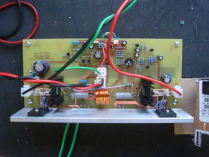

This is the amplifier, with the sensor on the right-hand driver hsink.
