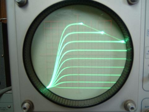

Not one, not two, but THREE Tektronix 576's arrived yesterday. One seems to work perfectly and only needed minor calibration (VI curves with a set of prescision resistors).
I already have the 4281's. It does seem the VI curves of the diodes at ambient have quite a bit of variation between units. 3 are almost excatly the same, 1 is a bit different, and the last is different by almost 50%! I'm debating whether to leave this one out of the test as being out of family. I'll see what the 4302's do and make a decision based on that.
The transistor curves vary quite a bit too.... 3 are exactly the same, 2 are about 75% of the gain of the first three. I'll post everything when I have a completed study...
John

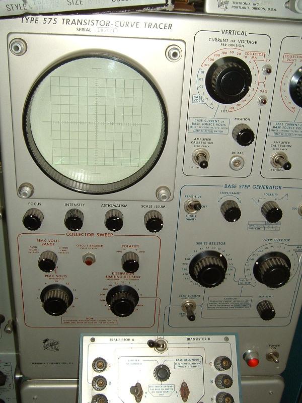

lineup said:beautiful Glen!
is there a built in transistor curve tracer?
It IS a transistor curve tracer. BTW, I made a boo boo. It's a 575.
Hi Glen,
I hadn't used one since college - 20 years ago! They're a fun toy! I'm still learning all the things they can do, but I figure I'll soon wonder how I ever got by without one! I don't have to now; as my understanding is I don't have to return them... They're "out of service." One works as new after its calibration was tweaked (it was taken out of service after failing calibration back in '99 and was never adjusted back) and switch contacts were cleaned up. The second works but has a trace so dim that it's unusable - I don't think the CRT is bad. The last also works, but the trace cycles in and out of focus. I'm not sure what would cause that....
One of these days I'll build an actual amp using the ThermalTraks. Right now, I'm still playing games with a complementary input stage... But at least, when I do, I'll have all of the info I need to get it right the first time.
One of the engineers from Jet Propulsion Laboratory I'm currently working with brought a kick-a$$ Tektronix 2 Ghz 4 channel scope with him. That thing does everything! I'm still drooling...
John
That's a boat anchor in beautiful shape for sure! Is it tubed or solid state? When was it made? Have fun with it!
