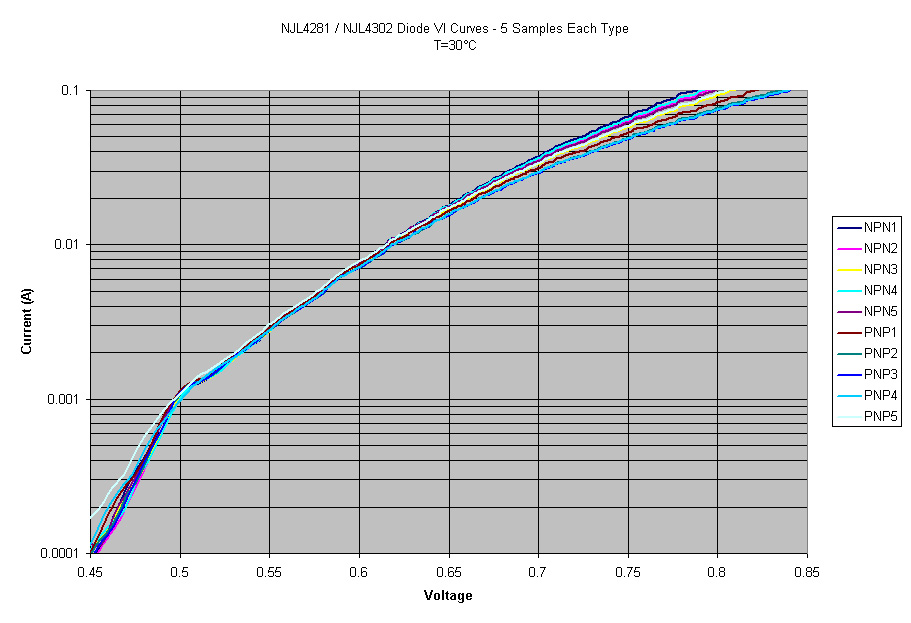

they are very close from 1mA to 10mA.
I don't know semi-conductor production but I doubt they can design the devices to give this level of matching.
Surely it must be done by selection and trimming. It seems to indicate that there is some laser trimming going on to arrive at this matching.
Could the parallel buried emitter resistors be used to achieve this?
Why is there a pronounced knee @ 1mA?
Is there a way to determine the effective value of the buried emitter resistor?

Andrew,
What you see is If/Vf data of internal ThermalTrack MUR diode. It has nothing to do with actual transistor

The diode is not on the transistor chip, but a separate chip on the same mounting plate, identical for both N and P transistor. What was measured is what I would call a normal dispersion for the forward conduction in a diode.
The real problem is related to the N and P transistors, not having the same Vbe tempco. Repeating the same experiment for N and P Vbe (with temperature as a parameter) would certainly be very interesting.
0.05V was most likely the voltage increment, hence the appearence of a "knee".
Actually, the voltage driving the diodes is analog and not "stepped." The appearance of a knee seems to be an artifact in the DSO A/D when sampling values "in the mud" for the selected range. In other words, the data being measured at 1 mA and below is two orders of magnitude below the maximum.
I debated whether to include these values in the plots because they are not nearly as accurate as the rest of the plot. Nonetheless with other list members experimenting with currents below 1 mA, I included it for reference.
If I get a chance, I will measure tempco of Vbe on both PNP and NPN units. But these tests are starting to eat up a lot of time.
On to the temperature testing...
John

Nice John.
Interesting the spread of 50 millivolts at 100mA.
I recommend running the temco's at 6 mA. And, I don't think cold measurements are necessary, unless you plan on building military hardware, eh?

stinius said:John
I think you have proved that it isn't a MUR120.
Stinius
Remember that I'm testing the 4xxx series not the 3xxx series. My suspicion is that the diodes are different between the two series. The 3xxx series may well use the MUR120 even though the 4xxx doesn't.
Jjohn

They have the theoretical 60mV per decade of current at low current under 1mA. and they have a 120mV per decade at high current which implies resistive effect;
They are very close to the specs which is good.
