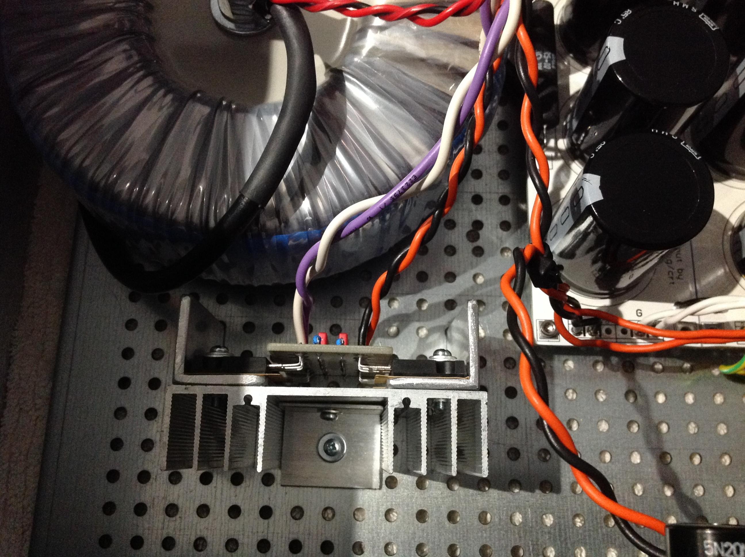

BTW, what do you use to separate the transformers when you stack them
together? I'm may need to do that for a vfet2 build but am unsure what
works well in practice.
Dennis
Each Antek transformer comes with two rubber pads. I used one on the bottom, two in between the transformers and one on the top. I have stacked transformers in my Aleph J and F6 builds without any issues. As you can see in a photo in one of my previous posts, I can rest the amplifier on one of the heat sinks and the transformers remain in place.
Thanks Grimberg. Good to know no magic is required to keep the transformers in
place.
Dennis
place.
Dennis

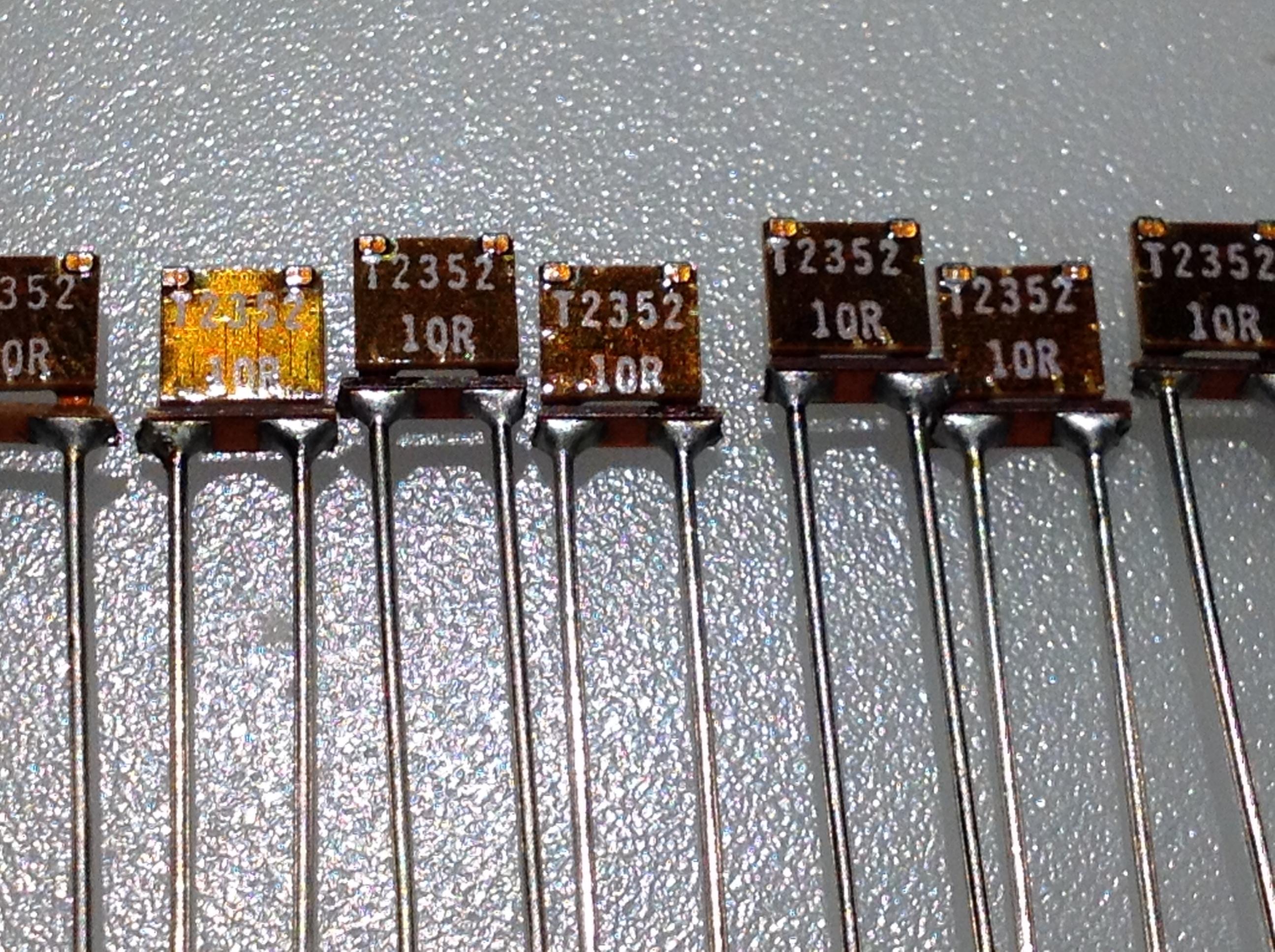

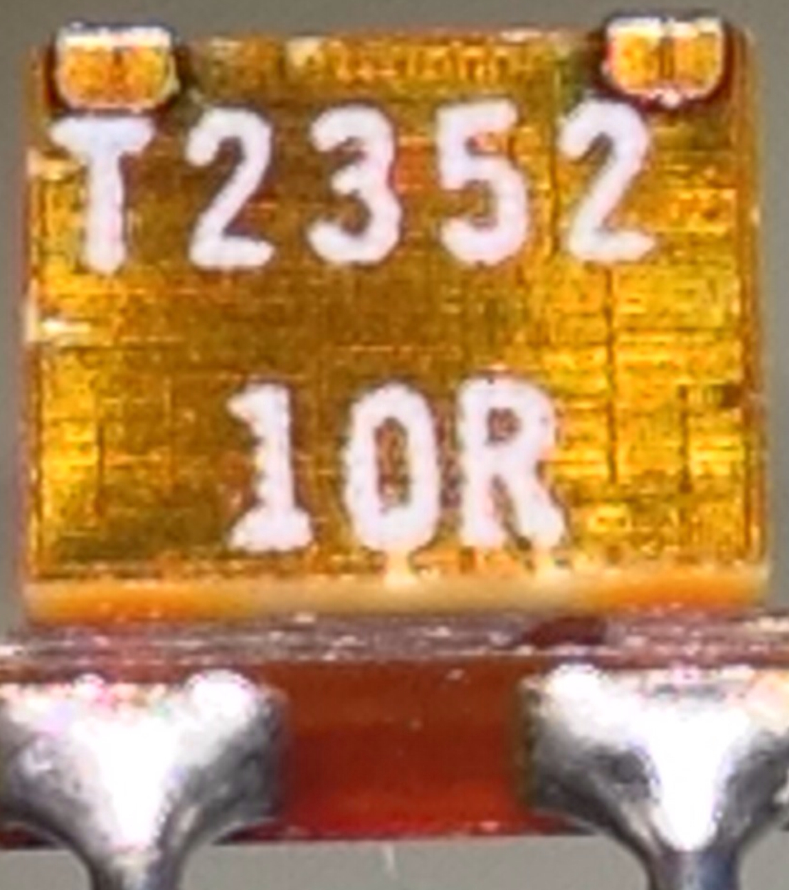

Received today few resistors for M2 Jfet stage.

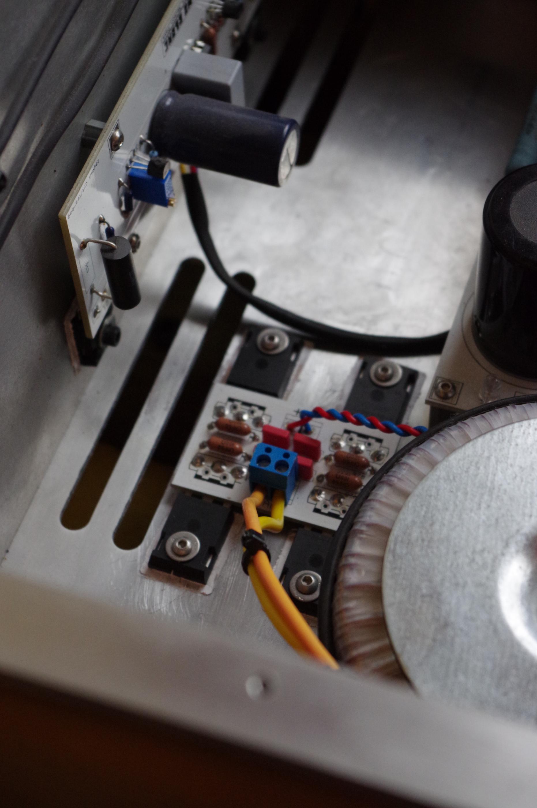

I've just begun ordering parts for my M2 build. Thank you so much for the design and schematic.
Somehow I bookmarked two different BOMs for the M2 boards. Can someone skim through my list and make sure it looks correct for the tea-bag boards?
The IRFP240 and IRFP9240 are coming with the boards and the 2SK170BL and 2SJ74BL are coming from Spencer
thanks!
Edit: the R10 and R12 should be quantity 4
thanks!
R6, R7 need more other value to set the DC offset, at least for my built.
Think I'd be safe adding optional 56.2K, 61.9K and 69.8K to the parts list to cover that?
awesome, thanks!
