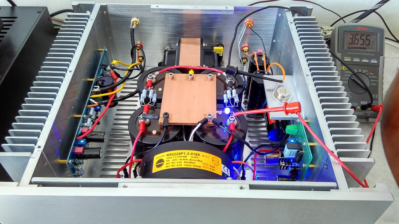

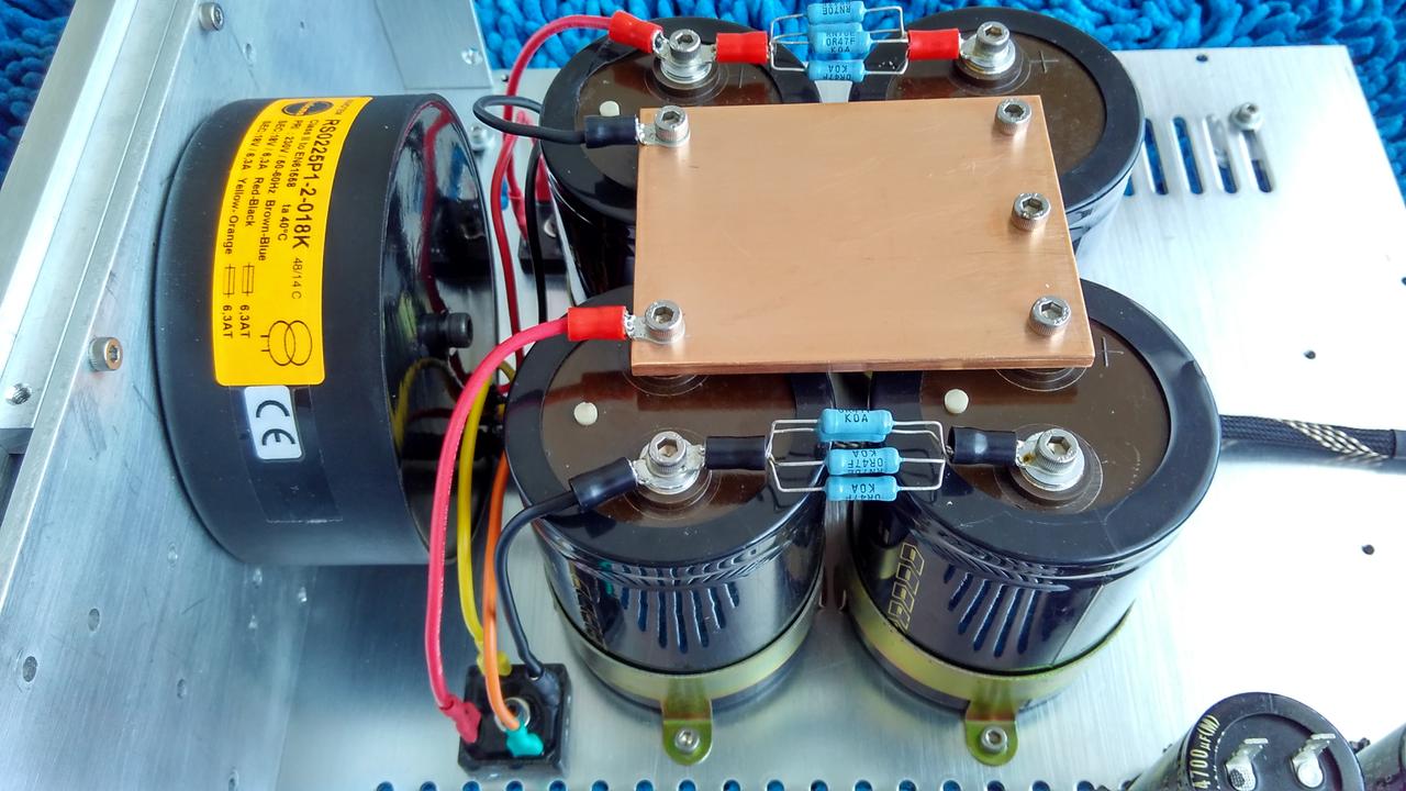

Both of those solutions have already been implemented and are still fitted to the components
Full - MuMetal box enclosure over the Edcor
Full - steel metal can DIY enclosure for the toroidal
Both methods did not work
Next option was to test the removal of the toroidal from the case before embarking on sourcing shielded replacements for the Edcor transformers if it did not work
Now that I have the answer to the problem was the toroidal I will enquire about a fully sealed at factory units

Check if Your two signal wires who go from RCA's are connected first directly to pcb audio signal IN and IN-G ?
Normaly two stranded together.
One more OUT-G wire point on the pcb who go to the black cold speaker connection
( stranded together with red wire from pcb audio OUT btw )
PSU-G go after that to your main earth star groud with the chassis
Is total of 2 psu wires ( V+,V - ) 3 ground wires ( IN-G, PSU-G, OUT-G ) 2 audio ( IN, OUT ) = 7 wires connected to one amp pcb.
All ok or find missing wires ?

I kinda tried that in a loose way, and while the toroidal was still housed in its can and it added a whistle to the hum

Yep all wiring is spot on and a few ways were tested
Eventualy settled for the minimalist star earth you see now
The only 2 things that worked was
1) Mr Pass asked for a specific earth test - it stopped the hum
2) Removing the toroidal from the chassis
The detective in me will ask
Why do most M2 builders have NIL or few easy to fix issues ?

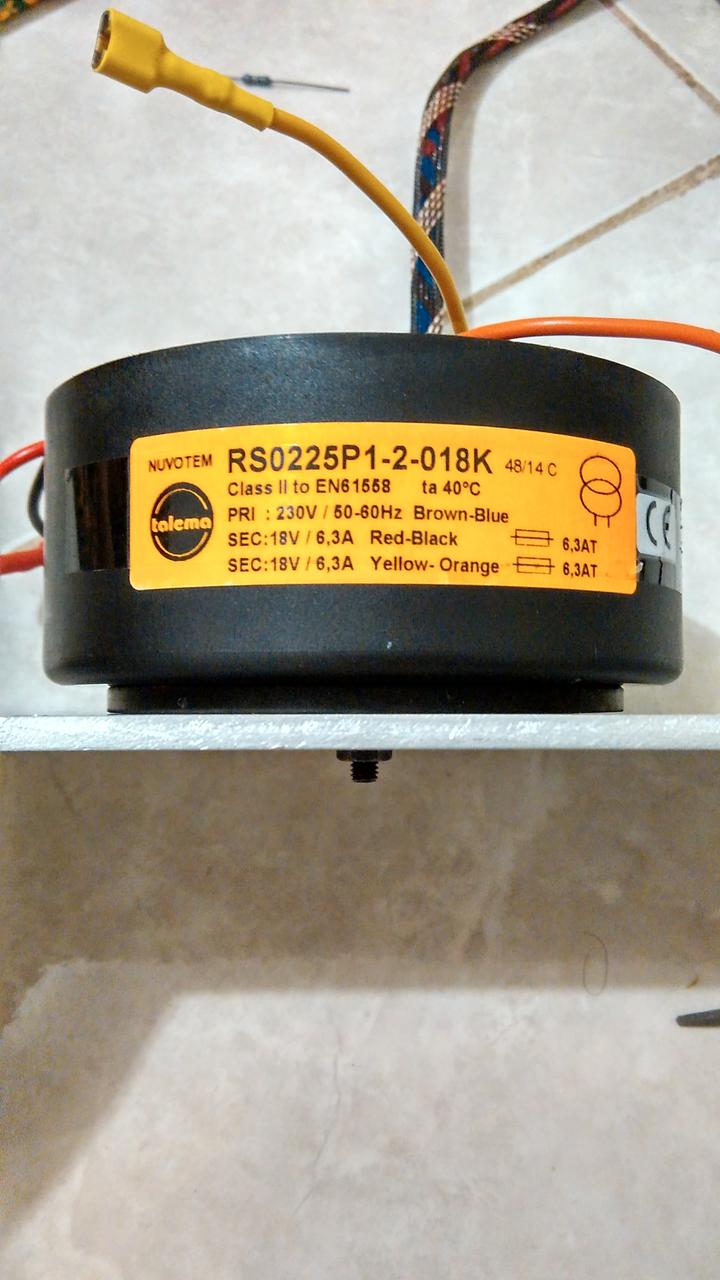

It's entirely possible that my toroidal is faulty or overly active in RF / EM emissions even though it was the Audio spec unit
So I'm searching for a Zero emission toroidal
Happy to be pointed in a makers / brand direction ( link )

Something I have always done on FW amps is to rotate the toroid +/-60 deg
in operation, as one position will give minimum noise. Usually there is a
lobe of radiation, and pointing it at (or away) from the right spot is a big help.

I don't know if it's zero emission, and not sure what shipping would run, but Antek makes a shielded 400VA/18 V torroid AS-4218
AS-4218 - 400VA 18V Transformer - AnTek Products Corp

I am in comunication with a local supplier for Noratel Transformers at the moment and working through the shielding options
Now that the toroidal is on long leads I can give it a try as a test and report back my findings
A few days ago the toroidal was tested standing upright on the side coils and a whistle was added to the hum
Tricky little buggers these toroidal's

Update
Tested the toroidal in all manner of positions including upside down
Always hum produced
Think I have a rouge or possessed toroidal 🙂
On a positive note I am just about to place an order for a Noratel toroidal as used by Pass Labs and others but have also ordered it with a can just in case
