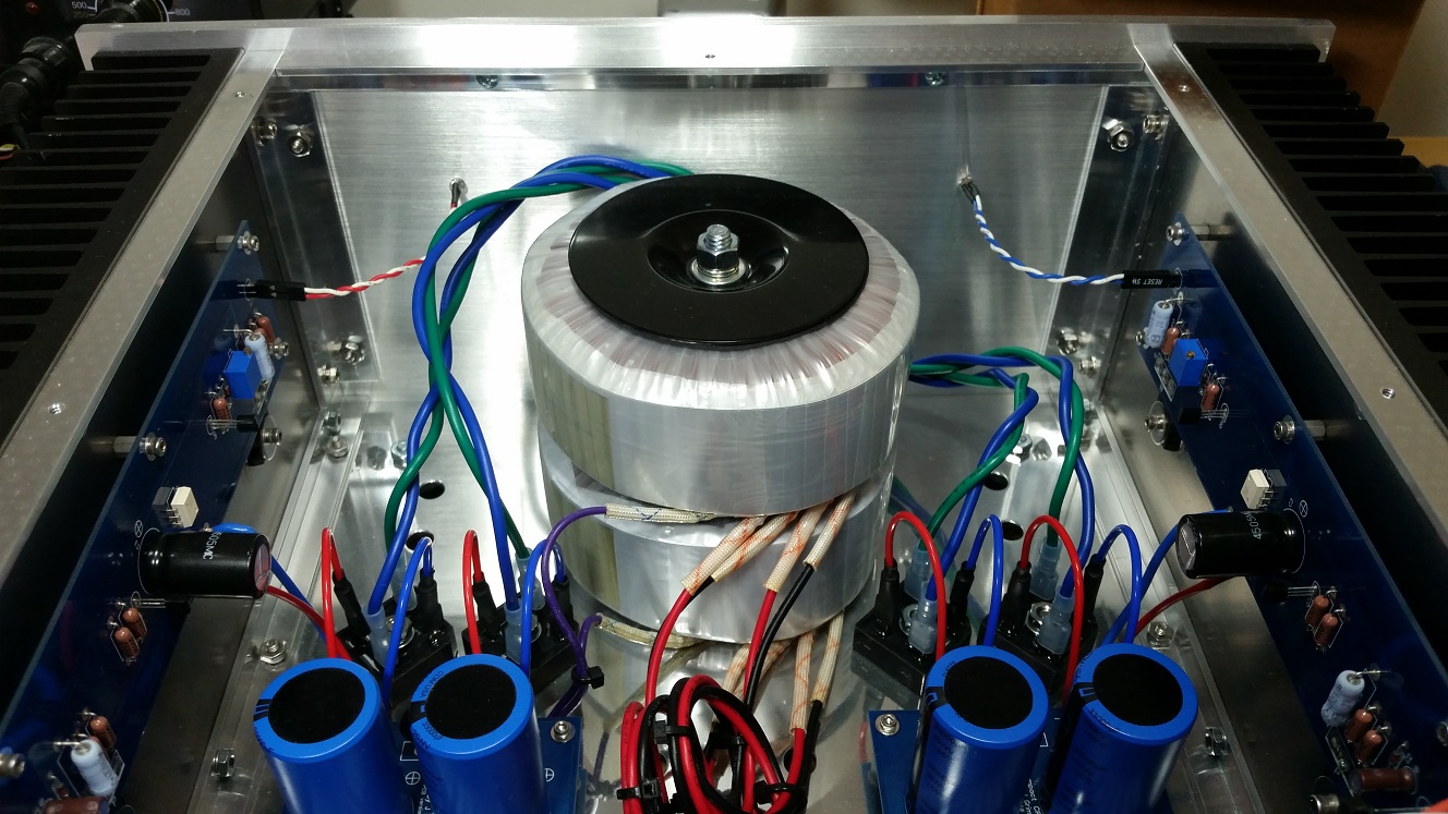

Hi Ronnie,
I used the 400mm in my M2 build, I found I needed the extra length to fit everything in without any drama. I used the DIY psu and a 400va transformer a D there wasn't a lot of room left. I also used Grimbdrg's boards which are longer than. Teabag's and I needed the length.
Paul

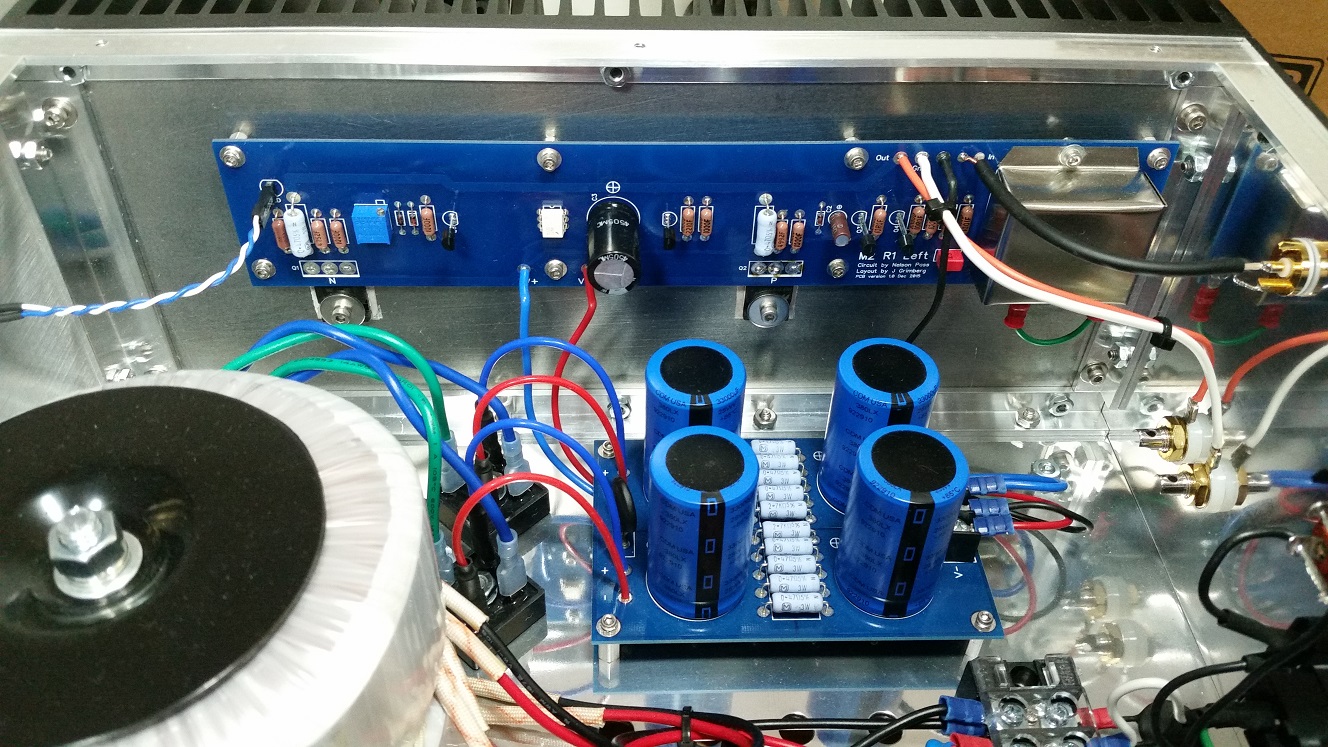

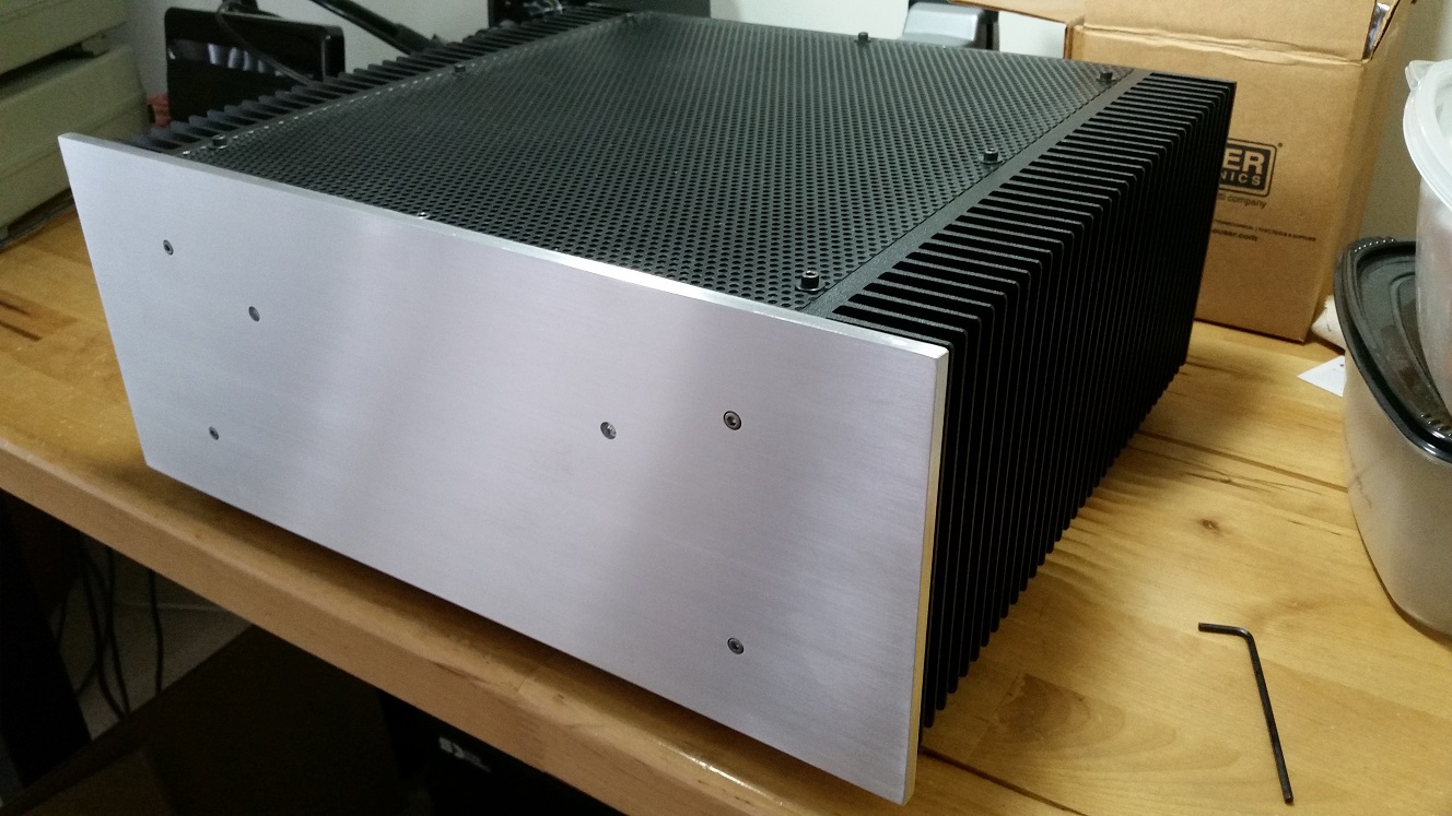

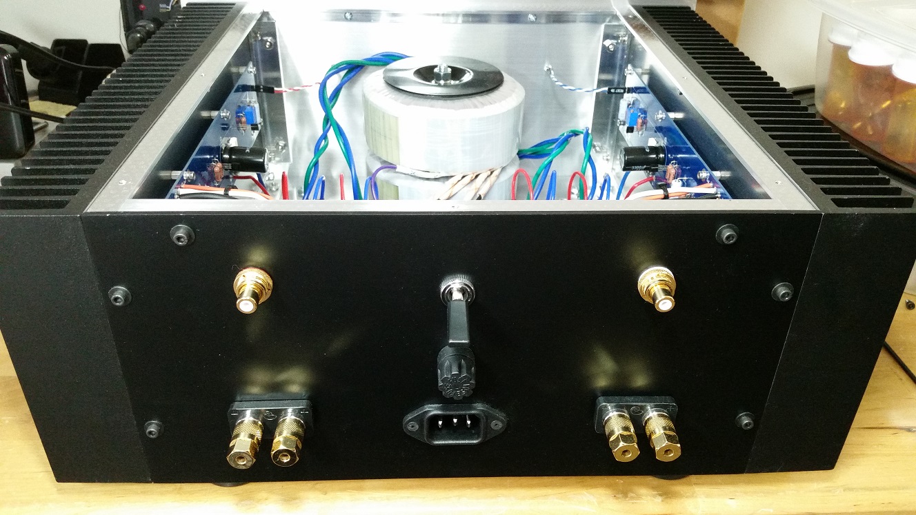

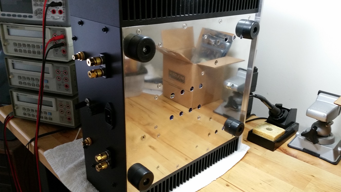

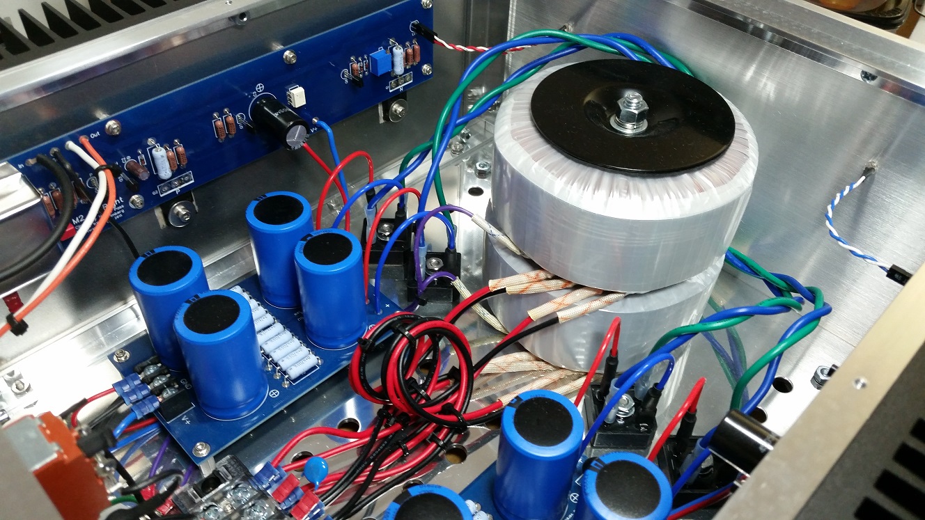

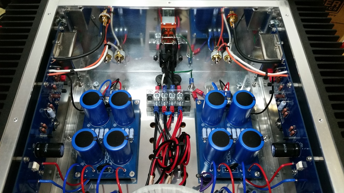

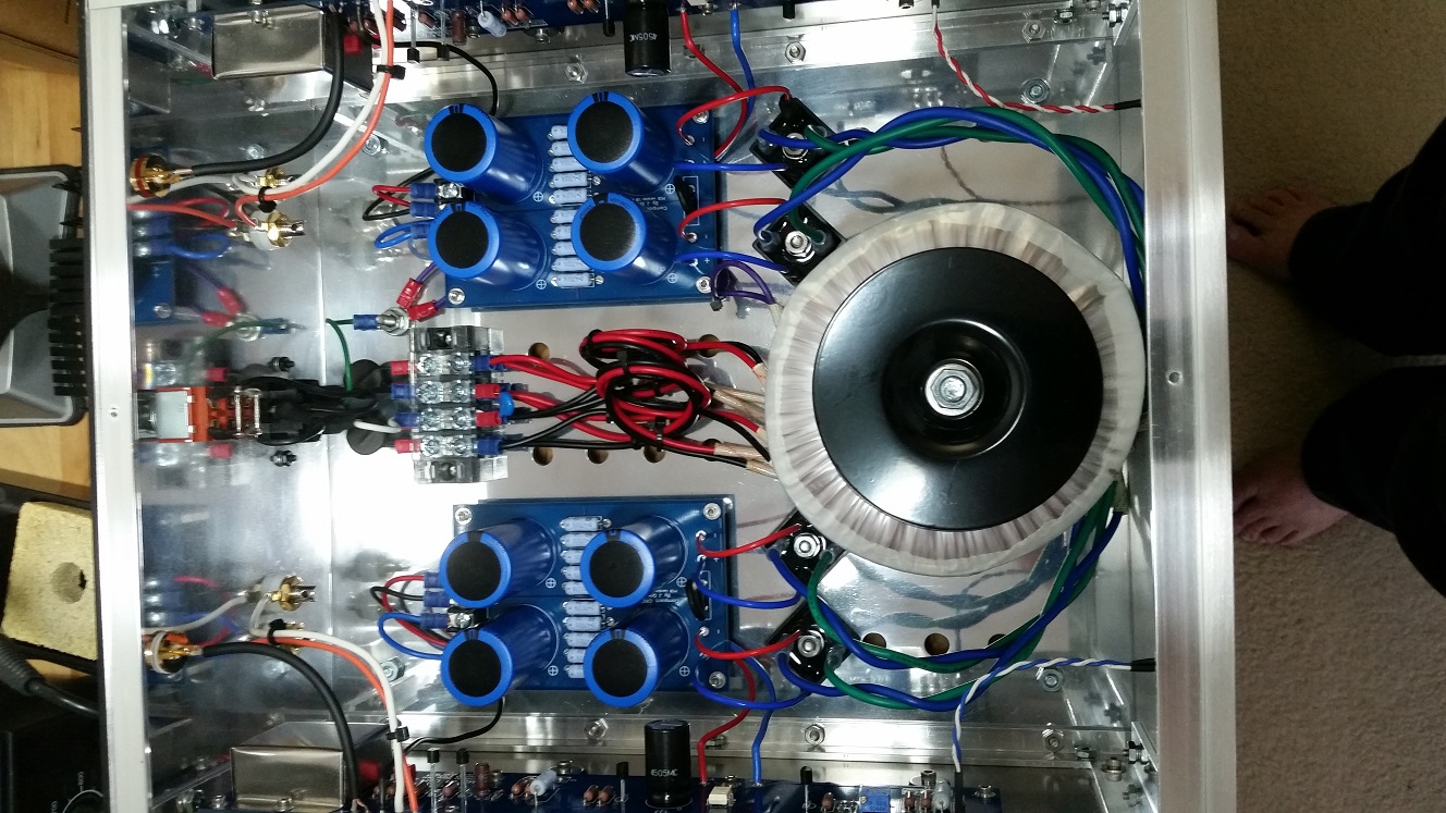

I also used Grimberg's PCBs 😀 and individual power supplies for each channel, all assembled in a hand crafted case. The internal dimensions are: 11.75" width x 13.62" length x 5.87" height (298 mm x 346 mm x 149 mm).
Here are some pictures which may help you.

I know you guys enjoy porn, but decorum demands at least one picture that does not display the intimate parts. Here it is. 🙂
Also notice how good the bottom plate looks with all screws flush, except for the transformers' bolt.

Hi Ronnie,
Paul
Thanks for your inputs!
I'm not worried about room per se, which can mostly be solved some how. I'm more worried about other problems, like interference leading to humming. But I realize there is no definite answer to that question.
That IS a beautiful case, and build, Grimberg! I wonder about your looped leads. Have you done it like that just keep them long, or is there any other reason?
//Ronny
I always keep the leads initially long in case I have to rotate the transformer to reduce induced noise. In the case of the M2, the first time I started the amplifier after the whole case was assembled, it was absolutely quiet. I decided to just leave the long leads tidy with the help of zip ties.
Regarding the humming noise, many people reported successful builds using either the PCBs I or Tea-bag designed. Only one person complained about persistent hum. Incidentally that is also the person who did not assemble the PCB himself and claimed to be sure that all wiring and mechanical assembly were absolutely correct. That may be the case, but the noise is still present.
In my view resolving a problem must start with the right attitude. Assuming that the problem is restricted to one area, without systematically probing all others, is not a positive approach to problem solving.
To improve your chances of success, start one channel, adjust it and listen to it. Do the same with the other. Next, connect both channels and, if you are using a single PSU, adjust both again because of the voltage drop, and listen to them. At that point, if you have an issue it will manifest itself. Noise? Go back and locate which step caused it. Satisfied? Move the parts to their approximate final location. It is easy to do with a hifi2000 case or a custom built one like mine. Move the heat sinks next to the bottom and back plates, so all the parts look almost as if the case is fully assembled. If necessary, use books to prop up the back panel. In my experience, if at that point the amplifier sounds as expected, you can safely finish your assembly and pour the wine in the decanter. 🙂
No mystery or secret rituals, just common sense.

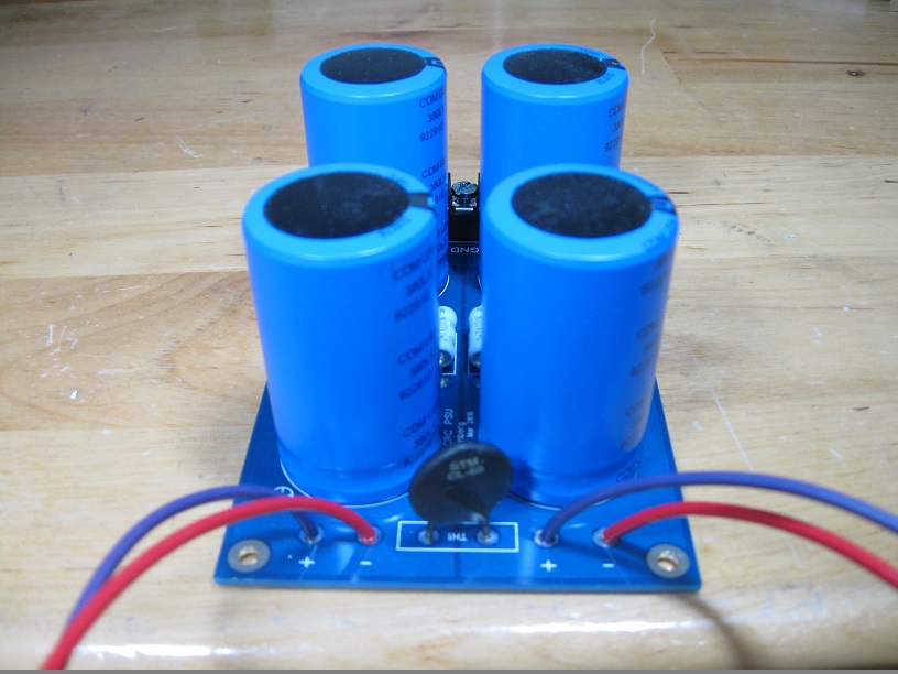

Dennis,
The board layout is my design. The schematic is just a regular CRC PSU.
I wanted to fit two boards in a case to have separate PSUs for each channel. I use four capacitors of 33mF each. I also added the thermistor to the PCB and connected one of its leads to the four mounting holes.

Dennis,
Thanks for the details.
BTW, what do you use to separate the transformers when you stack them
together? I'm may need to do that for a vfet2 build but am unsure what
works well in practice.
Thanks,
Dennis
