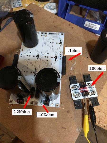

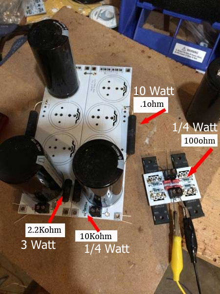

Official M2 schematic
do I have the correct values for the resistors labeled here?

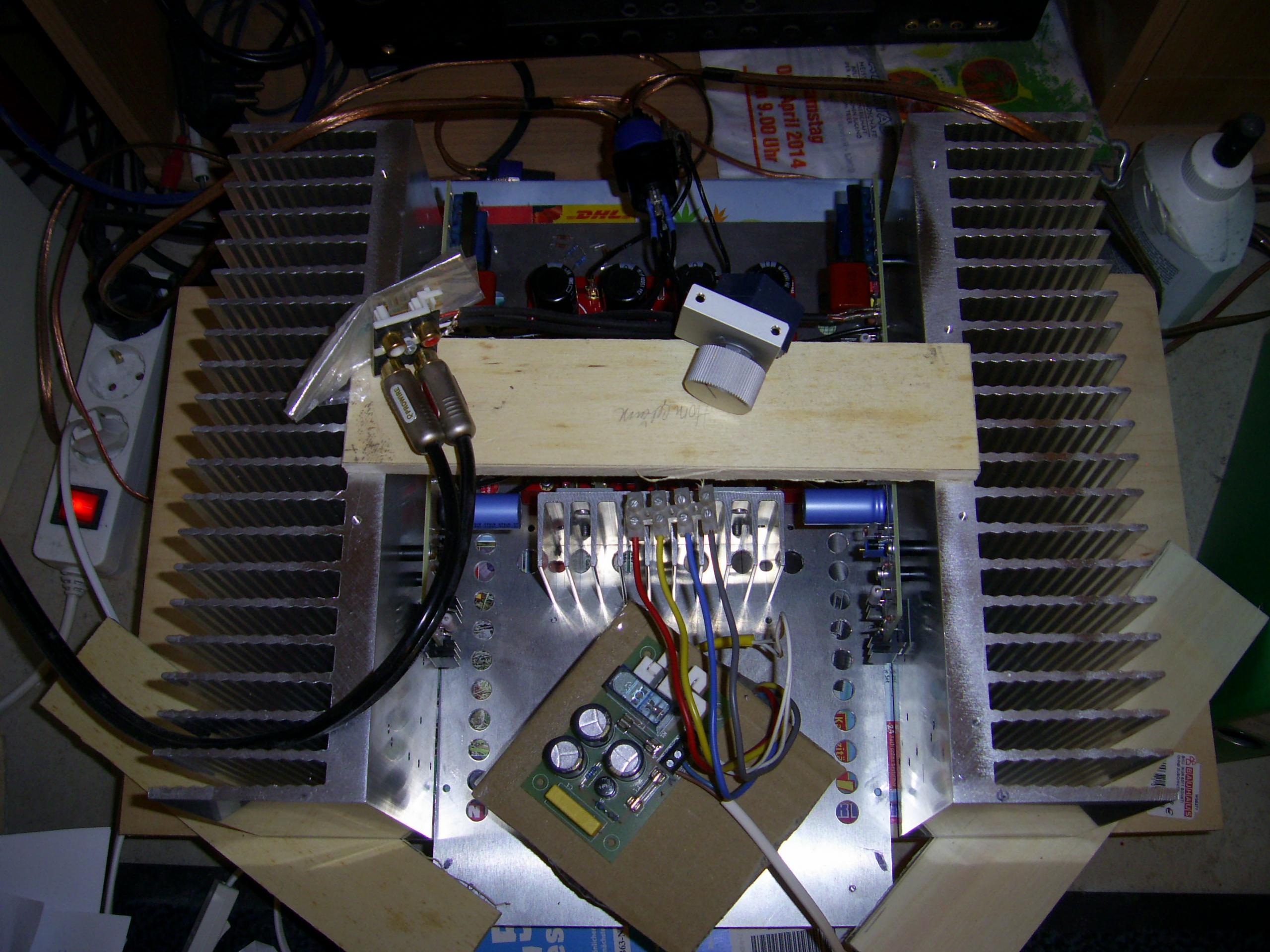

M2 is singing
Hi All.
with M2 every day is Xmas
There is only to say: it's true!
Big Thanks for all given Tipps by members here, for Teabags quality UMS- Boards.
To use my big heat sinks i have to send first the Aleph J in vacancy 😛.

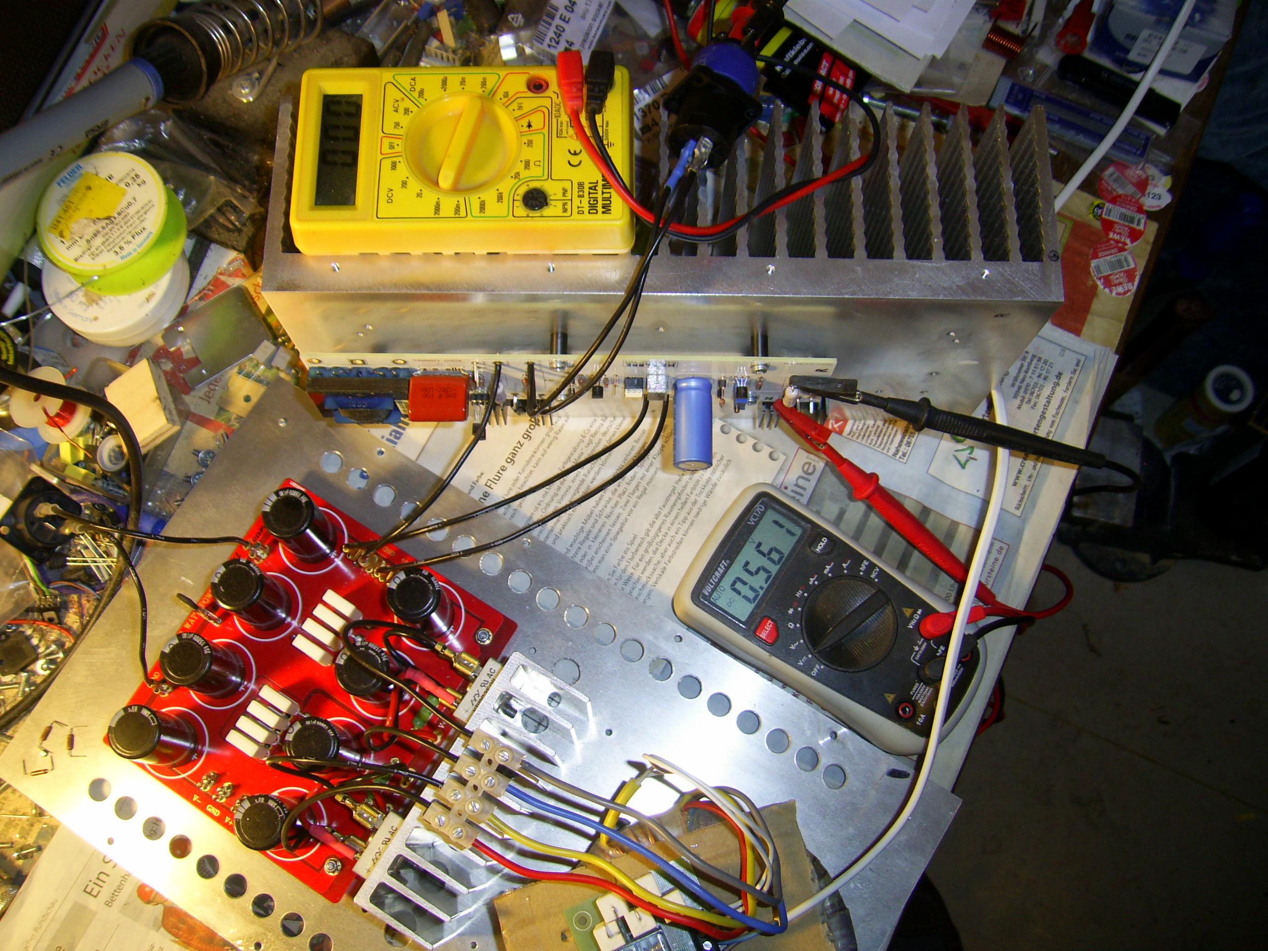

With all advices careful reading i could lucky set up the M2 with the Toshibas
SJ201; SK1530.
The modification to 0,33 Ohm Degeneration and without 221 Ohm works from
first switch ON in stable 560mV.
With Offset i have tried 3 times, because negativ offset; first change- one site 47k to 53,6k was to much; second change 53,6k to 56k works perfect on
both Channels to zeroing offset.
Time to listen music. 🙂 😛.
After any days, burning in:
So much impressed with clarity, smooth brilliant tonality, wide open image.
The dynamic jumps are impressing me too- there is not all quit flat presented since digitally possibilities.
I only have to rework for better cooling the Transistors- for my opinion 70°C
or more is a bit to hot- seems i'm a bit scary. 😀
Next step is to spend creativity for real nice case.
Now i know why ZM is falling in love for M2.
Yes, only to say Thank you very much Mr. Nelson Pass- awesome Genius!
Because that i understand a bit more the way it comes to DEF- Amp topology.
Begin was any years earlier, i know.
