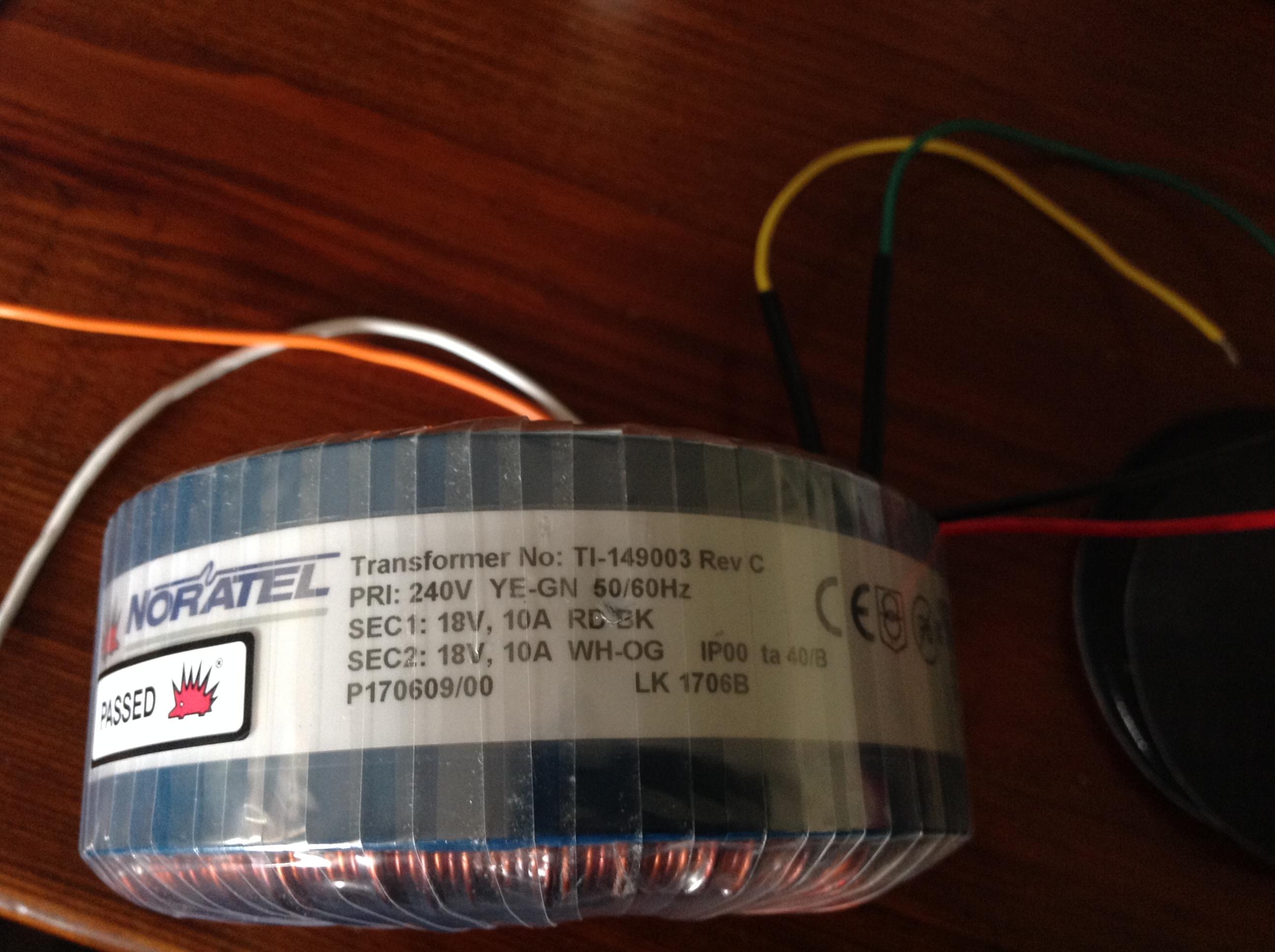

As I'm in Australia I sourced a proper 240V unit from the local distributor
The distributor is called RF Waves
The owner has built an F5

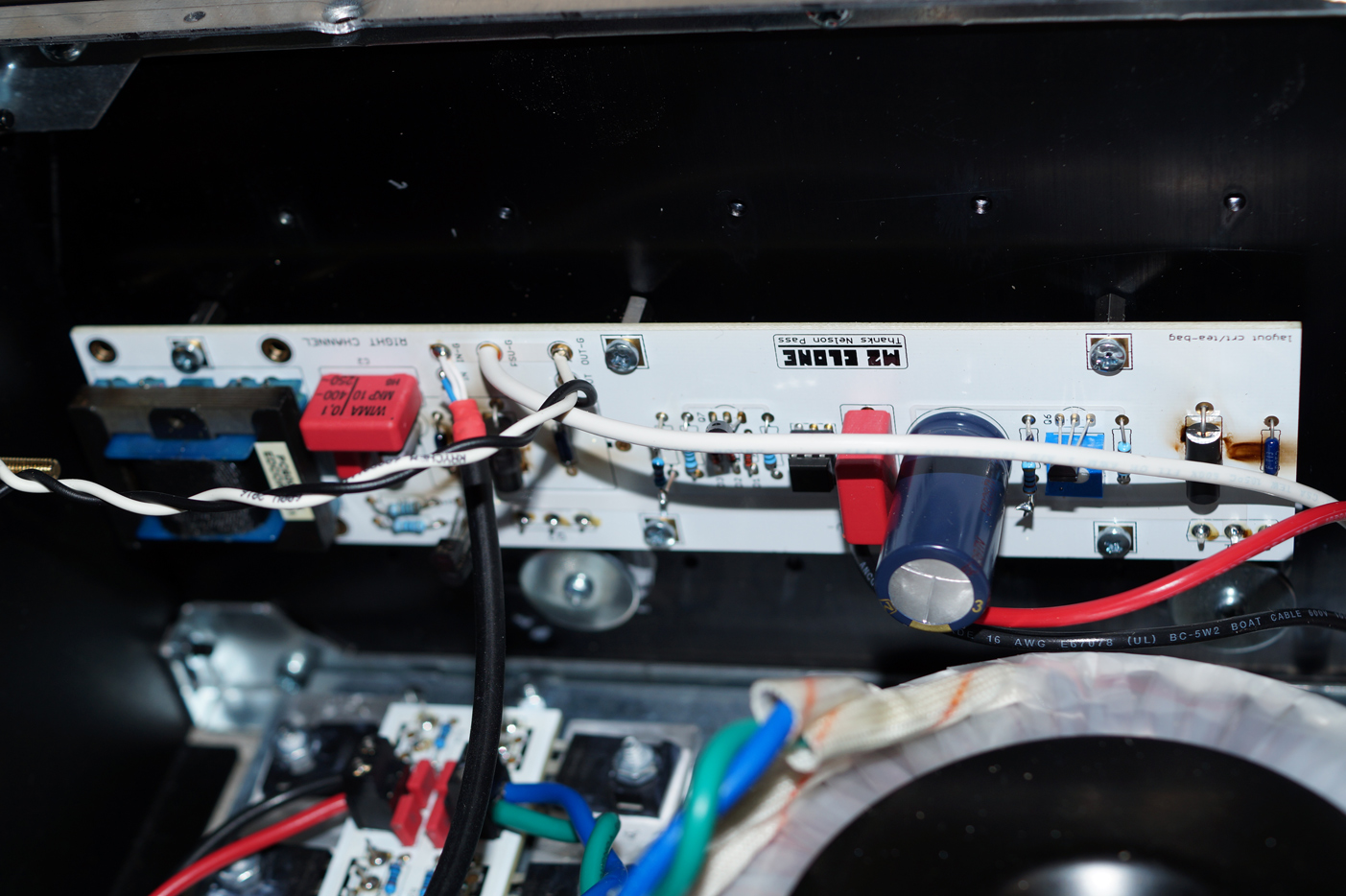

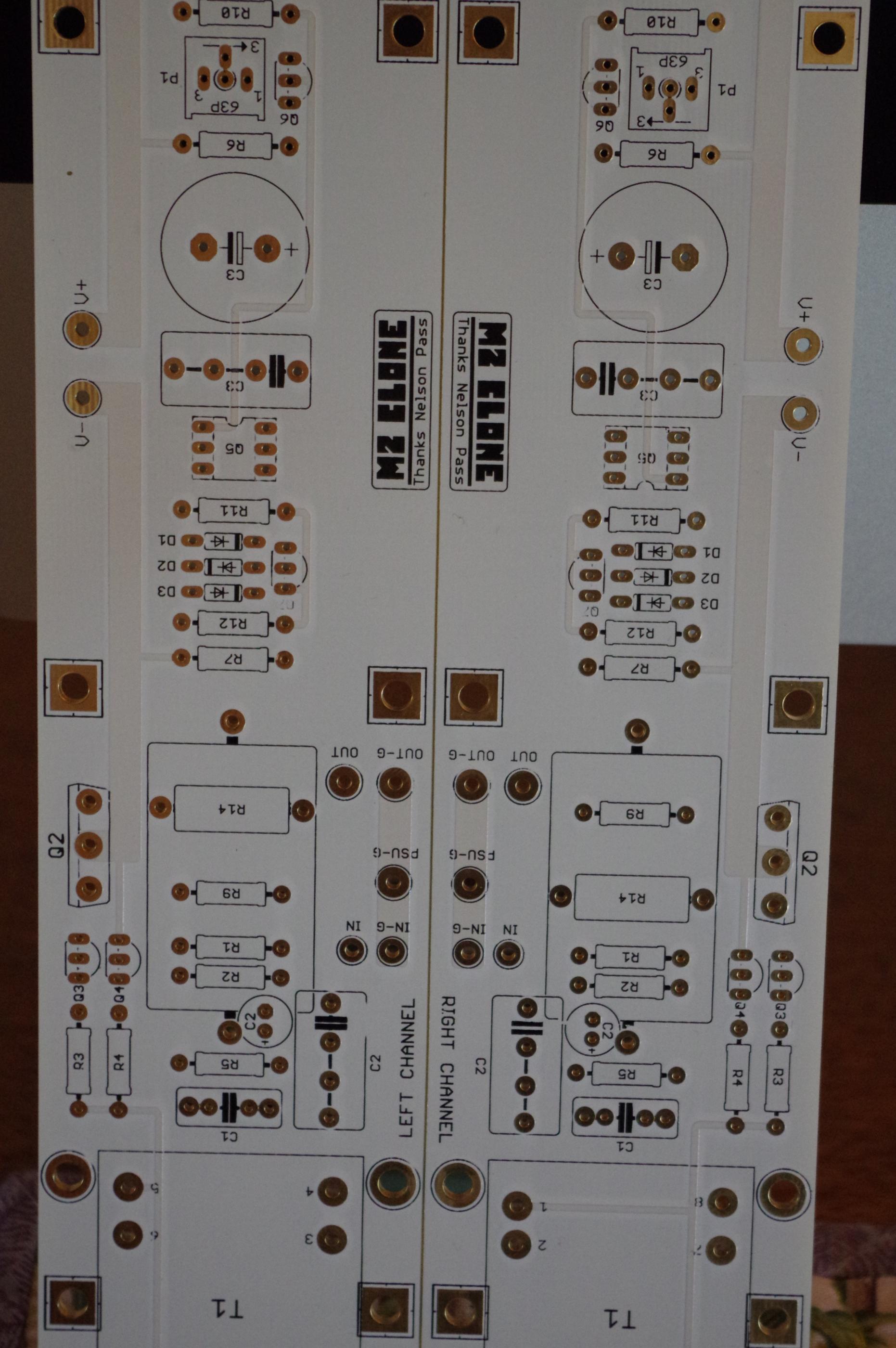

Well, I managed to kill my M2 build. The power supply tested good at 25v on each side. I mounted the amp boards to the heatsinks on the Dissipante 4U. Plugged it in with the test meter on DC volts hooked to the speaker connections on the right channel. The voltage read out climbed to over 19V and then pop both of the large resistors blew on the right channel, who knows what else died in the process.
I disconnected the power from the right channel and plugged the amp back in. But this time only momentarily touched the meter to the left speaker wires. It too climbed quickly and I removed the meter probes but no pop or smoke. The left heatsinks got warm as normal. I plugged a cheap speaker and music signal into that side and all I got is a good hum sound. I unplugged it before I did anymore expensive damage.
What would cause that high of DC voltage on the speaker outs. I don't see how the meter could have killed it which I guess would mean the left and right side have different issues then.
I used Thermaltak TG-7 on the mosfets along with these pads. I didn't think to check last night to make sure the TG-7 wasn't electronically conductive. Would shorting the mosfets to ground cause an issue like that?

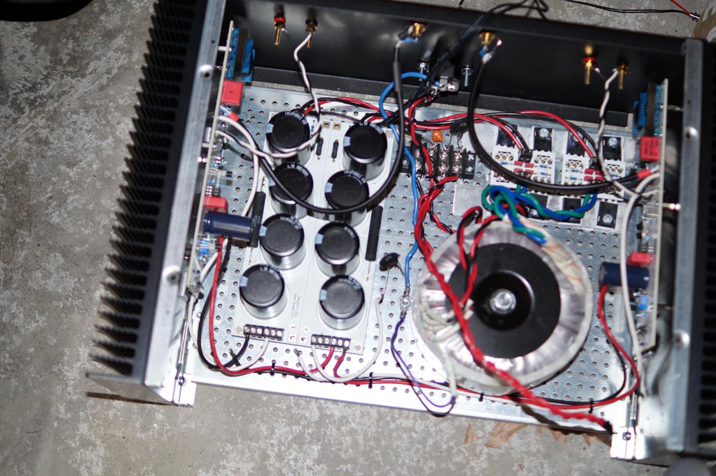

Nothing is visually cooked or looking like it is overheating in the other channel and it was powered up for a minute or so just no audio other than a light background hum through it. The mosfets in that channel seem to be warming to a normal level like there is power to them. And the sound out of the speaker sounds like an amp running at full volume with a wire picking up a hum and no signal attached.
wiring , especially PSU rails to pcb ?
you didn't mix-up output mosfets ?
orientation of optocoupler ?
polarity of clamping diodes ?
resistor placement/value ?
mosfets well isolated from htsnk ?
plenty of things to check
so ,what's your plan to check and what to change anyway ?
Unscrew the washers over the mosfets to make sure they are in the right place.

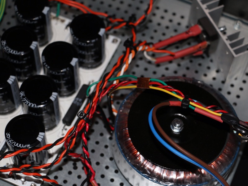

I checked the wiring from the PSU to the PCB last night but since I also double checked the orientation of the optocoupler before I installed it I'd say all the prior work is in question so I'll retrace the wiring.
I can see the diodes in some of my other pictures and they are correct.
Check the thermal paste and make sure it isn't conducting any current.
Double check the resistor values and placements.
If everything else checks out reverse the optocoupler and cross my fingers that the one channel works.
Then I have to figure out what all I killed on the other board and order replacements. Hopefully it is just the resistors and output mosfets

Before you undo your mosfet bolts, check each pin with your DMM to make sure there is no connectivity from any of the three pins to the heatsink.

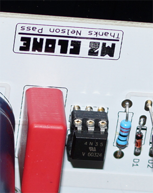

well, it looks like first mistake is the optocoupler is in wrong
shows the dot (next to the V) going towards the resistor not the capacitor

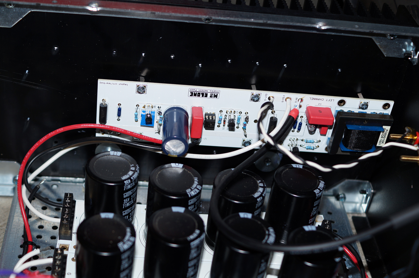

The top photo is the right hand channel but i think the thumbnail is showing the left hand channel.
