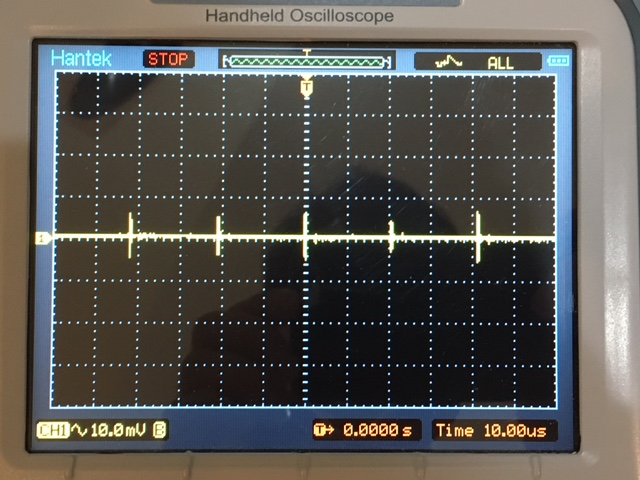

Here is what PSU output after CRC looks like. 10mV vertical and 10uS horizontal. There is 10mV spikes at circa 50kHz frequency. Probably mains contaminated with a SMPS somewhere.
Fairly clean PSU as far as linear PSU's go. At millisecond scale it shows 20mV 60Hz ripple under load of 1.3amps in each channel. No load the ripple is about 6mV.

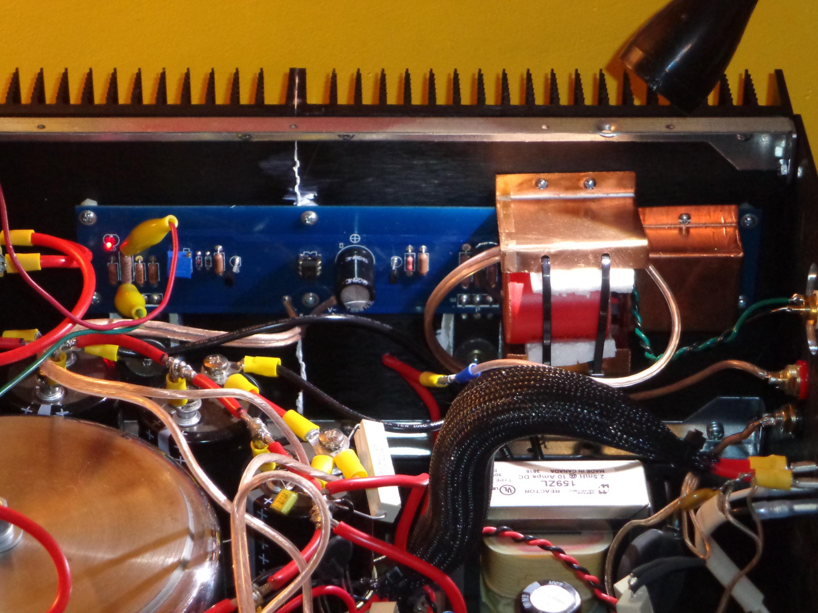

I put a steel shield around the power transformer (literally a saucepan) and copper boxes on the little transformers (not mu metal but it was all I had) and I have no hum at all. Pics at post #1279.

Was there hum without the saucepan and Cu-metal shields?

Something I have always done on FW amps is to rotate the toroid +/-60 deg
in operation, as one position will give minimum noise. Usually there is a
lobe of radiation, and pointing it at (or away) from the right spot is a big help.
I believe Mr. Pass is referencing rotation on axis such as that the toroid was a wheel. You can see an example of how one of his production units was rotated, but it sounds like each toroid will be unit for its "lobe" location.
My power and signal trafos are about in same exact places as yours. If that is a DIYA Dissipante 5U case, then same case as mine.
Didn't try it without the shields - they were the plan from the beginning. My case is a 4U case direct from modushop in Italy. Cheaper that way, though I had to drill it myself (Grimberg's boards didn't fit the universal mounting spec anyway).
