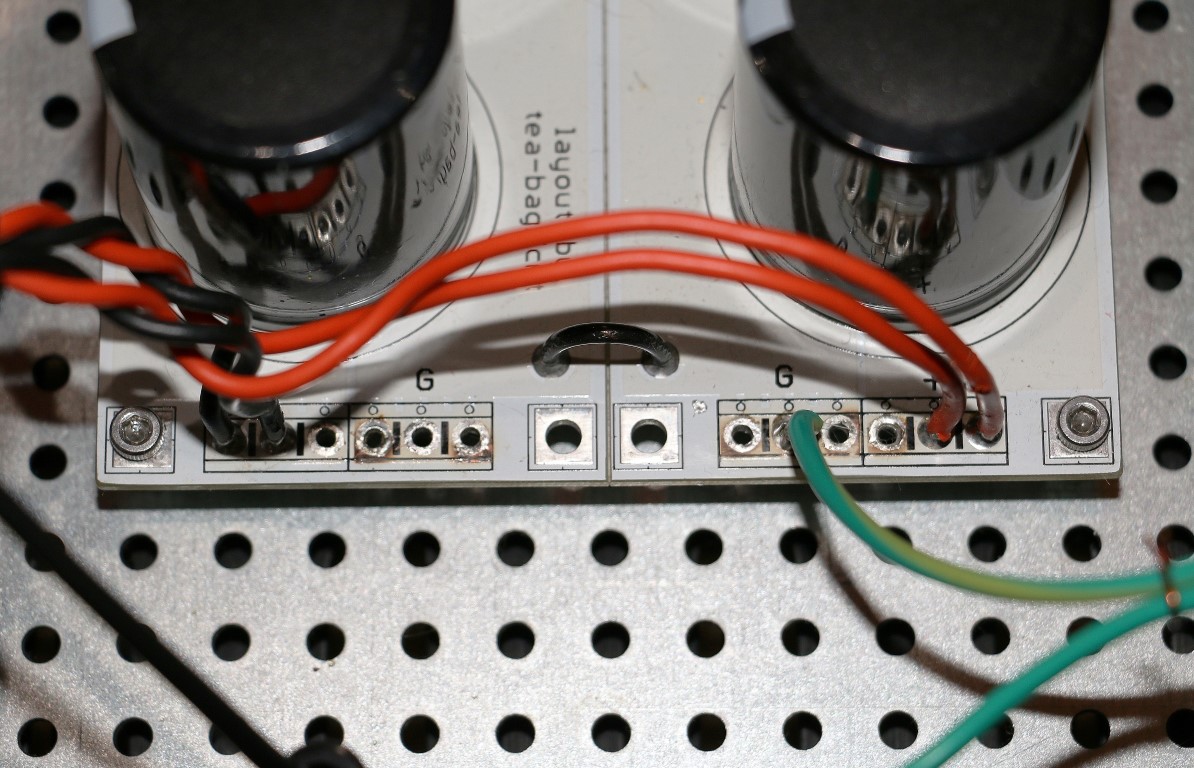

which C bank pcb is that ?
unscrew it , give us picture of copper side , mark all wire points
Did you jumper the grounds together on the boards?

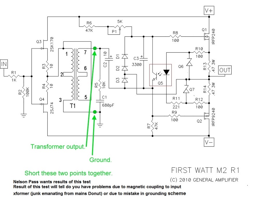

Also, for FR's humming problem, what happens when you short the output
of the transformer to ground?

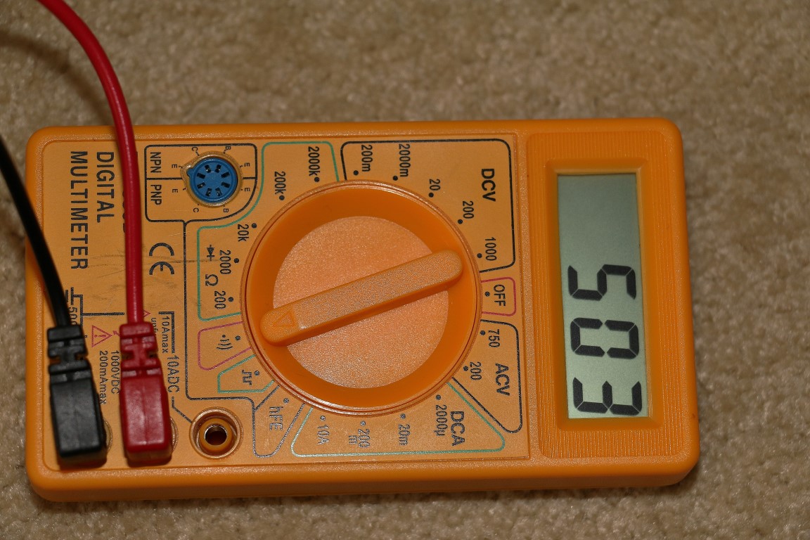

Test 1 - while toroidal is connected to the Bridge rectifier and earth
The Right channel shows a steady 445 on both AC output wires
The Left channel shows a slowly rising number that stops at 503 on both AC output wires
Test 2 - free cable of toroidal to earth ( not connected to bridge rectifier )
The Right channel shows a steady 473 on both AC output wires
The Left channel shows a slowly rising number that stops at 530 on both AC output wires
FR
Tea Bag PSU
Sorry no time to pull it apart ZM as I am on 24 hr call, and the phone wont stop ringing 😱
However here is closeup of the wire entry points and the jumper cable to join the 2 boards together ( hope that is enough )
FR

You set the DMM to buzzer/diode tester. The display then shows the forward voltage drop at a test voltage of a few volts. This DMM can not measure AC ripple in the range you need.
I am sure Nelson referred to the audio transformer output to be shorted, not the mains transformer.
What is your output DC?
FR
Now I feel like a Dodo 😱

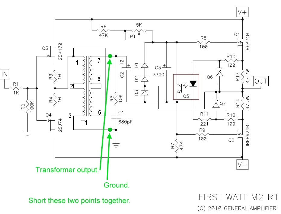

I think Nelson wanted me to test this ( see drawing ) a little late I know but hopefully redeemed myself 😎
FR
that picture (post @1725) is not enough , because I'm not familiar with that pcb and we need to see traces (if possible ) to figure did you got gnd take-in and take-out from proper place
yes , Pa meant exactly that , result of that test will tell do you have problems due to magnetic coupling to input xformer (junk emanating from mains Donut) or due to mistake in grounding scheme

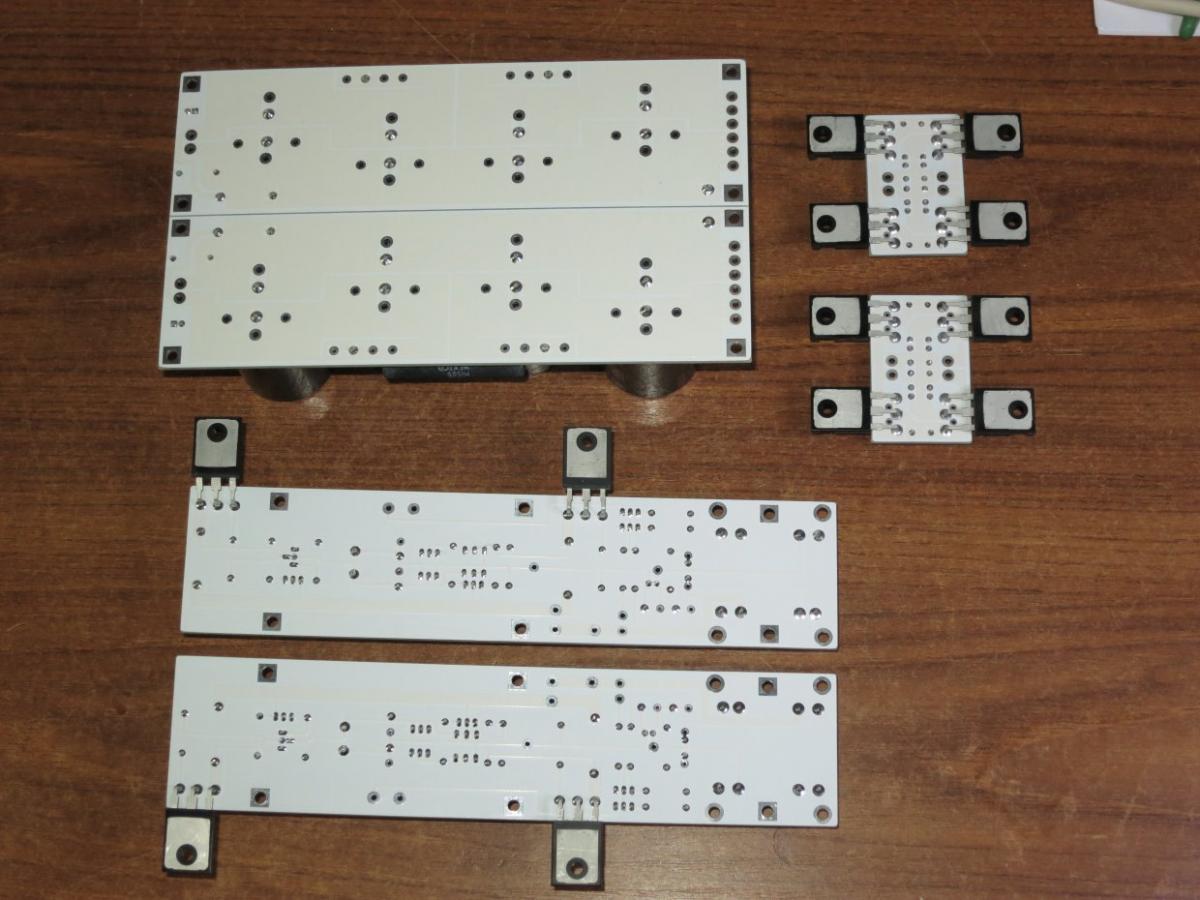

You are in luck
I have a photo from the start of the build
However I don't think you can see much of the trace
FR
FR
Mr Pass & ZM
I visited the technician today and I asked him to do this test ( as per drawing )
And I have an answer
The Hum STOPPED

The Hum STOPPED
which means that hum is magnetically induced in input xformers
next step/test - move toroids from case ; if hum is gone and amp sings ...... you need plenty of screening (both input and mains xformer) ...... or even moving Donut to separate box , in case it is too stubborn
