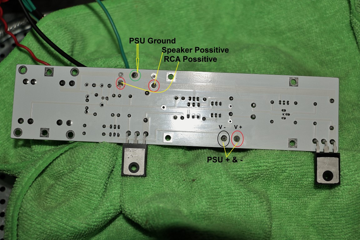

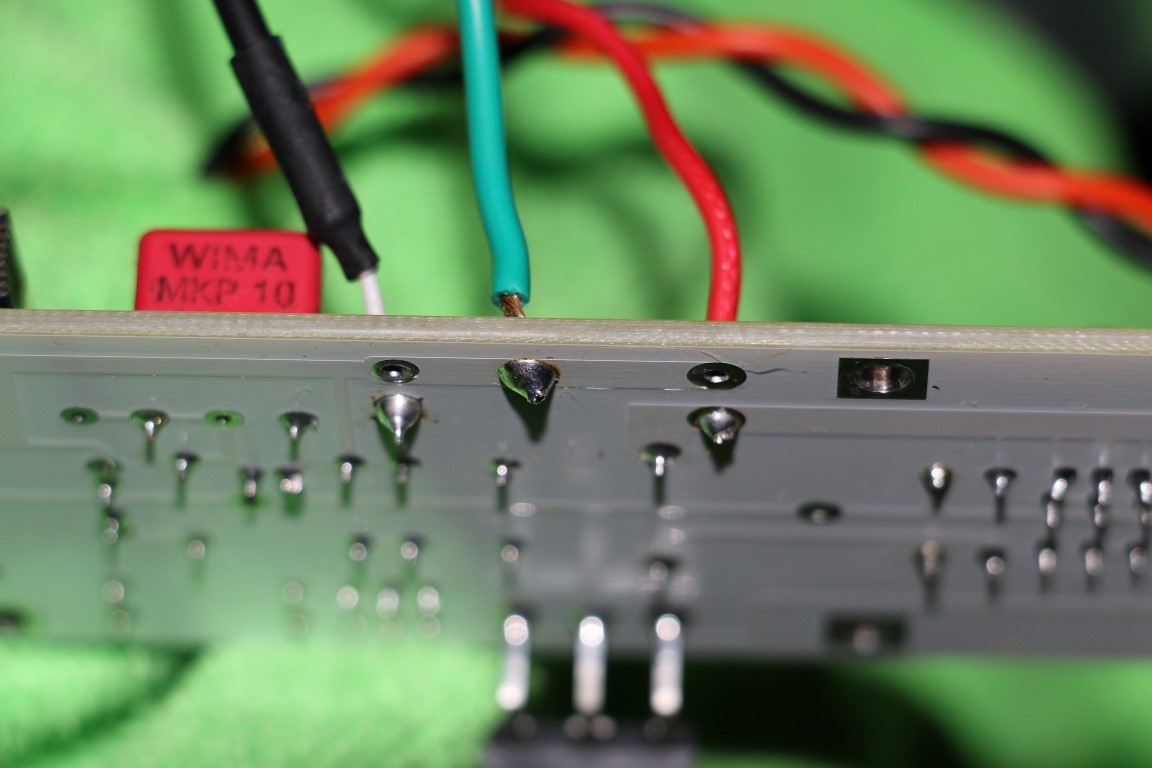

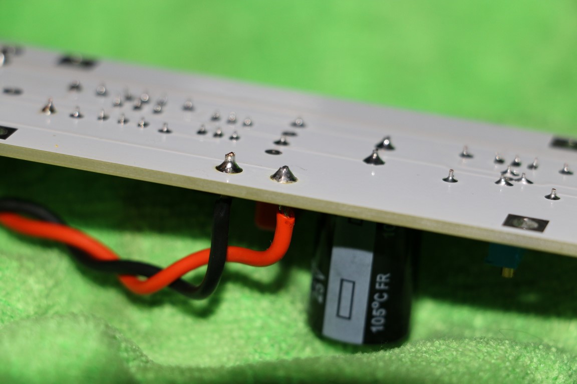

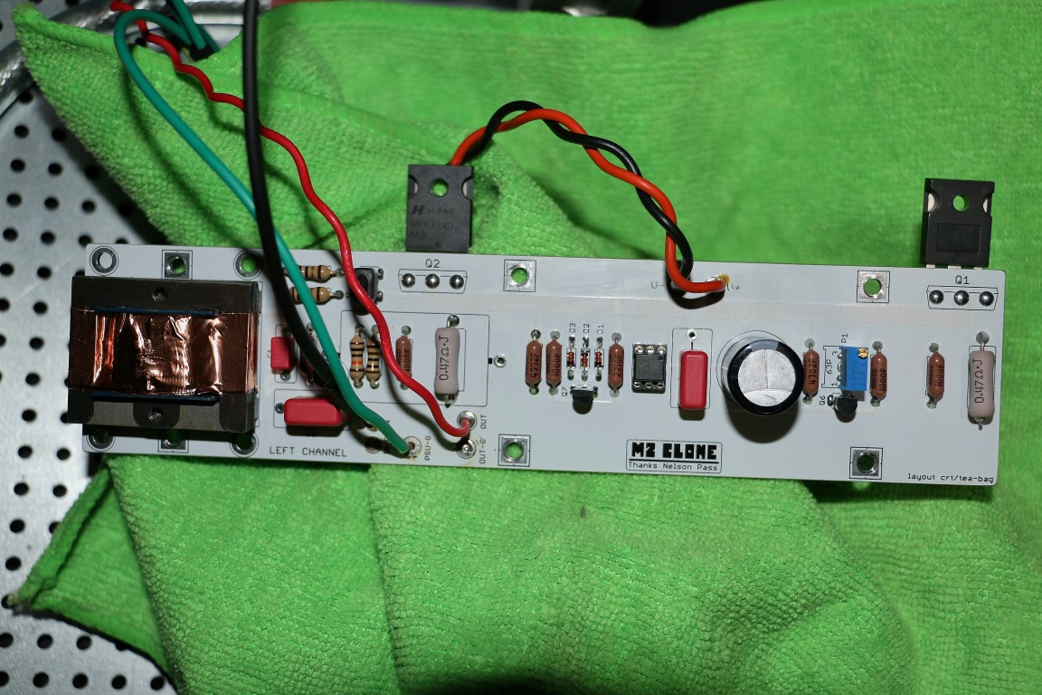

which C bank pcb is that ?
unscrew it , give us picture of copper side , mark all wire points
Photos as requested Zen Mod
Views are Top, Underside with marked wire points, a couple of side views to see solder

those are Tea-bag's , I'm not suspicious about them
I asked for PSU (C bank ) pcb ; is it also from Tea-bag ?
PSU is also from Tea Bag

I am with agreement with Zen. The problem is more than likely on the board somewhere. Everyone makes mistakes even professionals. At this point I do not believe the hum is in the wiring. I can feel for you because I know that you have been fighting this for many months now but there is a solution. My M2 is quite with my horns.
