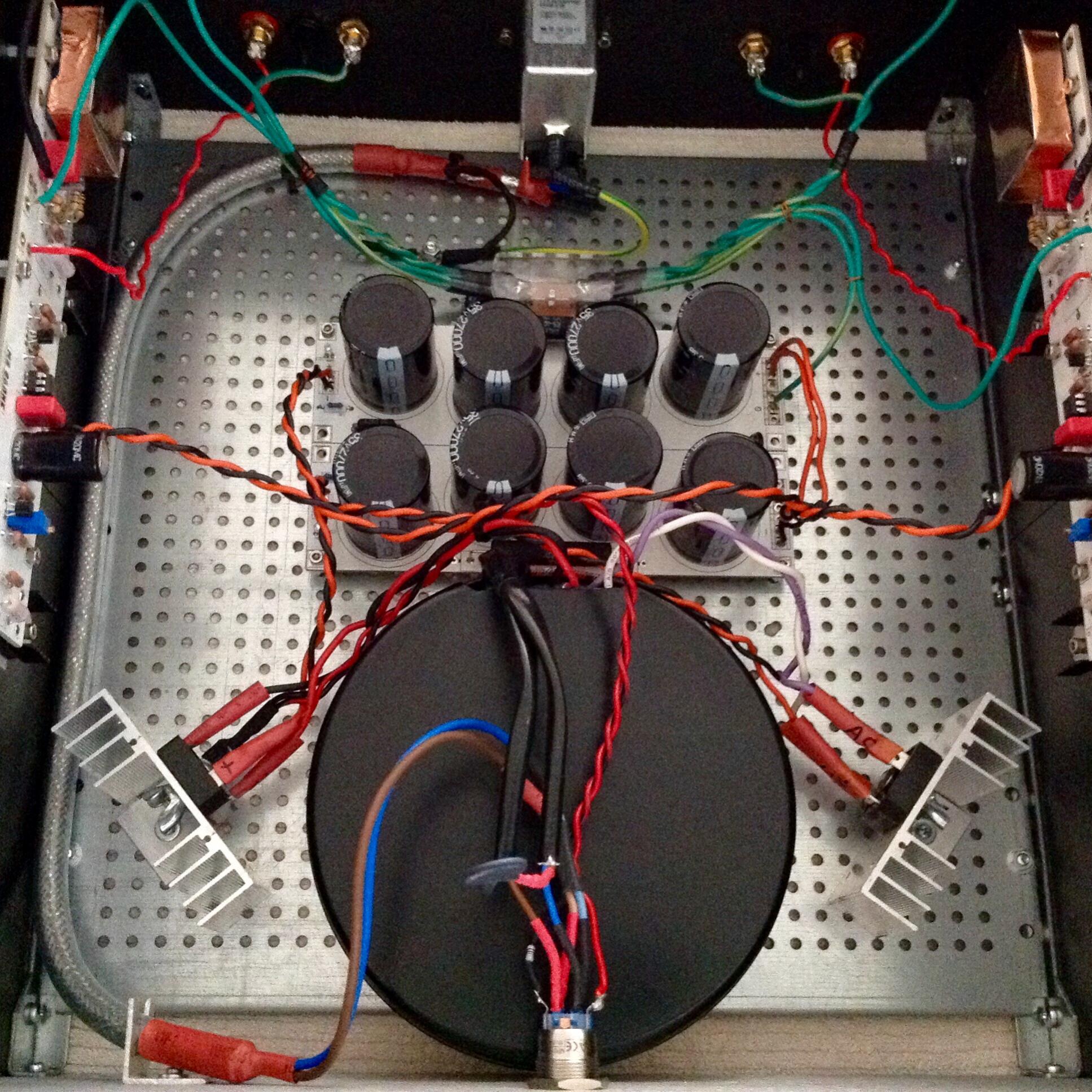

Update on the Humm issue
Today I had some spare time to work on the M2
Work has been consuming my energy slowly
Anyway I manufactured a torodial enclosure
It's very neat and tidy and I have affixed a band of copper foil around the circumstance as well

Testing for hum
Very little change
Next step is to swap over the JFets - but I lent out my soldering iron. 🙄

I am no expert here. Your grounding arrangement seems odd, I used Tea-bag's boards for my built, speaker binding posts positive and return back to the main board, capacitor board ground to main board ground, one end of cl-60 go to capacitor board's ground the other end go to chassis grounding bolt, power entry socket ground go to the chassis grounding bolt. That's how I wired my ground scheme, hope that help you tackle the hum.

Hi Sidney thanks for the input
That's how the M2 was wired previously and changed to the version you see today
However both ways produce Hum

Is it the same on both chanels? Your power chord runs very close to one side. Maybe you could try to center it?

Both channels affected
The power cord is fully insulated and shielded, it's a recent upgrade
And the previous cable was also possitioned in the centre

which C bank pcb is that ?
unscrew it , give us picture of copper side , mark all wire points
