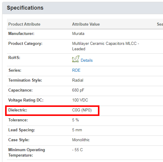

I use a ceramic capacitor with "C0G / NP0" dielectric, for C1 of the M2's RC terminator network (across the Edcor secondary), and I recommend it in the Bill Of Materials for the M2x clone of the M2. See the red box on the attachment below.
It is Mouser part number 81-RDE5C2A681J0K1H3B price is USD 0.41 qty=1.
C0G/NP0 is a Class 1 Ceramic, you can read more in the Wikipedia article about ceramic capacitors

Normally I wouldn't even think about using a ceramic cap in an audio circuit but would a ceramic cap be ok for C1 or do I really need to use a silver mica cap?
Why not use a film cap? There are many available from Digikey, Mouser etc. Polypropylene, Polystyrene etc.
Cheers
