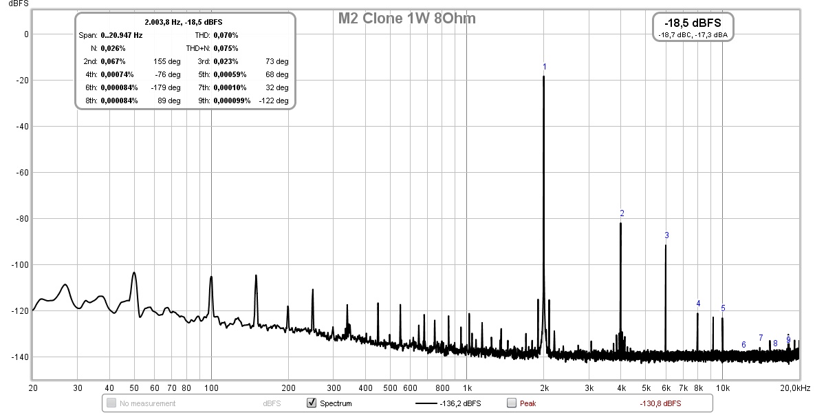

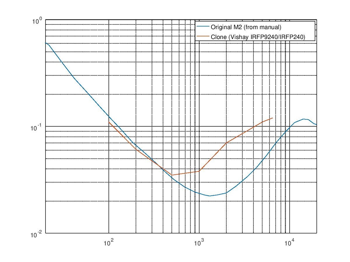

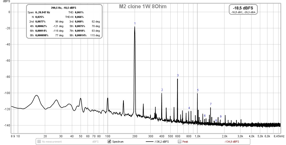

Distortion profile
I read Nelson's article "Practical Mosfet Testing for Audio" and several posts about the Transconductance shelving associated with Vishay IRFP9240. So I thought to finish the project properly I finally got around to check the distortion distribution of my M2 clone.
It is indeed 2nd order dominant at high frequencies, which is expected with the Vishay parts I think? The amp has quite a bit more distortion >500Hz than the original though. It still sounds fine to me 🙂.

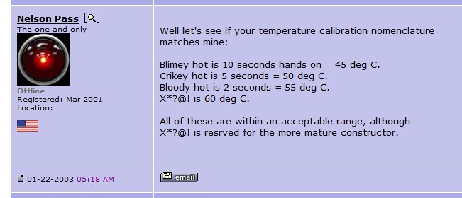

chimey hot, bloody hot or *'%!§ hot?
Hi Claas, thanks for pointing me to this thermal tool 🙂
I can't believe that my heat sink is only 45°C hot according to this statement.. If i would guess they are >50°C at the top (= not the hottest spot on the heatsink). Maybe my hands are a less sensitive 😛 looks like i need a more objective tool for measuring temperatures..
