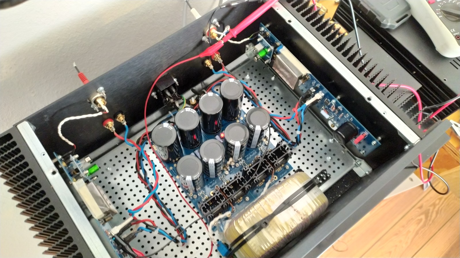

Thanks ZM and 6L6. I want to raise my idle current from 1,5A to 1,8A thats why i was looking for more temperature headroom. I really like the idea of the babysitter...
I think i will also implement one of the juma cap mx versions to make some space in my small case. See attached picture of actual configuration. I want to switch to a horizontal mounted canned toroydi.pl transformer but the diyaudio universal psu is too big or my case is too small..

I am using 2sk1529/2sj200 at the moment and most other users seemed to lower R13 and R14 to 0.22R or 0.33R (to be more beefy against heavy-to-drive loads like my 4-ohm speakers? But of course i can't explain why exactly). That would increase idle current to about 1.8A .

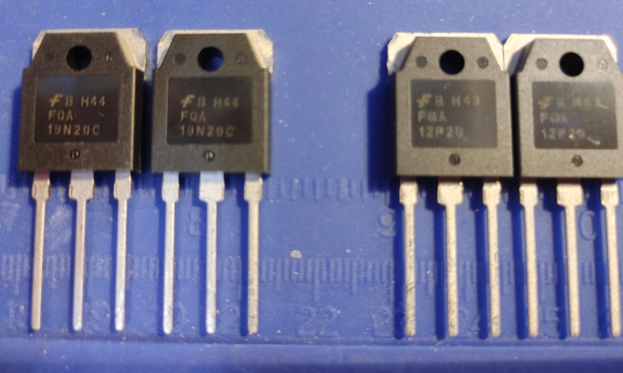

In the long term i also want to try the bigger brother 2sk1530 / 2SJ201 when i can afford them. Found some FQA19N20 / FQA12P20 also but i dont want to try them soon.
If i can find some IRFP9140 not made by Vishay or IR i would try and go back to "normal" configuration with recommended bias current. But I wasn't really satisfied using the Vishay IRFP240/9240 in the first place, the soundstage was too wide and mids and high a bit tamed (later i read about the funny frequency shelfing behaviour of some IRFP9240 devices, thats why i am looking for affordable Harris devices).
do not forget that cap multiplier is not saving you from heat - you're just taking heat from output transistors and putting the same in multiplier transistors
there is all another set of reasons for using cap-multy, decreasing heat sum is not one of them
yeah that makes sense, silly me.. To be able to mount a toroidy.pl transformer is a better reason, isn't it?
nothing to have with Donut brand - all of them being made in adequate voltage
first reason - to get cleaner rails to amp
second reason - have that Donut on the shelf, rails highish, have heatsinking enough, let's get cleaner rails and to use already paid xformer
that's it, in short
I am sorry for my bad english. The toroidy.pl thing was a kind of joke, it was about space and mounting position of the transformer. I would love to mount the transformer flat to the base plate instead of vertical.
Thank you for your reasonable answers. Between the lines i read
"if you want small heatsink take stock M2" and
"if you want to raise idle current (to use different output devices) aim for a bigger heatsink instead of a lower rail voltage"
Some say that those Toshibas sound very musical compared to the FQA or IRFP devices. And i want to learn and fiddle around. But of course it is also a good idea to try "stock" configuration one day. It's just hard to decide what to try next... thank you all for your ideas.
Thank you for your valuable advice, Claas. I will search for babysitter. If i remember correctly you are using 2SK1530/2SJ201 in your M2 @ about 1,8 A idle current. What size of case are you using? Are your heatsinks very hot?
With ~23V rail voltage and a measured idle current of about 1,5 A my heatsinks are getting very hot, but i can press my hands on them for minutes before it starts to hurt.
