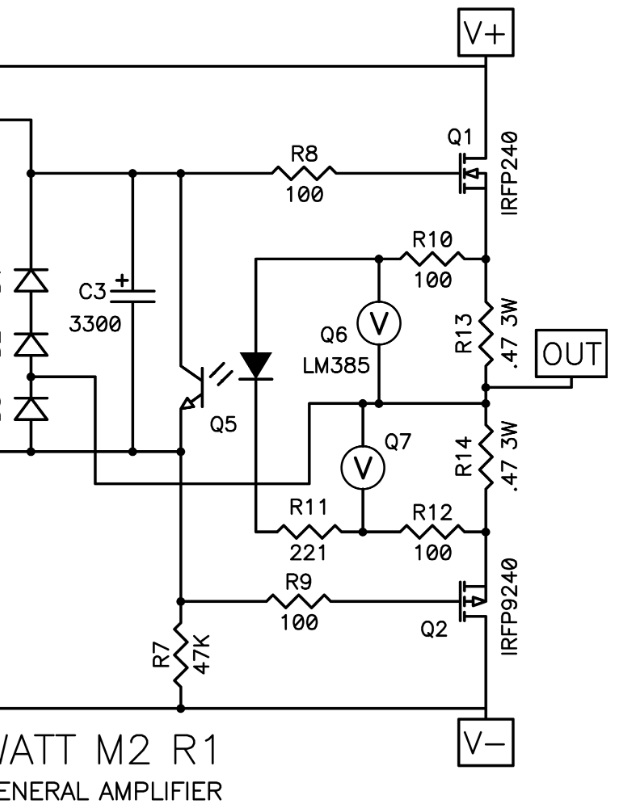

shouldn't 2 1n4148 in series clamp the voltage to 1.2v in the same way to the LM385Z-1.2 ?
What is the advantage of LM385Z-1.2?

I have all parts except these exotic LM385Z-1.2 and would like to avoid an order to mouser only for this piece
what is the characteristic of the LM385Z-1.2 that makes it mandatory? steep conduction curve compared to normal diode?

Could-I use laterals with F4 style bias and no degeneration resistors?
I built my M2 with Laterals (2SJ201 / 2SK1530). Have used standard M2 bias method, with smaller degeneration resistors (0R22) and some adaptions in series resistor to optocoupler. I have about 1.8 A of bias current.
There is a discussion about this, including recommendations by Zen Mod on how to use Laterals with M2, somewhere further back in this thread.

The M2 output stage bias current is set by (1) the Vfwd of the optoisolator; (2) the resistance and tolerance of R13 + R14
Unfortunately, R13 and R14 are usually 5% resistors, and the optoisolator Vfwd specified min and max are quite wide. So the M2 output stage bias current is not controlled to great precision.
Fortunately this is easy to overcome, simply by hand matching the parts before stuffing and soldering. 4N35 optoisolators cost USD 0.36 in quantity=10 and 0R47 3W resistors cost USD 0.21, so it is not prohibitively expensive to buy 5X too many parts. Then cherry pick the best matching set according to your own measurements. Done. The pride of craftsmanship, building an M2 with very precisely controlled bias current, can bring great satisfaction.

isn't it possible to influence the bias current changing the value of R11?
Sure, go ahead and cherry pick R10, R11, and R12 too. But they're already 1% metal film resistors, so they contribute very little to the variation of output stage bias current. You'll have a lot more leverage when you precisely match Vfwd and R13 and R14.
I believe they are, since they have the same pinout as verticals - they are what I used, and I didn't have to do any awkward leg-crossings to get them to work.aren't 2SJ201 / 2SK1530 vertical mosfets?
With laterals, source resistors are not needed and the opto can be replaced with a 10k trimmer. Biggest difference would be lower damping factor.never tried M2 with laterals?
