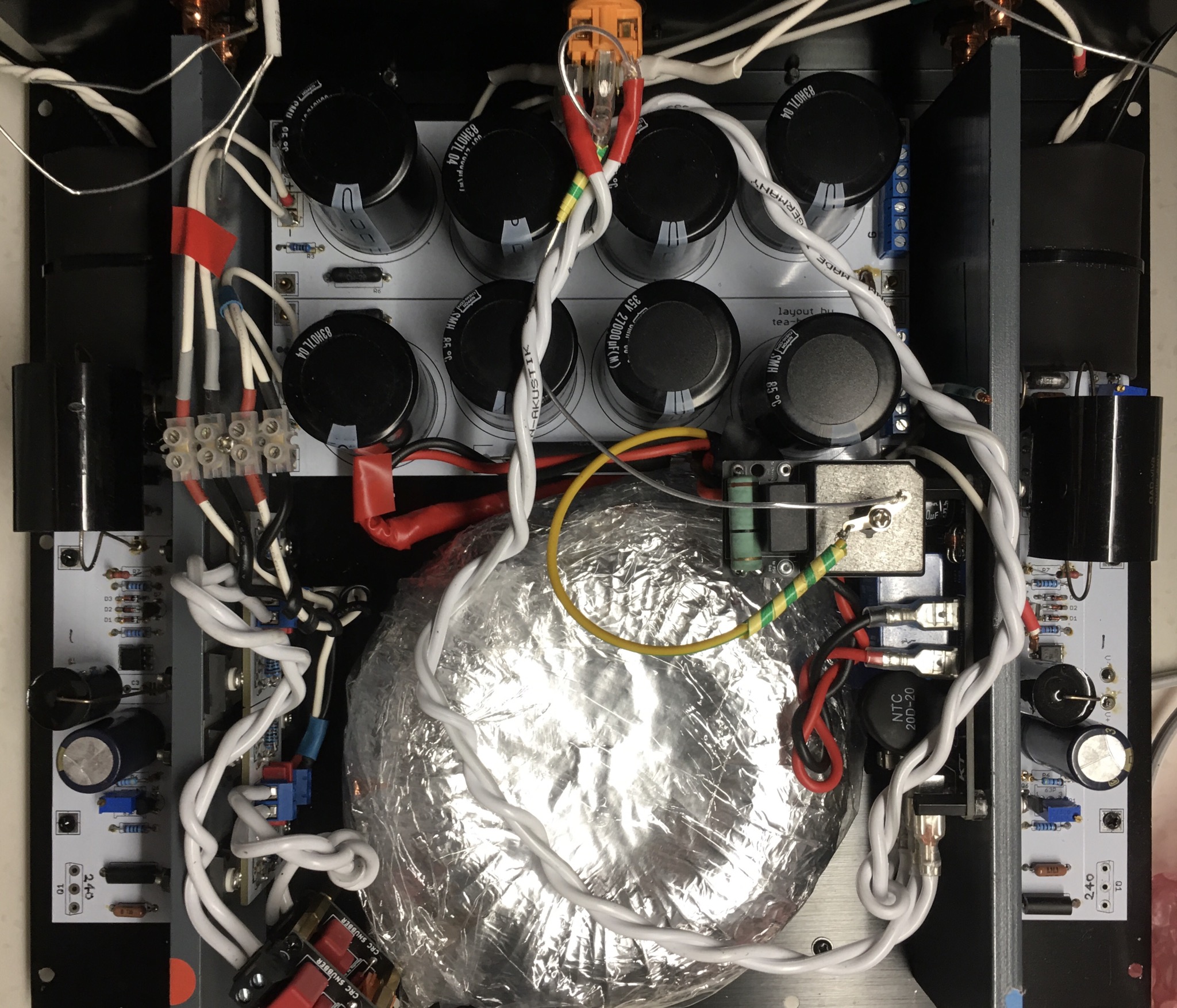

I am making myself a third M2 that having a more clean layout.
Because i dont have a good skill in wire management, so I sandwiched left, right, CRC, bridge rectifier, rca, banana into one board. And I am a happy kid now.
If any of you need the gerber files, I am happy enough to share here.

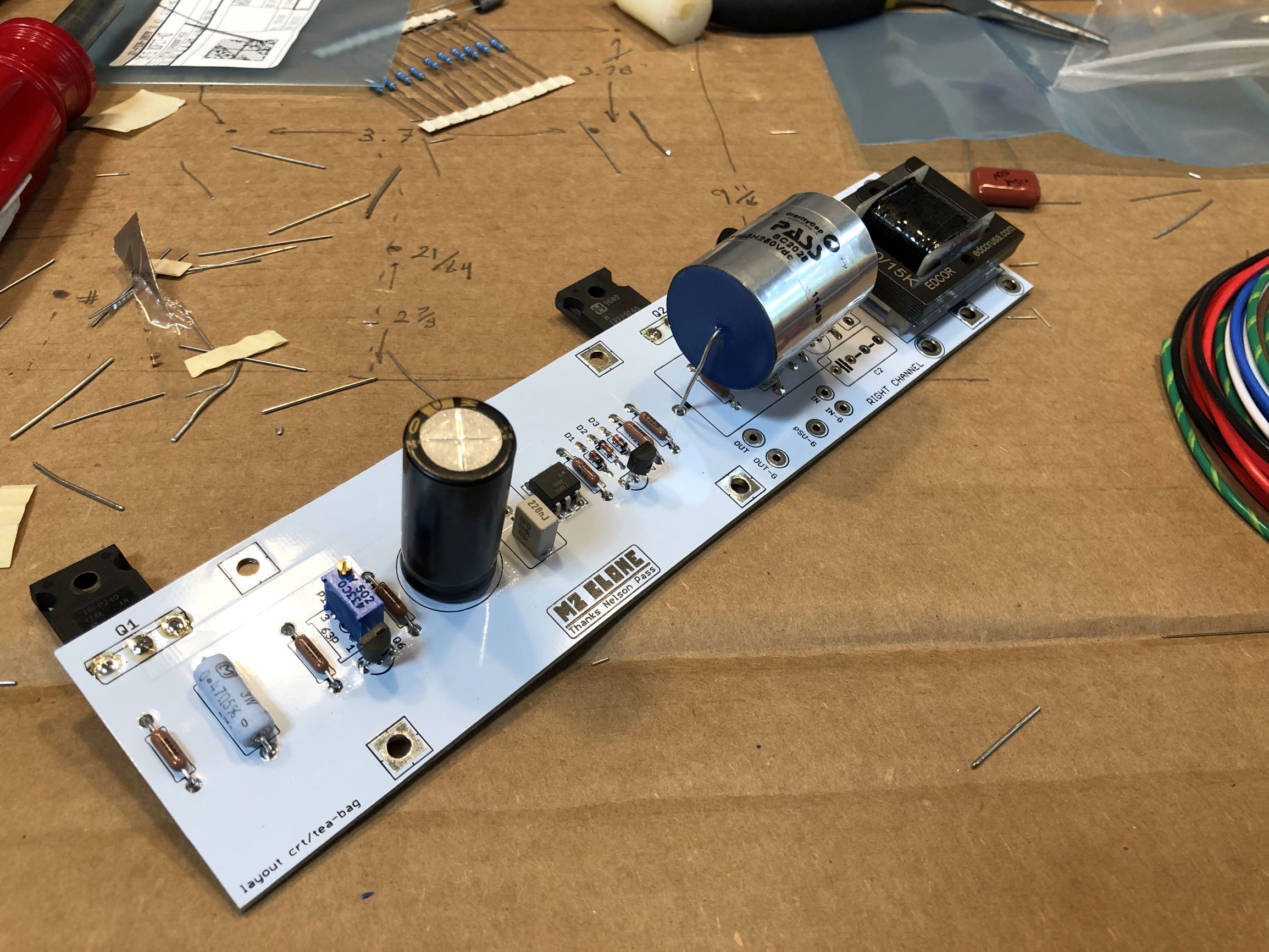

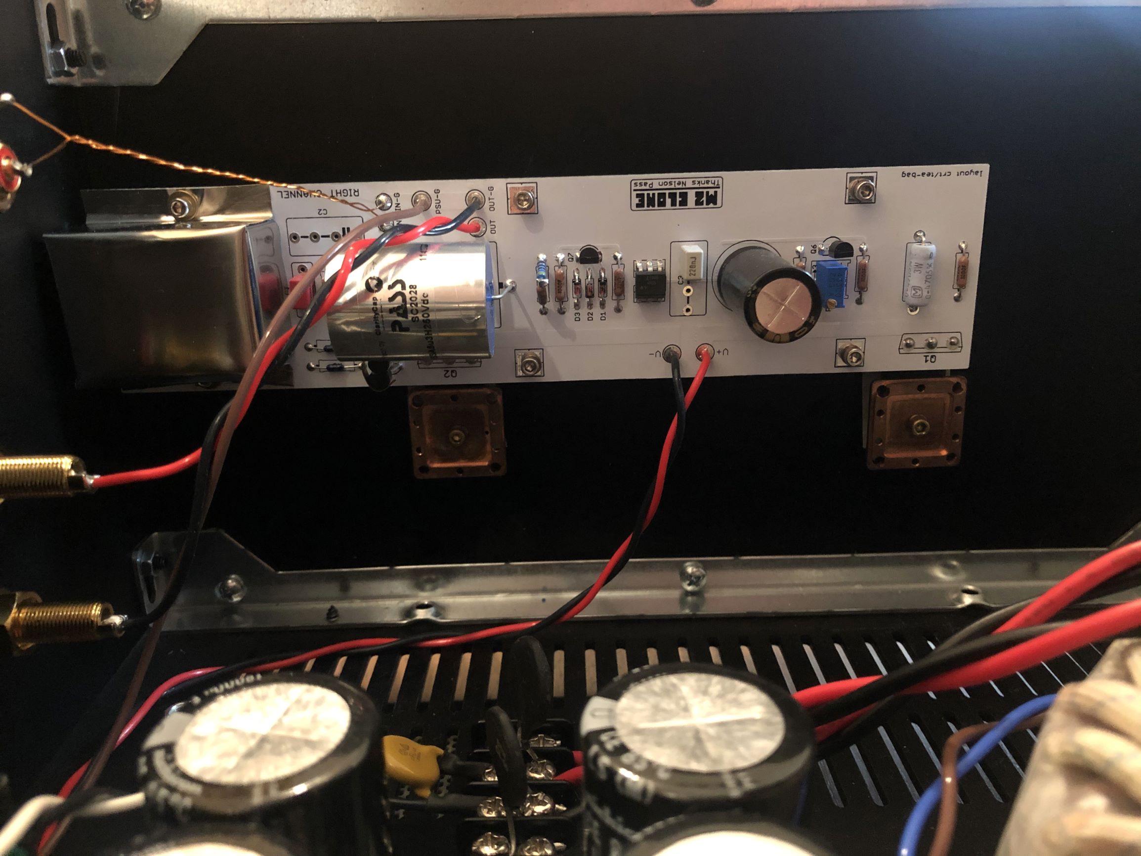

So I thought I should finally get around to posting about my M2 build. Huge thanks to Jim (6L6) for sending me a bunch of free parts (including those sweet PASS branded caps), and kickstarting this project. Also to TeaBag for the nice PCBs, which I also got from Jim's stash.
I'd done a bit of refurbishing work, like recapping the MAC1700 in the last photo, but this was my first "from-scratch" build. Also, electronics is a sizeable part of my work, so I didn't go into this completely clueless. In fact, I have some PCB designs for this amp mostly done, but I never pulled the trigger because of $$ (thanks again Jim for getting me started).
This ended up being a pretty vanilla build. I had hoped to build my own chassis, but that was going to be a huge amount of work for my first build... and not cheaper than the diyaudiostore/HiFi2000 chassis. I'm really happy with how it turned out though. Maybe one of these days I'll install some LEDs or a power switch on the front panel.
The transformer is from Antek. I started out with their 500VA trafo (because that's what they had in stock at the time), but the hum through my speakers was significant. If I held it outside the chassis as far away as the leads would allow, the hum became inaudible. I eventually got one of Antek's 400VA trafos with the static shield, and the hum improved quite a bit. It's definitely still present, but it doesn't interfere at listening distances. The mu metal shields around the input transformers don't seem to make much audible difference.
PS: +23.15V, -23.12V
DC Offset: <0.5mV on both channels
Input FETs have a high Idss (11.1mA) so I used 15R resistors for R3 and R4. They are operating at ~7.6mA bias and 54.5 deg C, which is good if a bit on the toasty side.

The sound is truly amazing. I can't believe how much music this amp pulls out of those relatively cheap speakers. I could listen all day.

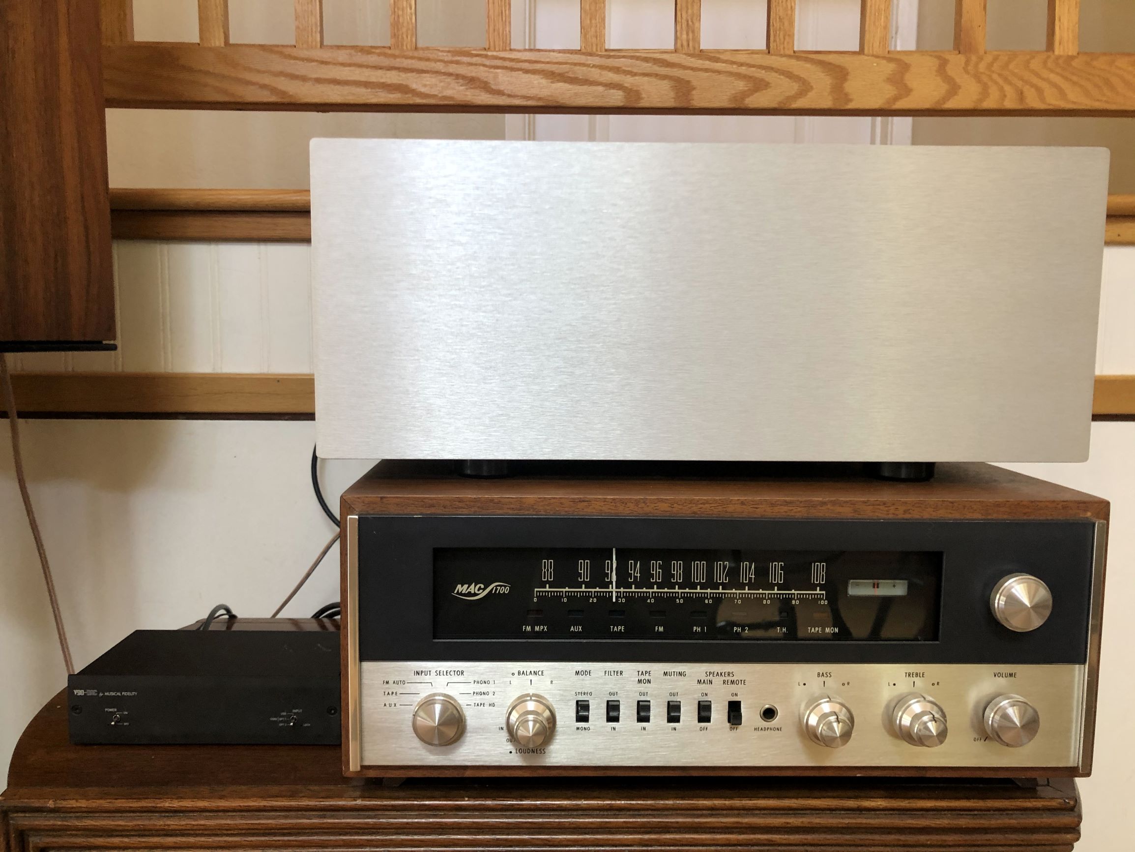

Have you tried measuring the AC noise at the output with input shorted?
The spec for M2 has that at 500uV but the measurements I've seen
seems to be somewhat less than that.
Dennis
Congratulations on your first build.
It looks very clean. I do have a few suggestions regarding the hum.
Try rotating the power transformer. My experience with Antek transformers is that it makes a difference. I have found that the best position is when the wire entry and exit points are aligned towards the front and back of the case.
Twist the power supply ground wire together with the V+ and V- all the way to the board V+ and V- connection, then continue the ground wire to the ground connection point.
Route the AC wires from the back of the case under the power supply board to the front of the case and provide connection to the transformer there. Move the rectifiers to between the transformer and power supply board.
Move the amplifier from the MAC1700. Perhaps the MAC1700 transformer is too close to the amplifier.
Here is something by diyAudio member Bonsai that has good information:
http://hifisonix.com/wordpress/wp-content/uploads/2019/02/Ground-Loops.pdf
Practical advice is towards the end of the article.

Thanks for the suggestions. There are a few new things I could try with regard to internal wiring. I did think of the proximity to the MAC1700, and it (surprisingly?) doesn't seem to make an audible difference. I think I have the Transformer rotated optimally. I could try putting it on it's side.
Really the thing that makes the all hum go away is more distance between the Transformer and everything else, but I'm confined to the chassis.
That said, I plugged it into my brother's JBL L100's, and they were silent with my ear right next to the drivers. Maybe it's because they are 8Ohm instead of 4? Or maybe there's something about the way everything was plugged into power?
Constant tinkering is the name of the game. I'm still loving this amp.

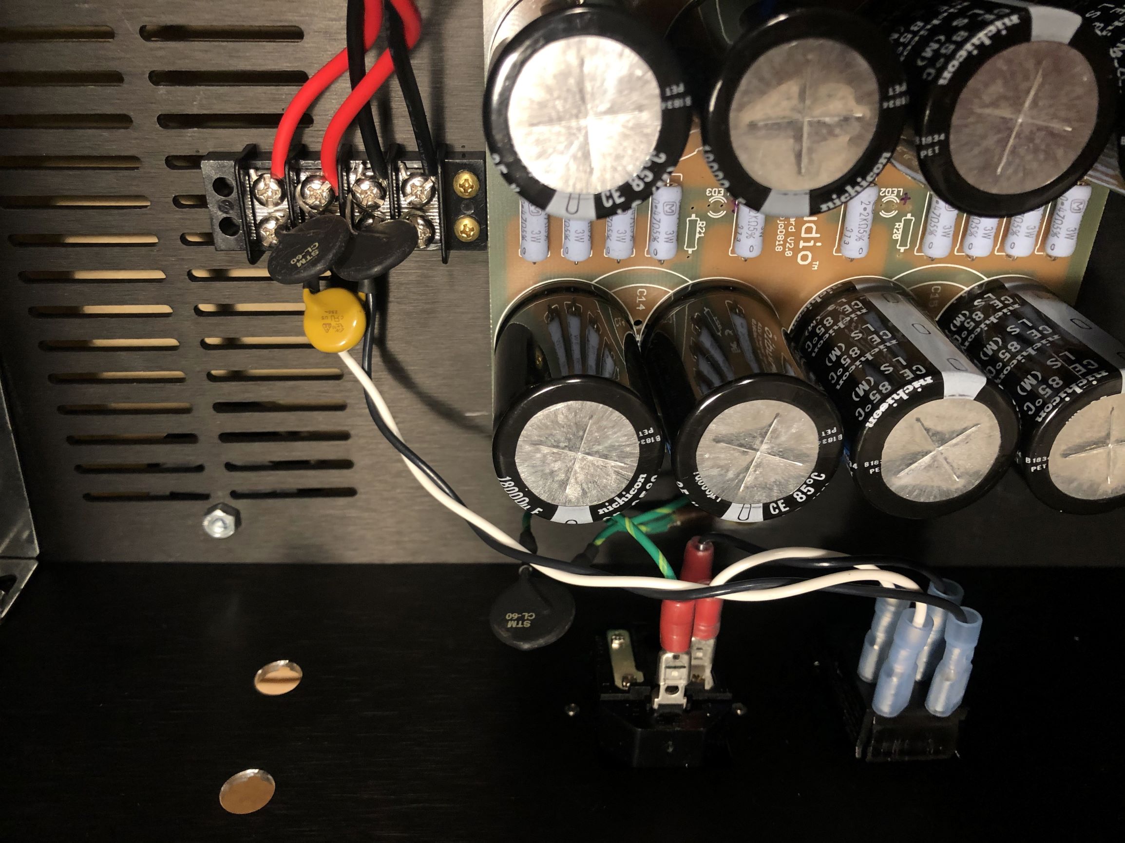

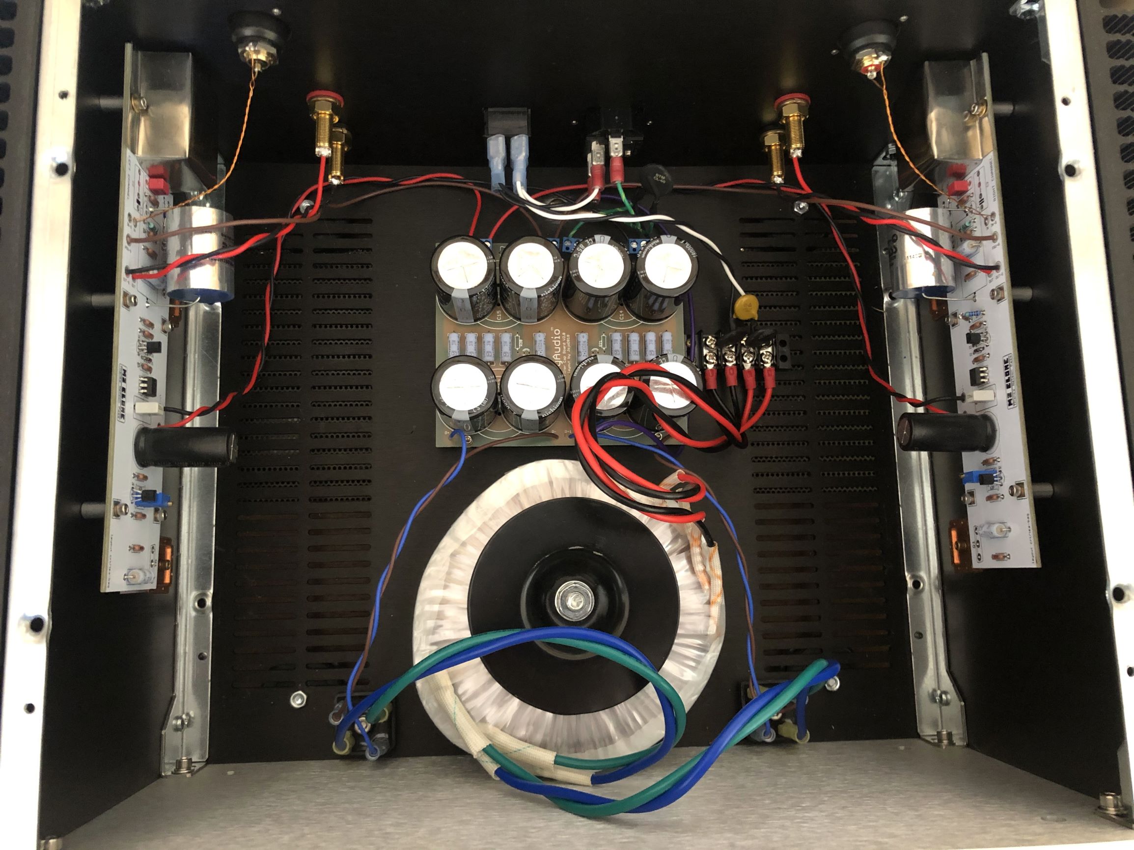

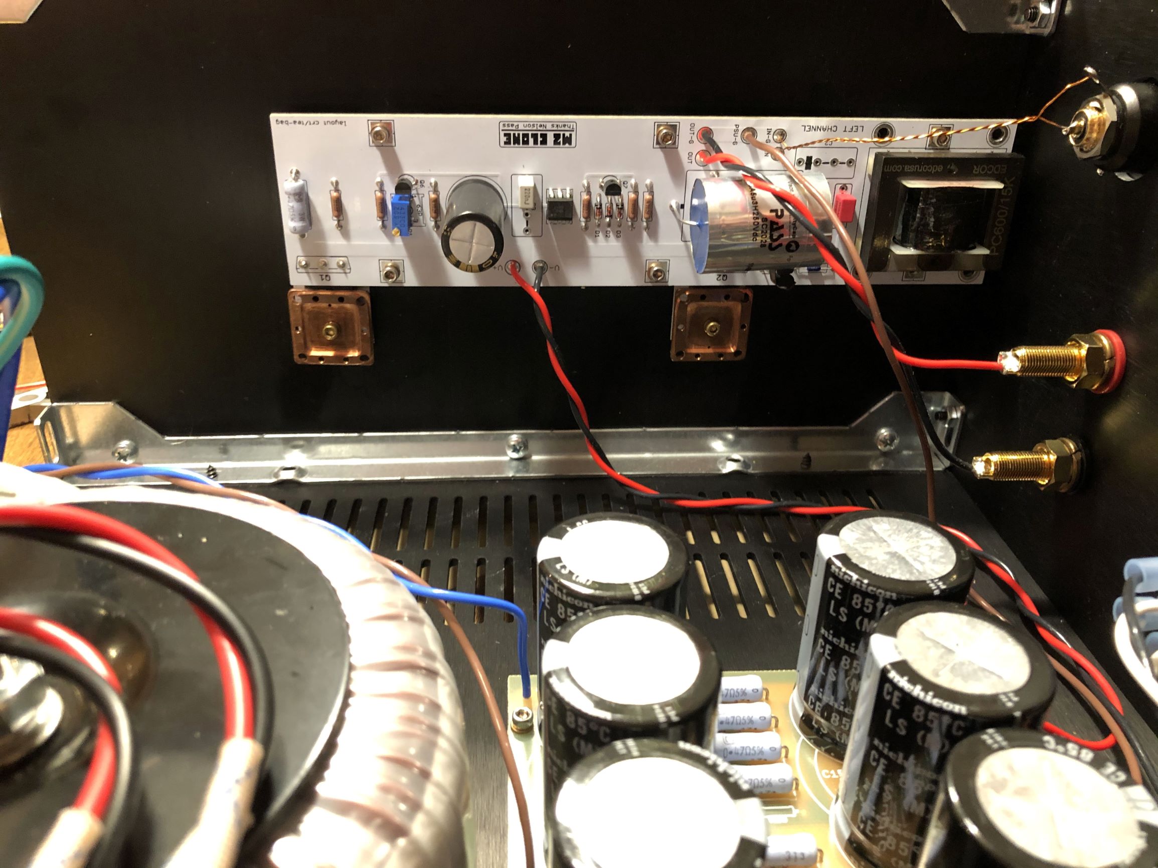

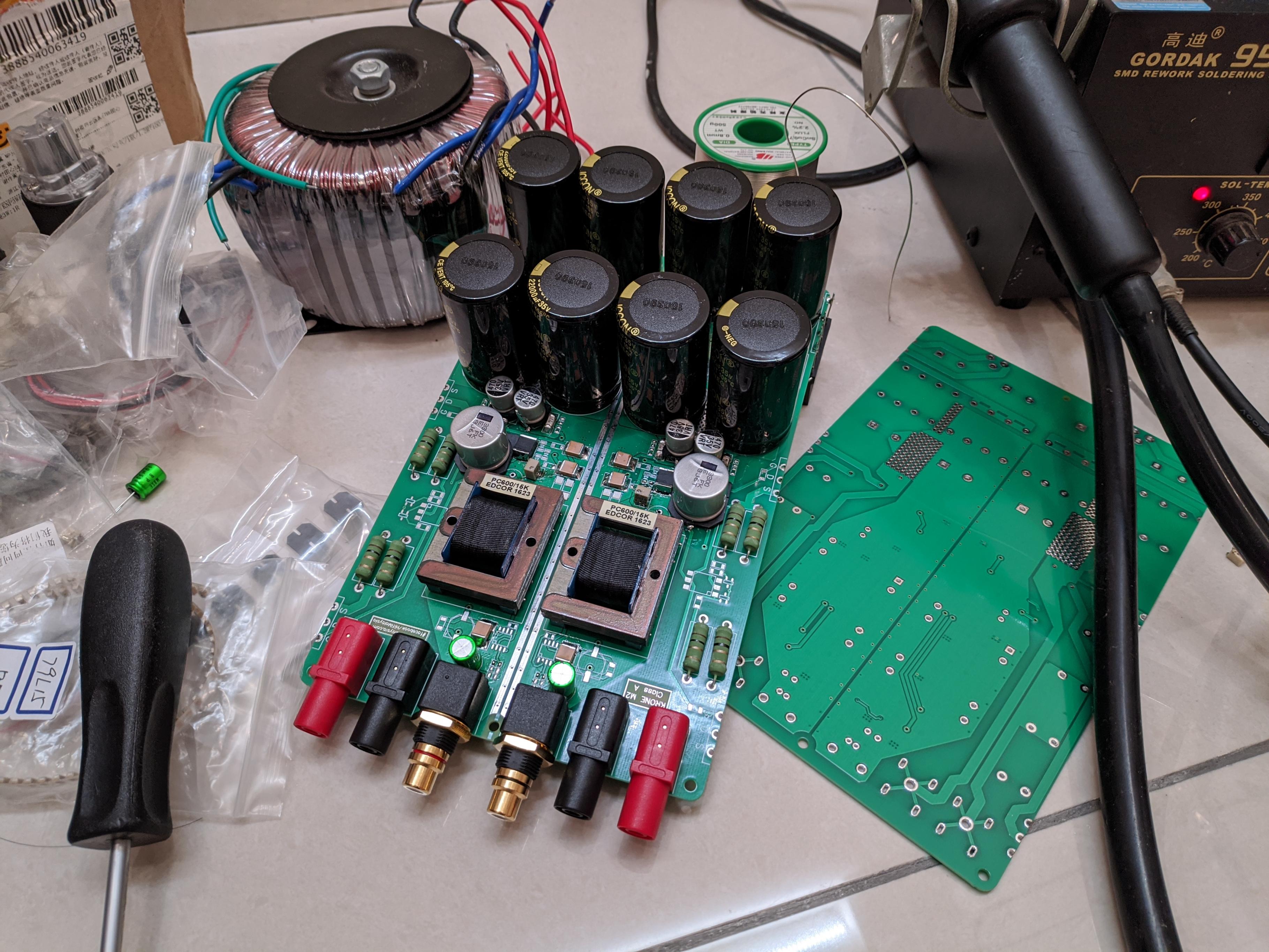

Hi all,
2 years after receiving all the pcbs and parts, I finally finished my M2.
Two problems:
The case (120mm tall) maybe too small to house the boiling mosfets. I will have to get a 200mm tall heat sink case.
The second problem: left channel has hum noise and volume is only half that of the right channel.
Right channel functions normally and sounds gorgeous. No hum.
Also the Problematic left side is 5C cooler than the right channel which is about 50C.
Where should I start to troubleshoot? Would it be cold solder?
(Photo shows M2 in progress)
