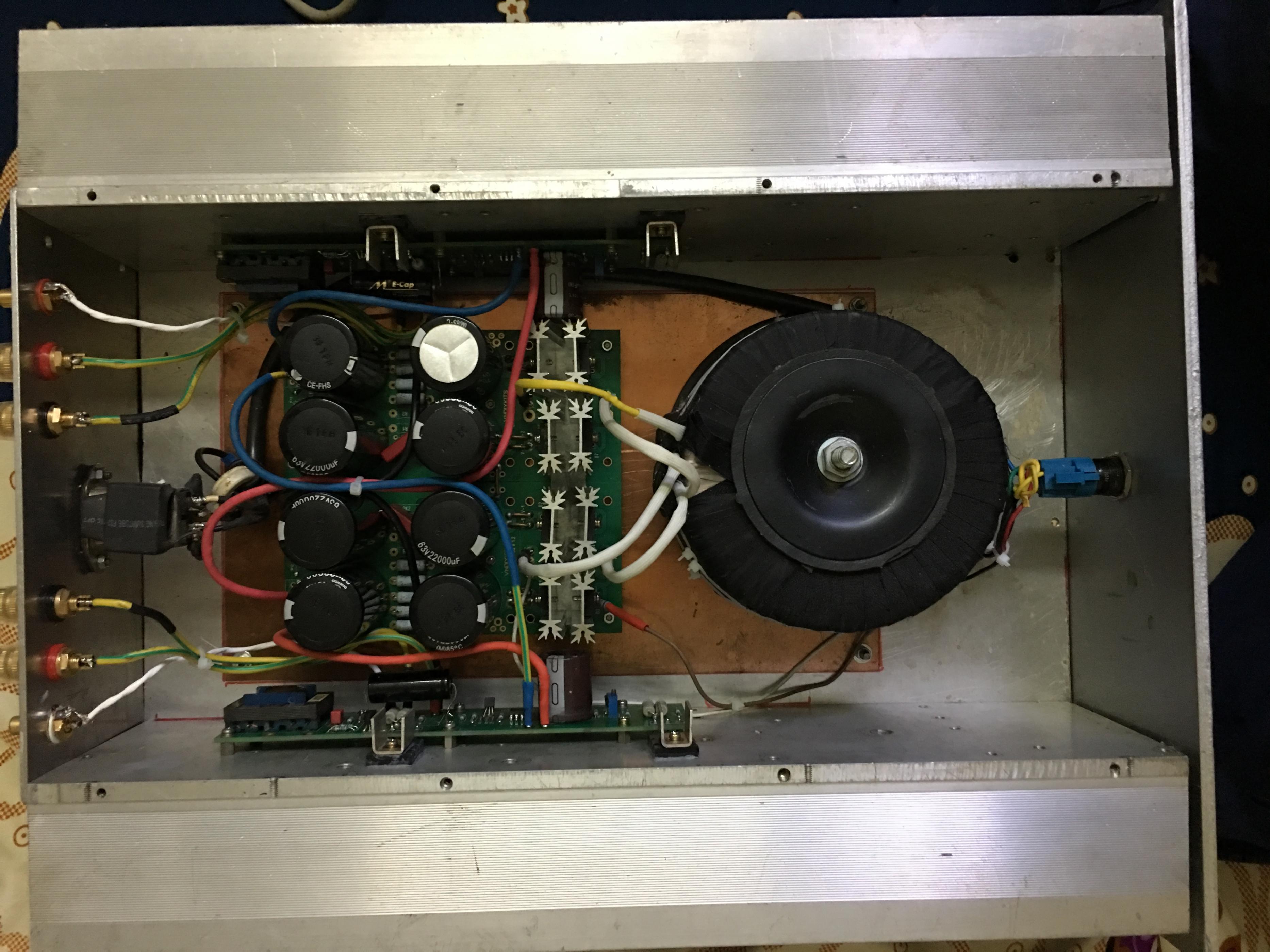

I've nearly finished this amp (only front and lid remaining). It sounds great! 😛
Thank you Papa for making it available (and Tea-Bag for making the job easy for me providing the PCBs and Edcors).

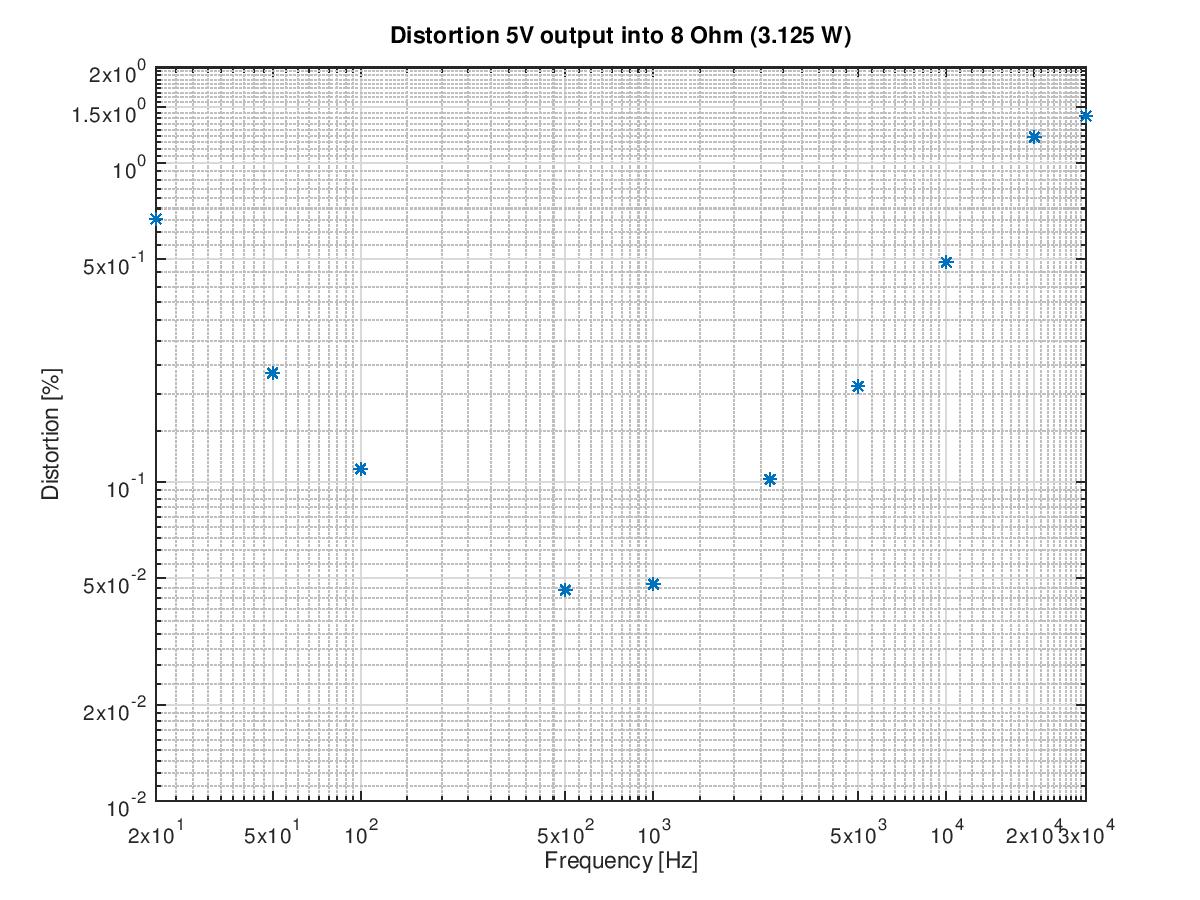

Just for fun, below is the distortion when providing 5V into 8 Ohms. Only left channel shown but the two channels are remarkably alike.
It will not be my last DIY power amp 😀.
I used an HP8903B audio analyzer: File:HP8903B audio analyzer.jpg - Wikipedia
Clipping 1% distortion at 1kHz into 8Ohm is at 2.95V input level for my amp, Nelson states 3V, so close enough in that respect.
The slightly above 1% distortion at 20kHz and >3 watts shouldn't alarm anyone. If you dissipate that power level at 20kHz in any speaker I can think of, at least I have left the room.
With the M2 clone, I hear details of my recordings i didn't hear before, served in a very pleasant way.

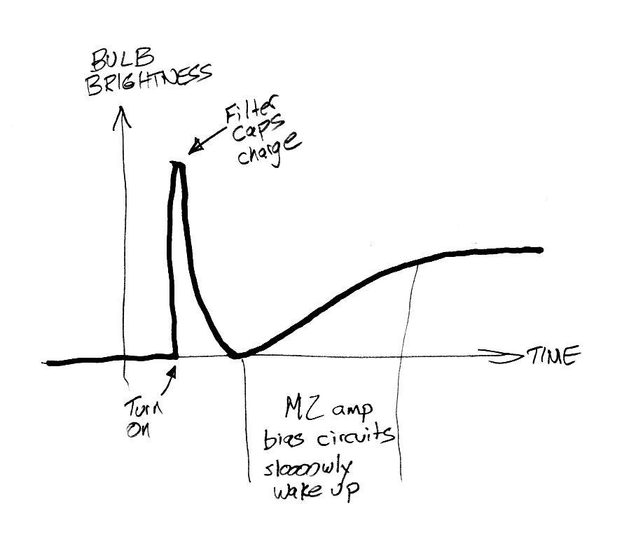

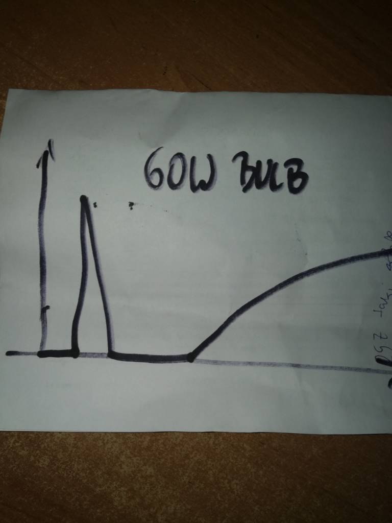

Unfortunately. I turn on and there is a short flash of light bulb then nothing for a while. Then slowly brightens and at the same time the supply voltage drops and increases voltage through R13 / R14. It stabilizes to around 0.48V but the bulb stays on.
My M2x draws 125 watts from the AC mains. That's the "equilibrium" value after turn-on and warmup, 5 minutes after flipping the power switch. I measured that number using a cheap "Kill A Watt" meter I bought from Amazon for $21.
That's enough current to light the bulb of my dim-bulb tester. So, in equilibrium, the dim bulb tester is not dark. It is lit.

the behaviour you describe is exactly what we expect from an M2, as Mark, Jeff and 6L6 already wrote. I would go ahead with Zen Mod's suggestion of starting the amp channel without light bulb tester, but with the multimeters connected as Zen Mod described.

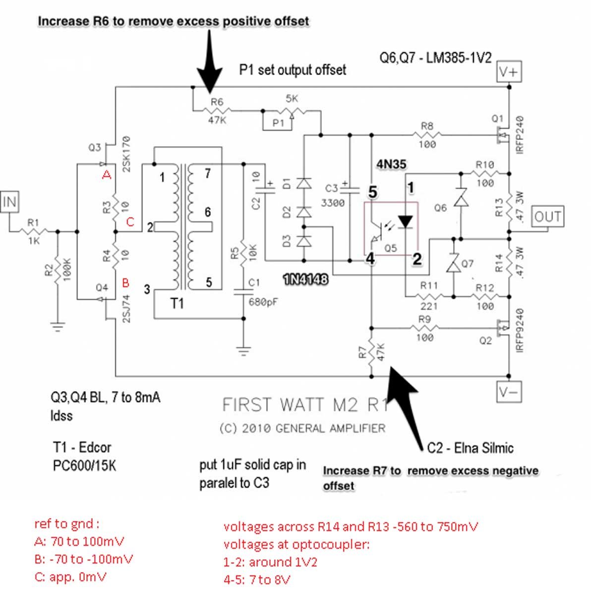

This is my first such a big diy project and thank you all very much for help. The good news is that both channels seem to work well. Bad , that I unfortunately damaged 1pcs sj74 and maybe sk170. It hurts.... I measured the values ​​according to those in the attached drawing point(I don't have high quality DMM):
A = 78.5 / 78.7 mV
B = -75.5 / -69.5 mV
C = 3.4 / 4mV
Voltages through R13 / 14 are 0.610V offset was successfully set to 0
Voltages on opto legs:
1-2 = 1V
4-5 = 9.5V
Voltages on rail +/- 22V .
It takes 50 seconds from turning on until the current begins to flow by R14 / R13. Is there anything else I should check? If not, I can already collect money for chassis from modushop [emoji846]tapatalk_1567361535745.jpg
